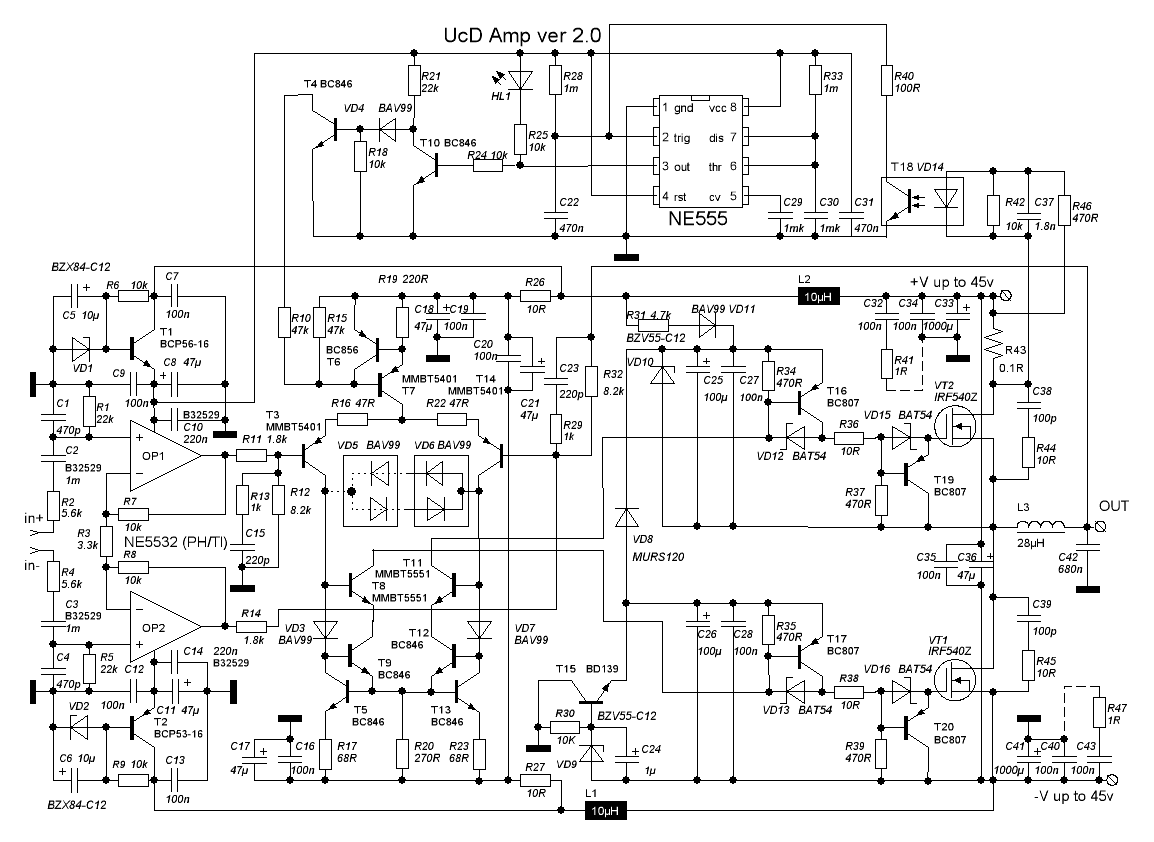

hi guys yes there is small noise even after adding 4.7 nf to lm311 pin 3 and grounding .but the simplicity of the amp and the power it produces that is a trade of i am o.k with . but if it is a bother then guys let us think of adding a different feed back design. e.g. the scheme below is a discreet ucd except the input op amp . i tried the amp with non smd that is 2n5401 and 2n5551 and made it on a strip board. when i grounded the negative side of input, the amp was dead silent. i tend to think the feed back design is better than the one we are using. stewin

I've built some UcD based amplifiers, and many other ClassD amp, and a few of them produced noise (interference) when I connected to PC, but I was always able to eliminate it. The main reason was not proper grounding system.

Sorry, the last time I experienced this issue was a couple of years ago, I don't remember the details. By groundig system I mean both internal ground plane and external one, common mode filters, EMI shields, etc... Anything can be wrong, but if you don't have a clean GND, then it's almost impossible to measure, and not easy to filter the disturbance.
I have a friend who made a noise-free ClassD amp on single-layer PCB, but it took many experiments. I use double layer PCB with ground layer and SMD, and I have no such problems, but these things alone are not enough for good result.
what class D or UCD amps have you built so far which is working without noise??
UcD with many kind of level shifter+gate driver, pre-filter phase-shift oscillating type, fixed freq PWM with post- or pre-filter feedback, BCA topology, Class BD modulation, almost everything wich is analog. Noise is not unavoidable in any method/topology. It's because of realisation.
and give us a clear and right thing to eliminate noise of this UCD amp.. finally thats what we all need..
I can't, and I don't want to do this. This is your task. All I want to say is: this is possible, and the cause of the problem is not UcD topology.
I could eliminate the noise personally, but not through the internet. It requires seeing the complete arrangement, hearing the noise, maybe measuring some waveform with a good oscilloscope, and some experiments.
You can try changing switch freq, but this is only symptomatic treatment!
To determine the disturbing signal's penetration point the most important test is shorting the input. Depending on the result you can continue inspection in different ways.
I didn't tell the trueth: I solved a similar problem a month ago, but it was different, more difficult: 2 amplifiers + center tapped push-pull PWM power supply, heat-sinks attached to metal case, plus ground loop. There were 4 different kinds of noise, and all of them needed a different solution. And 3 of the noises introduced with the improper housing.

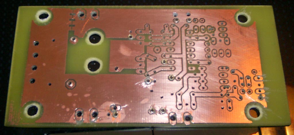

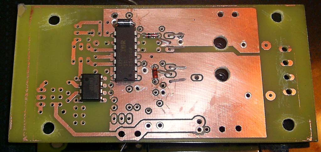

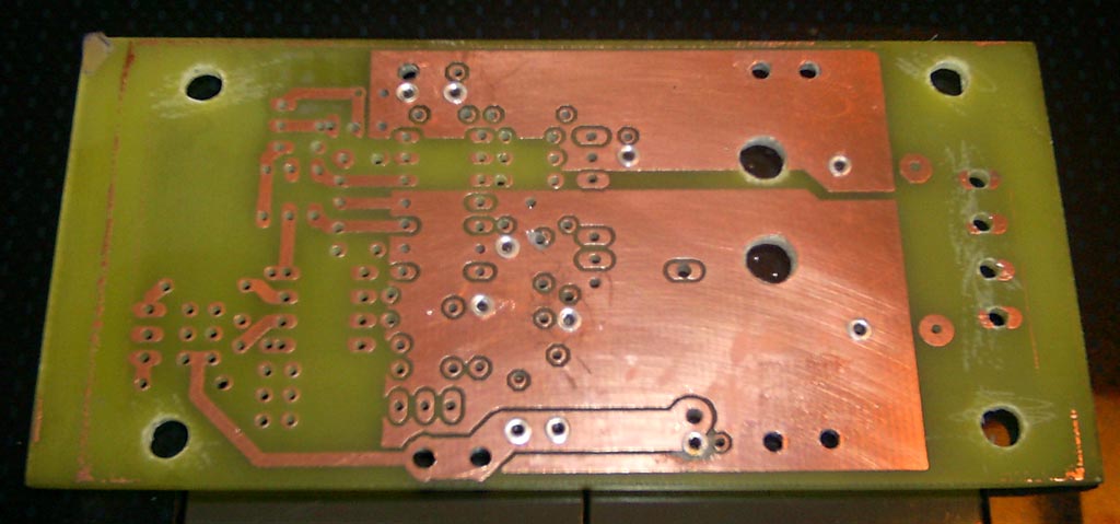

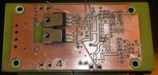

So heres my board after etching:
With a few components in place:
Now im waiting for some components i had to order before i can warm up the soldering station.
