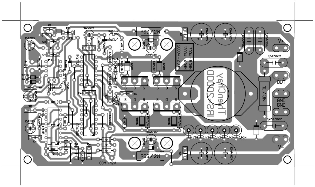

Something VERY bad is happening there:(.I didn't have this problems even on test board.Post board layout.:scratch:
adjustments were made as said by thienchay
Yes,those capacitors,they should be very close to output transistors.And ground is very bad,it has loops and and is it long and thin.You can somewhat fix this by using a ground plane on the other side conectata in 10 points butthe capacitors have to be moved.

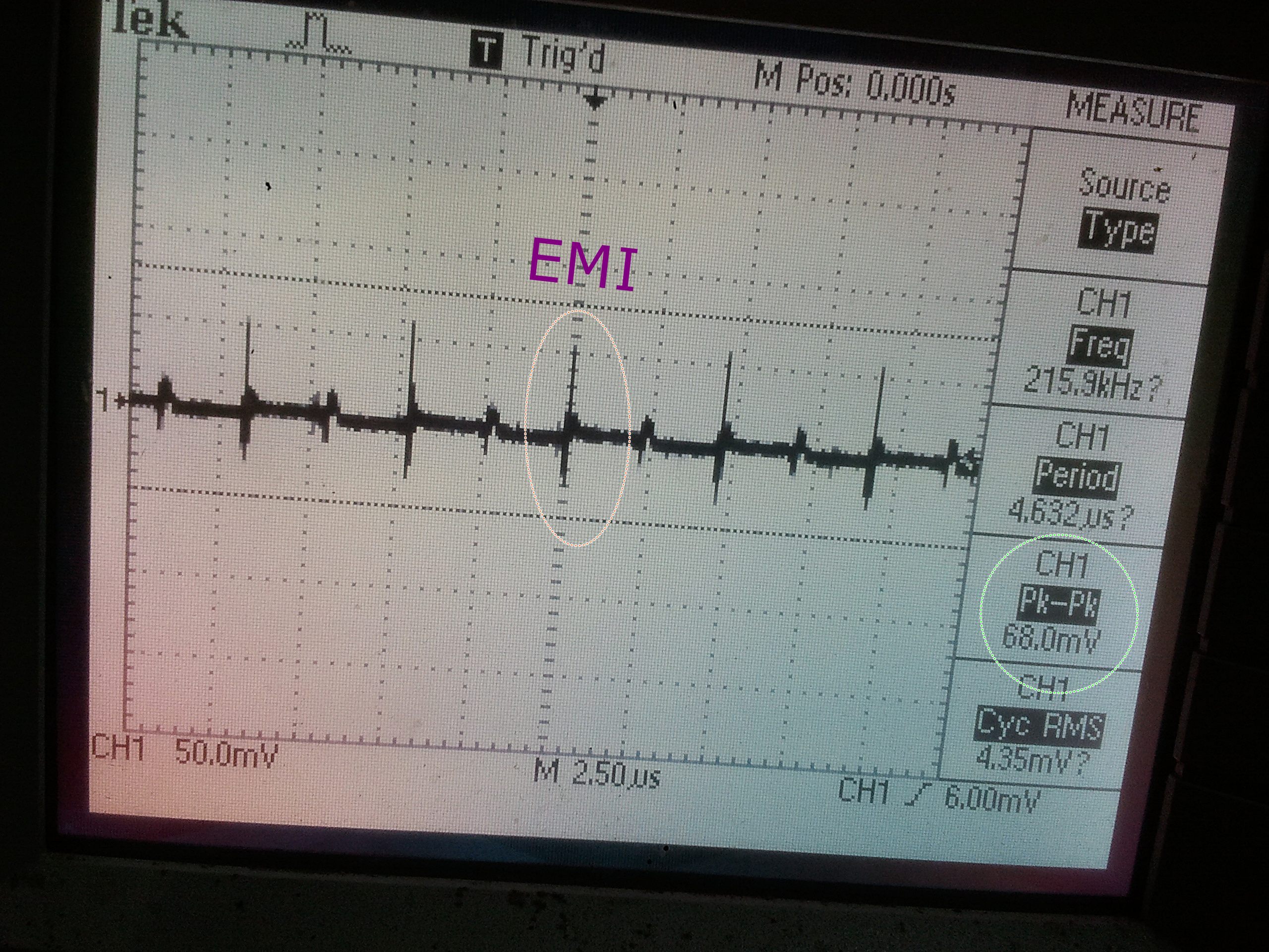

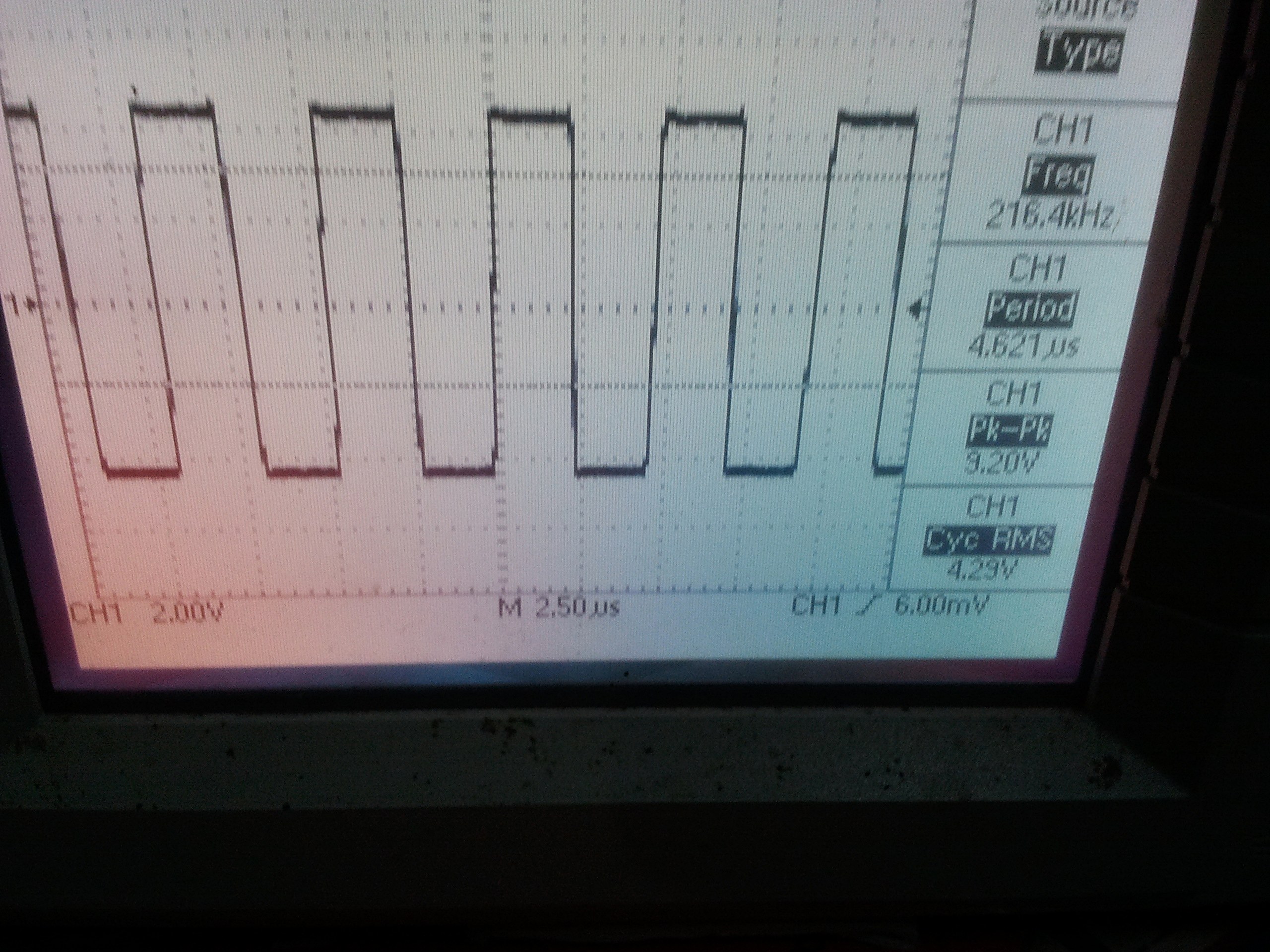

can this be the cause for my problem....even with no loads...i got distorted square wave...if i would have got distorted sine wave i would have said there is ground problem...i used 33uh coil and 0.47uf cap for output filtering
