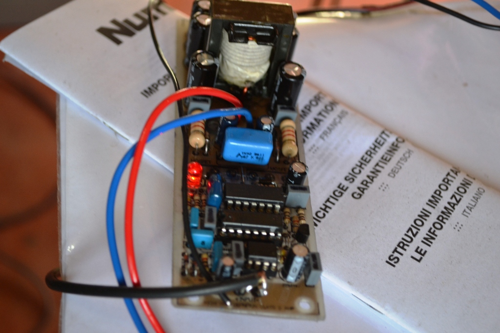

i managed to make this thing work but dint get any much success......on low volume it works as clean as a headphone does but when increase volume there is a distortion in the speakers...like someone is tearing papers......help me out with this issue??????
I think your output filter not good or not matched (saturated) with current freq.. pls provide your schematic
RGDS
MANOJ
can you post some photo so we can see what, where is the problem
top and bottom

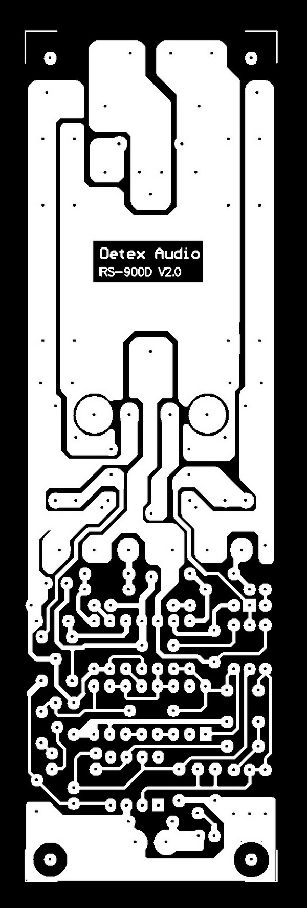

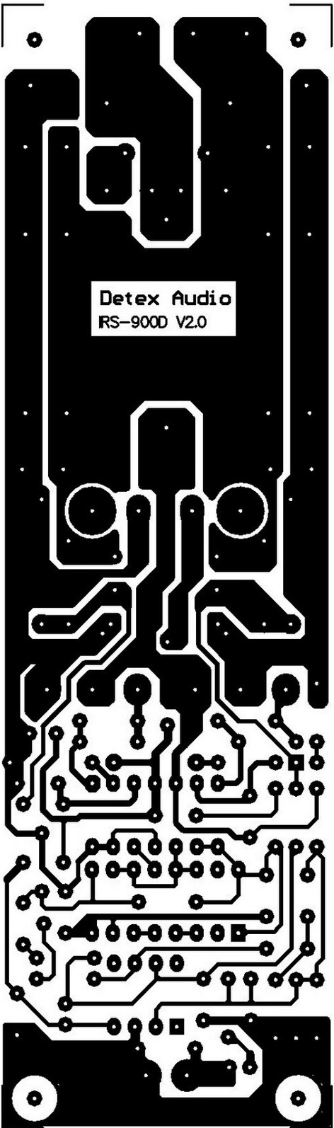

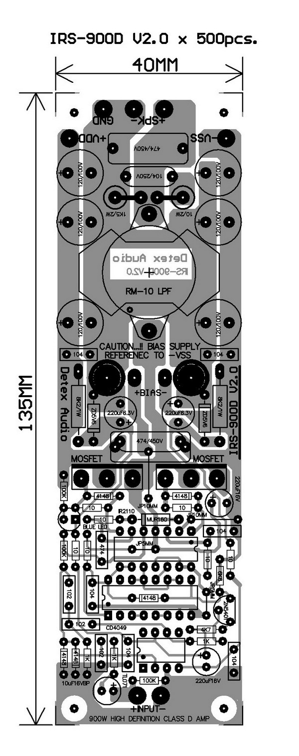

haven't built the pcb yet. i was contemplating to either redraw the schematic and include the 12v aux supply and a dc protection or just etch the pcb provided by thienchay at post #2101 & #2102.

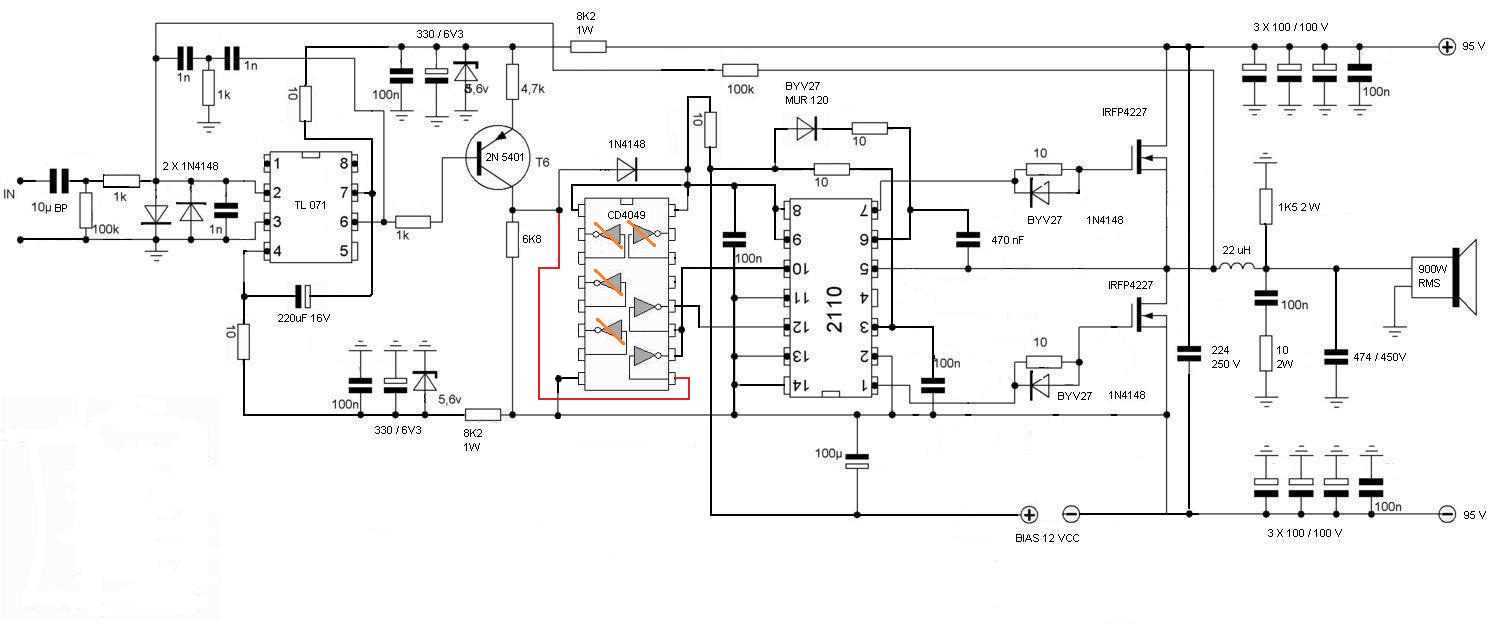

seeing how simple it is i redraw the schematics when i see the pinout of the cd4049 is different compared to the pinout used in cheshta's and thienchay's pcb. so i was wondering if anyone have etched and built the irs900 using cheshta or thienchay's pcb.
here's the original schematic of the irs-900d posted by cheshta:
together with the cd4049 pinout from his post:
a remake of the pcb from thienchay:
and he's the pinout from cd4049 datasheet:
pin 7 and 8 shouldn't be shorted together and some other error. or am i reading it wrong somewhere?
would really love to hear any feedback from people who have built the irs900.

I apologize because i'm did not checking carefully schematic of Detex .
I think they deliberately show ​​the wrong schematic :scratch: , but given right PCB .
And i recheck it , they just used 2 NOT gate of CD4049 on their PCB , and it is right , orther NOT Gate is not used :) .
This is the schematic i redraw .
thanks guys!
that's all that i needed to hear. the schematic is indeed with error. now that i have you guys that have built a working pcb i know not to follow the schematic and build the amp according to the posted pcb.
