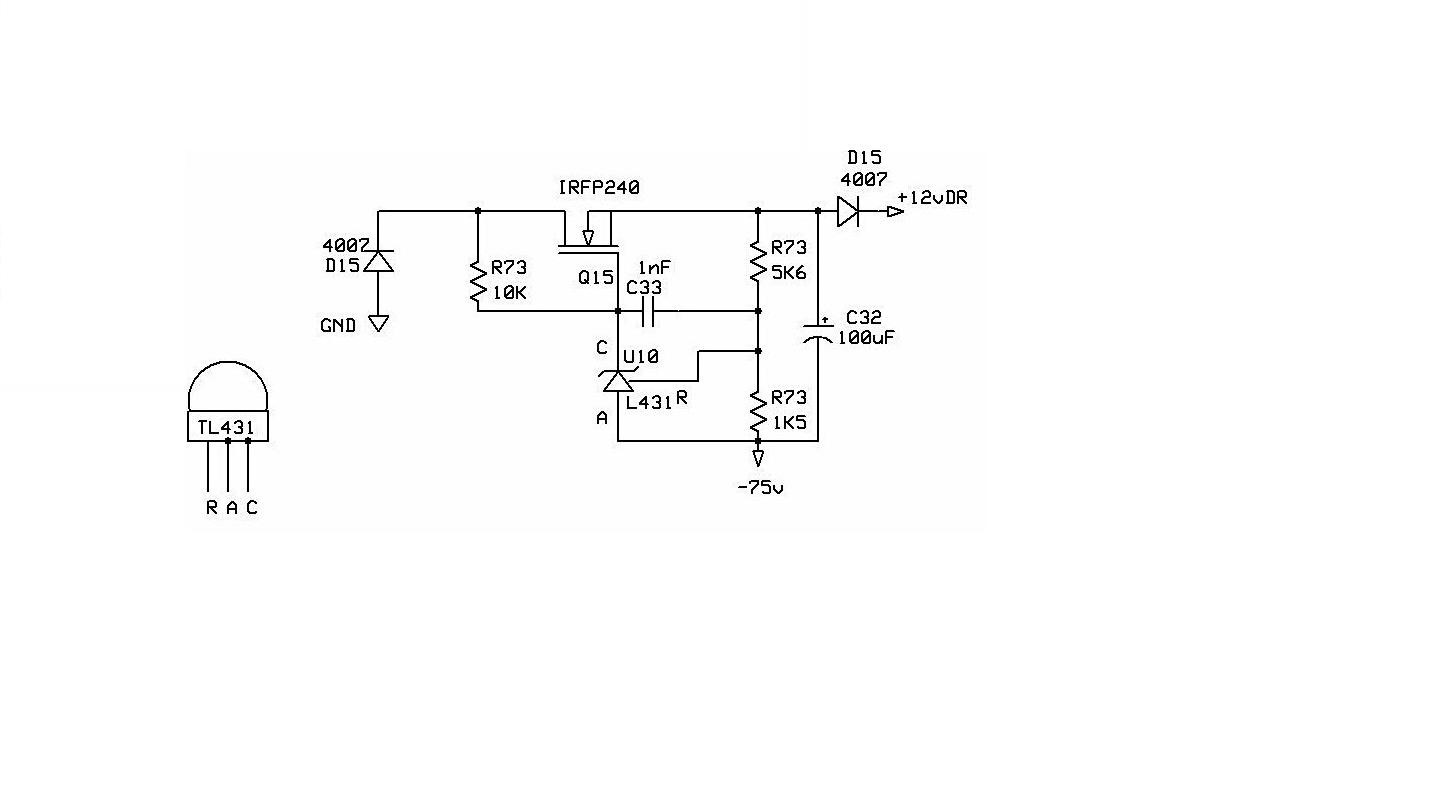

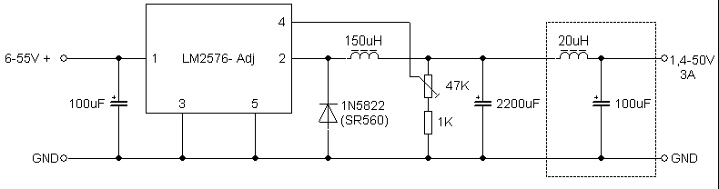

hi manojtm thanks for a wonderful circuit. i once replaced the tip 41 with irf740 fet and it was cool and dropped 2voltages e.g when you want 12volts you needed a 15volts zeener diode . but now thanks for this standard version i will implement it on my aux voltages for class d applications.

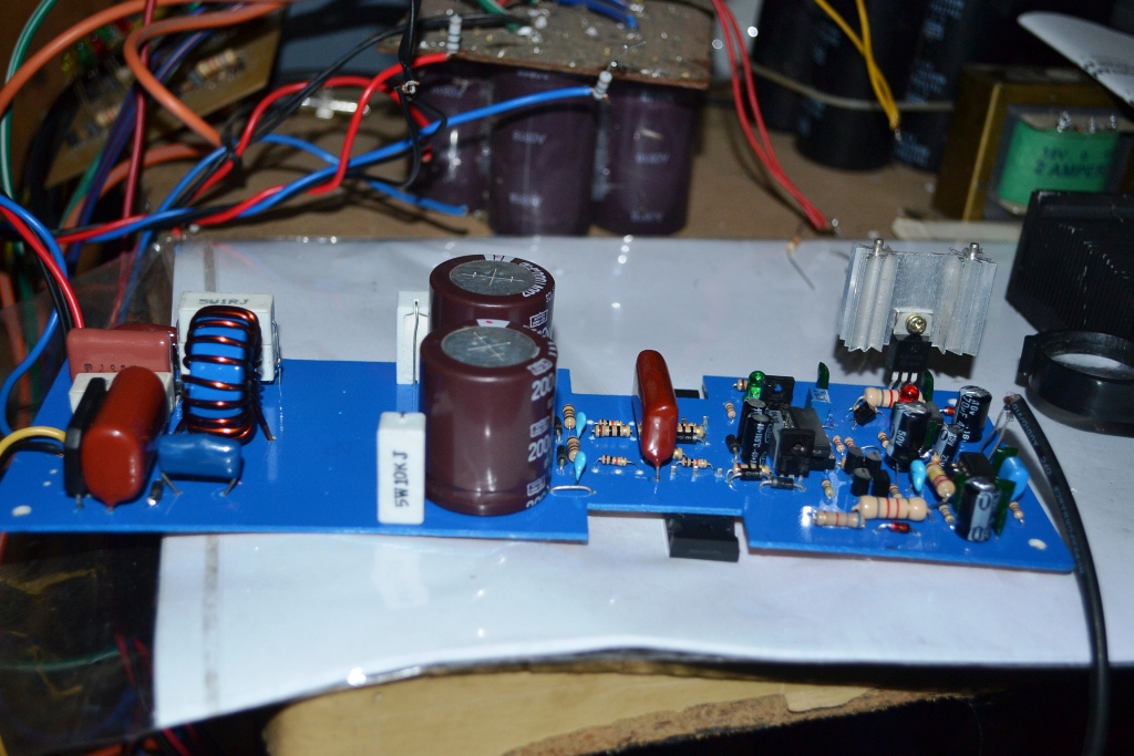

triell test 2 r load 1 pair no sink 75-/+ negative side early clips hehehe
triell 3.2k test 100hz sine wave like gun shot LOL 2 r load 75vdc - YouTube
music test
triell3.2k audio test 2r load no sink 1 pair 75+/- - YouTube

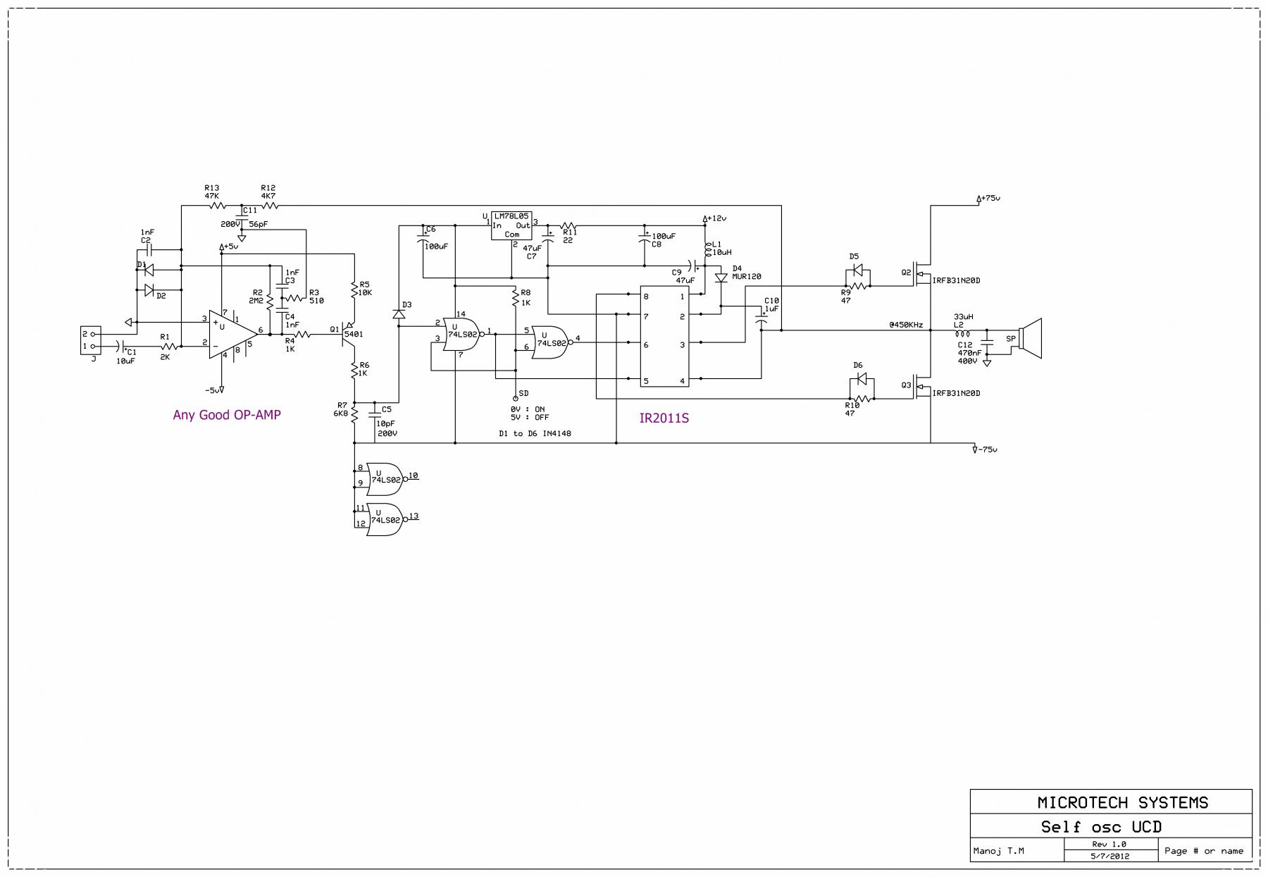

my old design simple op-amp self osc. 450KHz 400W IR2011 & 7402(credit goes to IRaudio) now it is IR2110 CD4049 TL071
diysmps
again thank you for modifying my schematic
RGDS
MANOJ

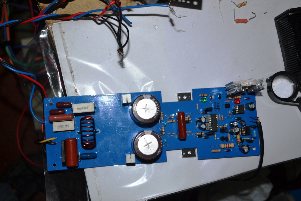

music test

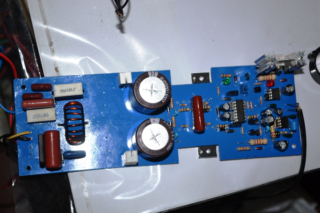

wow irvy very impressive are you using irfp250 and ir2110?
after watching the video i am very impressed at +/-75volts no heat sink and 2ohm load pls post schematic.
1 pair IRFP90N20D
for information this amp is similar to UDC by jetagle with modifacation it has hissing sound even volume is off adding volume on input is not recommended high freq will be gone unless its full gain,, with 2 pairs 90N20 LOL ir2110 temperature raises and not good driver to be stress out and protection is working good but need to be adjust
Sound is fine and clear but compare clarity and details audio ill go for IRS900 hahhaha

This design based on a self oscillating type PWM modulator for the lowest component count.This topology is basically 2nd order sigma delta modulation,noise (error in audible freq.) range is shifted away into the upper freq. range
see IRAUDAMP1 rev.A notes

TRI-L CORRECTED SCHEMATIC
thanks EXFLACO

clone corrected 220k no yes 22k capacitor 10n no yes 100n

Has anyone seen the performance of this amp with 20Khz input signals ?
its giving me problem when I Use 20Khz as input or mix 20Khz with 1Khz signal. the circuit stops oscillating.
