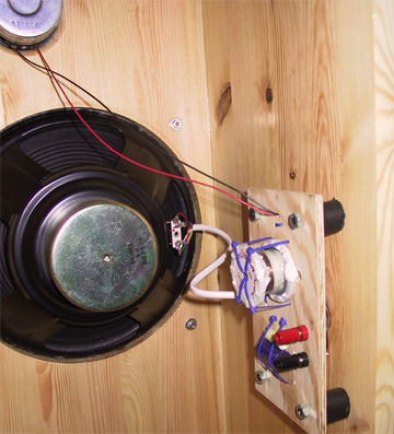

jag said:
Still playing (and having fun) with the crossover - will post details once finalized.
Well, the crossover ended up being a 6.5mH (0.85ohm) ferrite coil on woofer and 80uF cap on TB. As far as sound is concerned, all I can say is that I was not confident of achieving good sound at all (with my speaker building skills), but this has exceeded all my expectations - I guess the keep it simple approach paid off.
I can agree that the extension of the 871S is fine in the highs, compared to a tweeter system it sounds alot better than 4" FRs and larger that I've heard. One other driver I'd like to try is the FA69P805, maybe you've tried it RAW? I sent out an order for a couple (have to build a pair of speaker on the cheap for my girlfriend's parents) at $5.99 I couldn't go wrong at all, just wondering how they'll compare to the 871S that I've come to enjoy ALOT.
