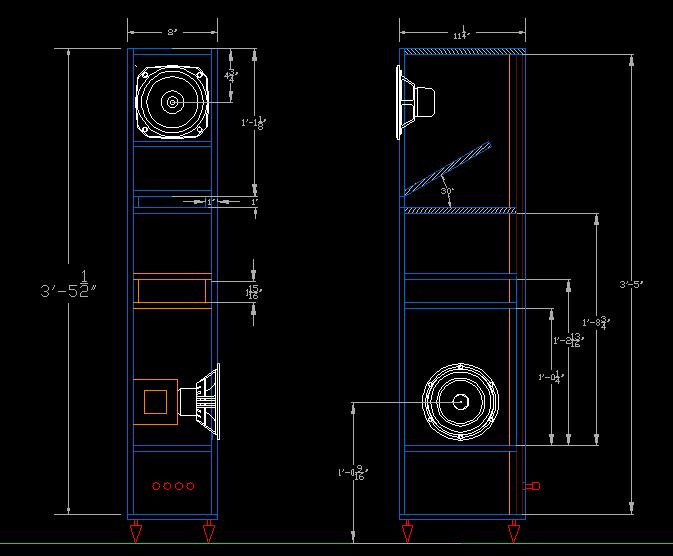

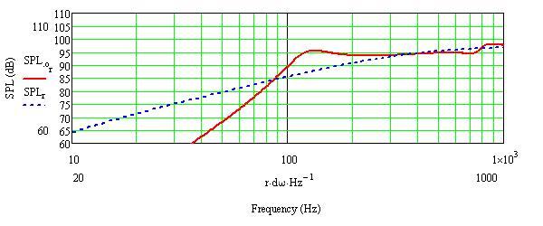

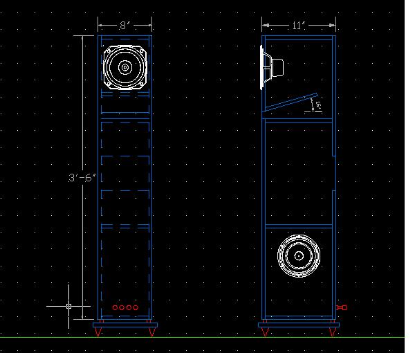

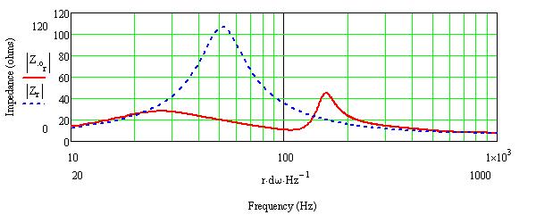

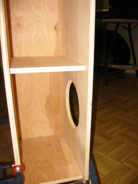

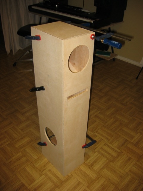

Latest Build
Thanks chris and dave.

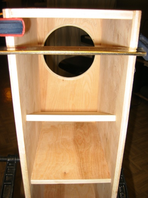

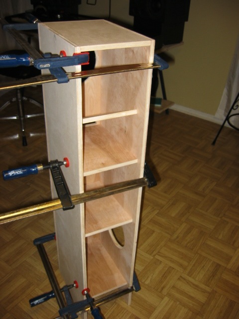

Here's the latest update:
- Sub woofer baffle is doubled to 1" total
- Construction is underway, top half is about done.
- I had a 45 chamfer bit in my kit, didn't realize that the bottom was a bearing, I thought this could only be used on a straight edge. duh.. Works great.
- Used T-nuts for the FE167E
Drawing shows about five shelves spaces. Volume starts at about 13L to about 22L

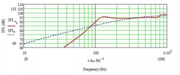

X/road
So, I've been living with these for awhile now, and they really sound great. However, there are probably some tweaks that can make them sound better.
Q: Which is preferred?
a) A BSC circuit
b) High Q HP filter for the FR
a) A passive circuit at the speaker, which can effect the speakers response (quoting Linkwitz)
b) A passive buffered circuit which has caps and/or coils in the signal path?
Q: What relationship exists between stiffer damping at the terminus and cone excursion?
