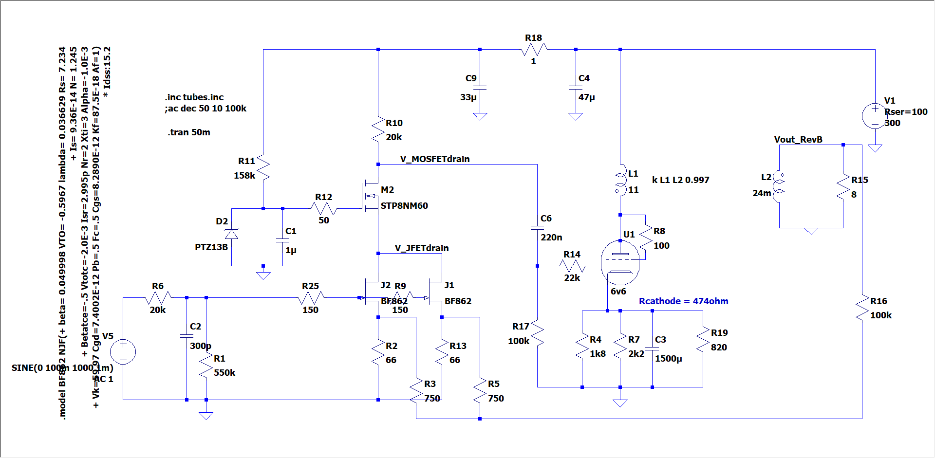

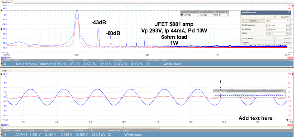

Get some KT-88's and bias the amp for those tubes and you will be pleasantly surprised at what you hear. I am really enjoying some reasonably priced JJ KT-88's.Indeed I like what I am hearing (triode no feedback for now). Third harmonic is below 0.05% at 1W and it is 20 dB further down with EL34.
