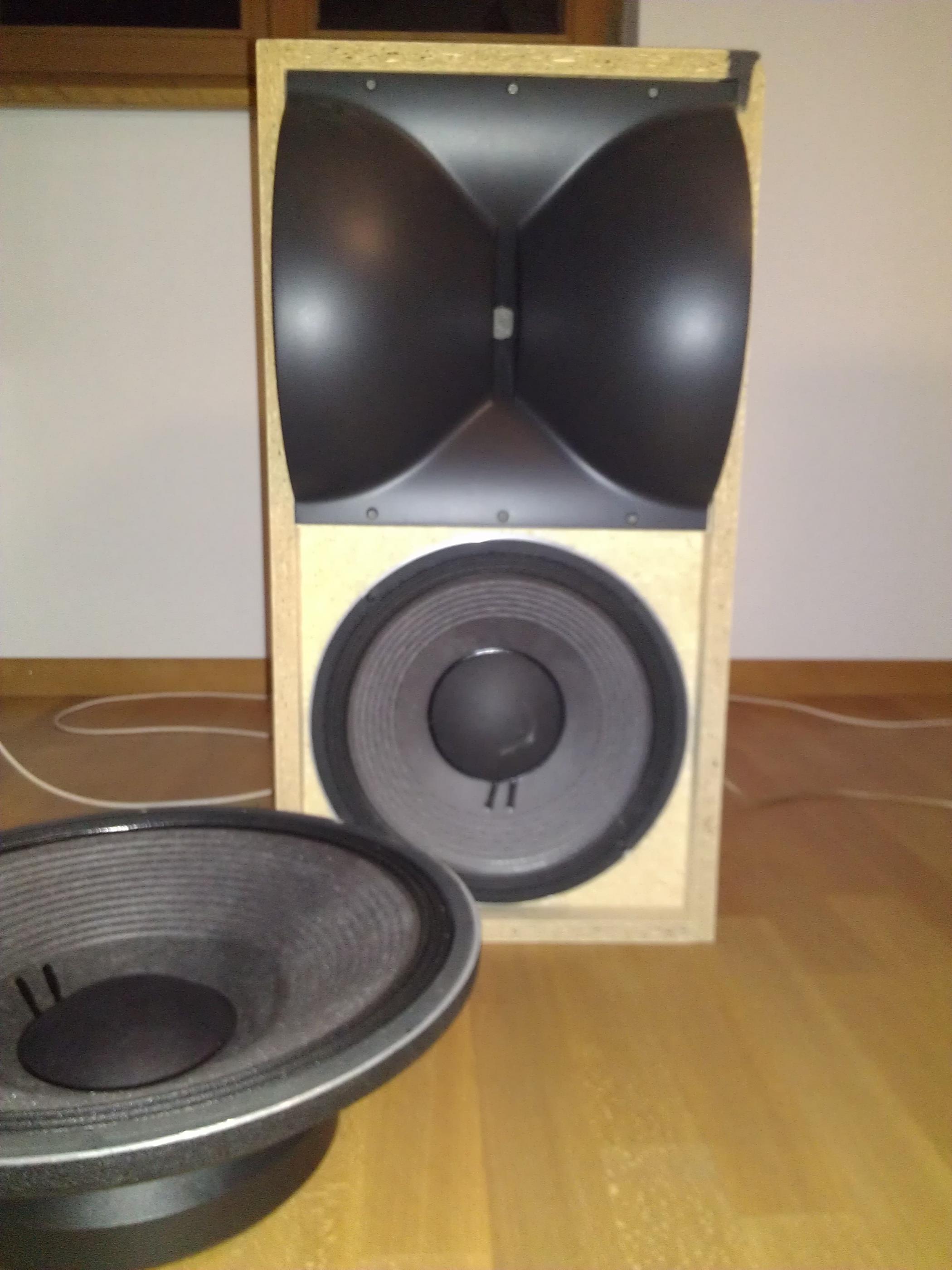

Ok here is a picture of that prototype. In the foreground there is one of my two 2226 drivers. The box is around 50 liters and tuned to 45 Hz approx. In the final one I will probably go for a slightly larger box with slightly lower tuning. This would allow a little more extension at the cost ofefficiency.
I was listening to it for about two hours. The effortlessness is quite addictive and I was listening loud enough to trigger the amp's thermal overload protection. It seems that it doesn't like to be tortured in bridge-mode !
From what I have heard what this single box with a 2206 is capable of doing in my living room (with the help some EQing of course) - I think the even more potent 2226 would be enough for the planned bigger box with a XT 1464.
While there are drivers around that are more modern and sexier than that 2226 one must say that it is still a serious no-nonsense product. The haptics is first-rate to say the least.

Be prepared to either swamp the network with resistors or notch filters, if you want "hifi" out of it. The 2425/2426 are nice drivers with high power handling and output, but don't try to force 15k out of them, and know that you'll be dealing with a peaky mess of an impedance curve to work against.
BTW: you can mess with the rear cup volume to tune your highpass filter pole.

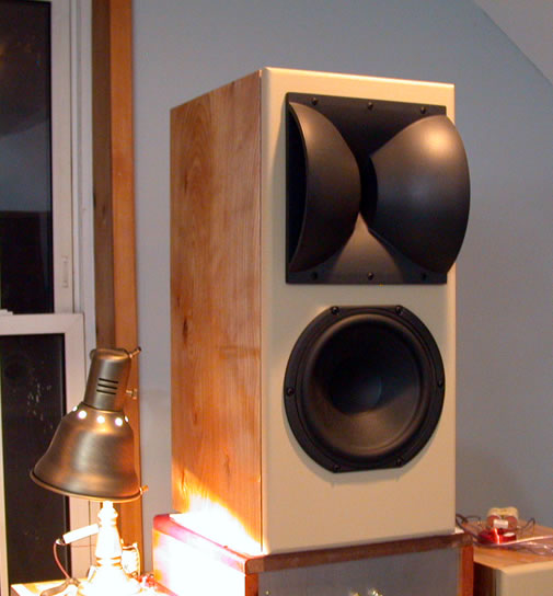

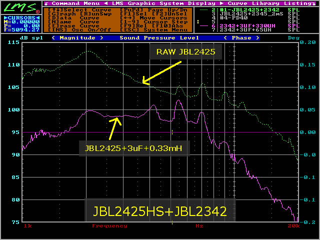

Here's my JBL2342 with a 8" Peerless 830869. The Green plot is the raw response of the 2342 with the 2425. No problem crossing at 2K but it's going to be quite a challenge at 1K2 with a passive crossover.

That looks really nice ! I will probably go for a similar design unlike the prototype which is more "PA style".
BTW: That prototype case that I made in quick and dirty fashion 17 years ago does definitley have some weaknesses: After torturing the speaker last night with some Chuck Mangione, Stanley Clarke and Dream Theater - some glue joint on the back-side gave in and now it is rattling when tortured. But that doesn't matter. But it is definitely a sign for what the driver is capable of. It is also a sign that age and maturity do not cecessarily correlate.

eek, I don't like those peaks (resonances).
Not being a pinching dispersion, I'd expect the drop in the high end (similar to a plane-wave response).
I thought the 2342 had no slot, but I was wrong, it's the small version.
People liked the optimized aperature horns from jbl better than 2344/2342.
