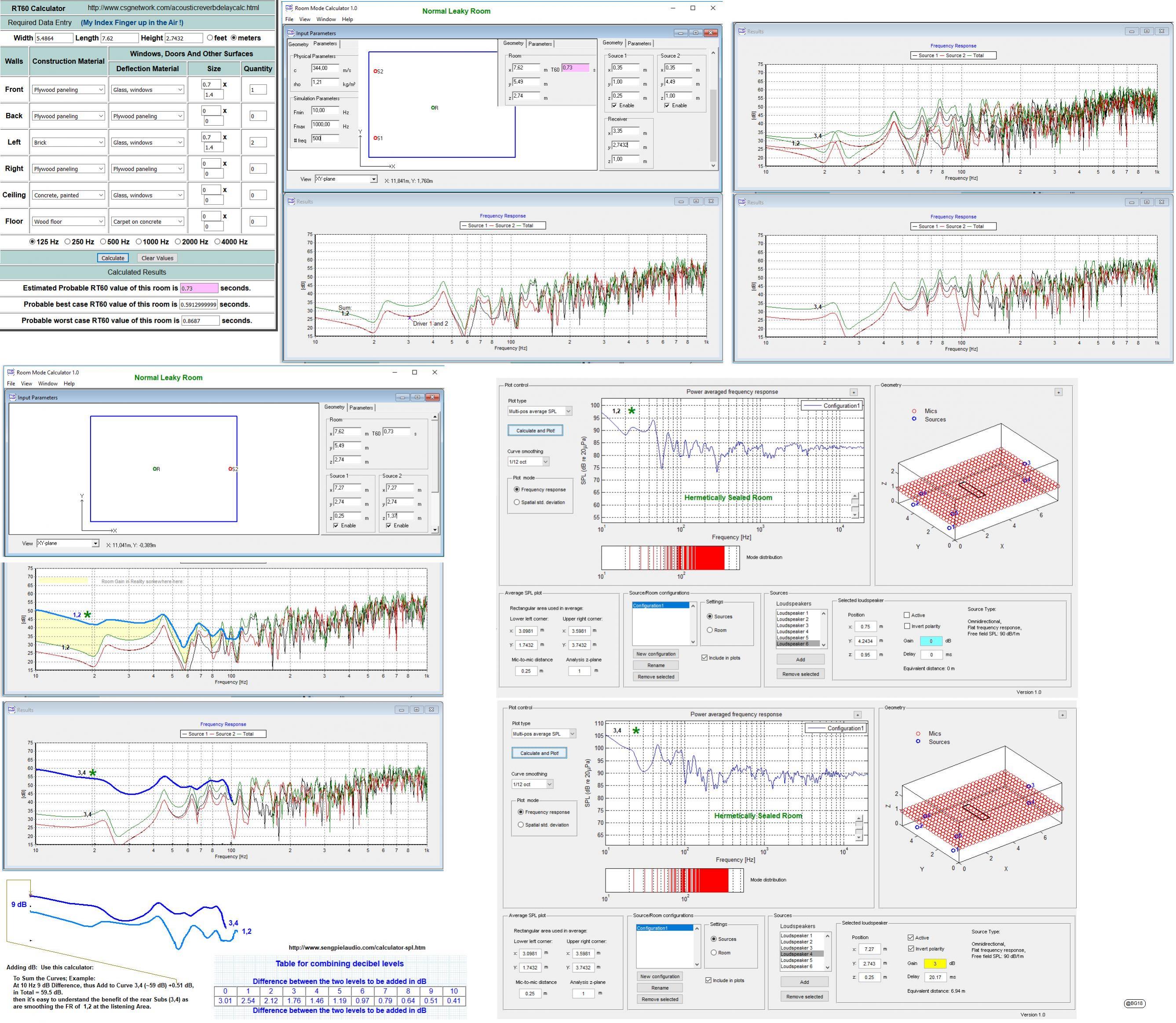

Hi All,
FYI:
Room Gain Plots.Might be plausible....
b:)
