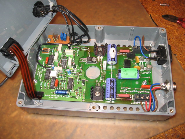

Well I finally finished my two speed Valhalla for my Linn and so far it works great and sounds even better. I had been wanting to play 45's on my Linn for quite sometime but I have always hated the adapter pulley so I've always played my 45's on an old Ariston RD-11S. 45 Singles have always been of mediocre quality so it really didn't matter. However very high quality 45 LP's are much more common now and I wanted to play these on the Linn. At the beiginning of the year my Valhalla suddenly died and I was forced to repair it. Not bad really considering it has been powered up since 1988. Thanks to the forum I was able to get a schematic. After realizing how simple the circuit it was, I decided to make a 45 rpm version. I purchased another Valhalla on eBay and mounted both boards externally in a separate case from my Linn. I wasn't very impressed with the power supply on the Valhalla. For 240V users it has a full wave rectifier filtered through two 47uF caps. For 110V user like myself it uses a voltage doubler circuit to obtain the 320V DC high voltage supply. Despite the low current requirements this is still not a very clean power supply so I built a separate power supply to power both boards using 110-240V transformer with rectifier bridge and 600uF filter cap. I also built a separate regulated 10V power supply for the low voltage circuit. I then added simple switching to allow easy changing for both speeds. I just finished it tonight and have been listening ever since. I think the better power supply has definitely helped with reducing motor vibration and the the sound stage has openned up and deepened. It reminds me of when I first heard a Lingo/Valhalla comparison but not nearly as dramatic. I am definitely happy with the improvment.

Changing a Valhalla to run at 45 rpm is very simple. You need to change the crystal oscillator to 4.433 MHz. The original crystal is 3.2768 MHz. Then you need to change R13 from 22K to 15K to give a bit more output because the low pass filter is optimized for 50Hz. The Valhalla will now output 67.5Hz which will give you 45rpm.

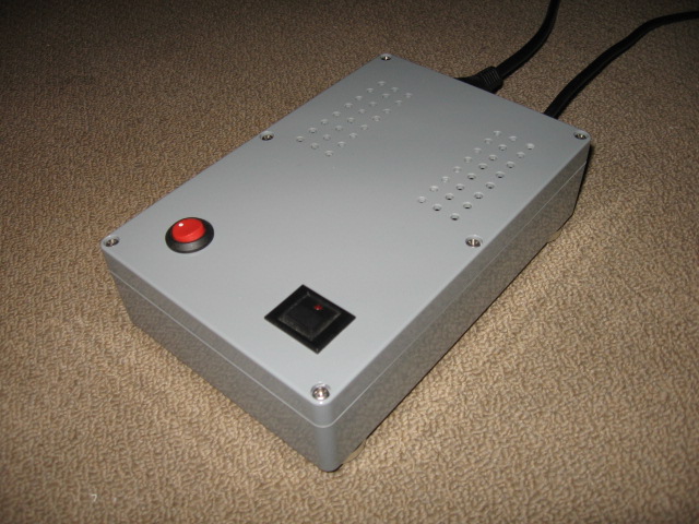

However in the interests of keeping it simple ( and cheap) I have whipped up a little add on circuit board to my Valhalla that has the two crystals and resistors on it, coupled to a double throw switch to select either combination and speed. Rather than fixed resistors I used 50K ohm trim pots that I preset to 22k and 15k and then fine tuned to provide 85 volts output to the motor.
I works just fine coupled to my AR The Turntable. No more faffing about moving the belt on the pulley to change speeds.
