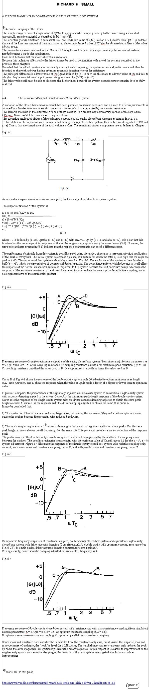

The other two pictures show a loudspeaker enclosure principle which utilizes two sealed chambers which are connected to each other via a "resistive" port. Does this kind of alignment have certain advantages when compared to a regular sealed enclosure?
I would be interested if somebody has more information or experience regarding this type of speaker enclosure.

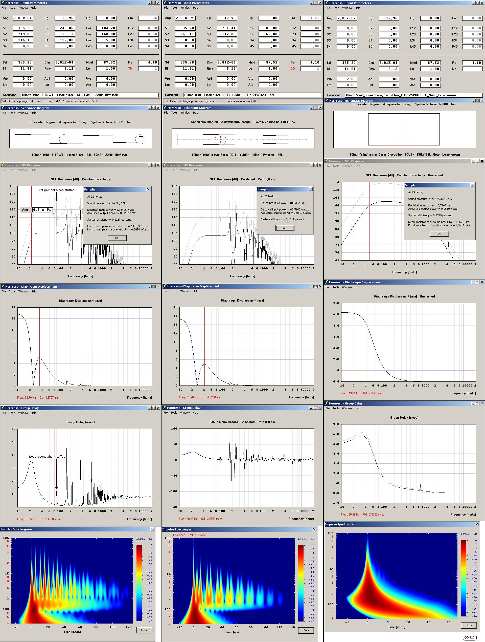

Since it doesnt utilize the backwave, like TH or BR do, and doesnt add resonance to the frontwave, like FLH or BP do, it will behave exactly like a sealed enclosure of similar size. if you want to know exactly, get AKABAK and simulate it.
If you want to get the most out of your driver and dont mind investing some time, get hornresp and see what you can do beyond sealed enclosures.

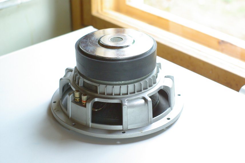

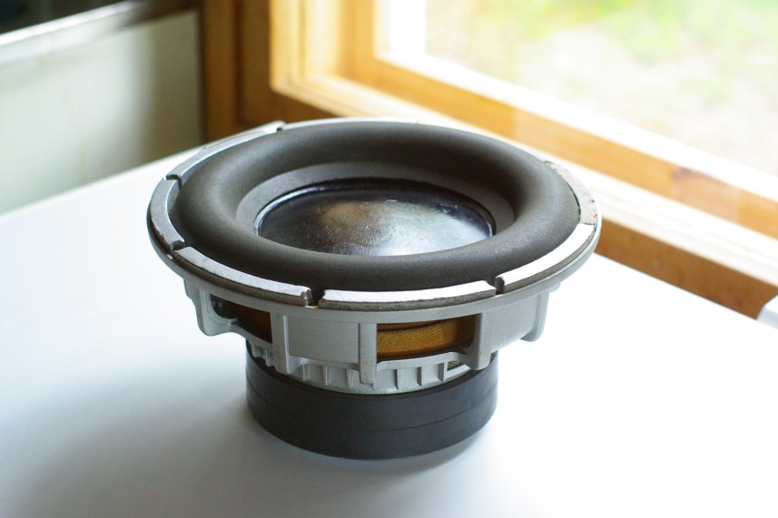

I attached two pictures of this 10" woofer. Its maximum excursion is approximately 8 mm (one-way), I measured it with a micrometer.

What you have posted are pictures of the Dynaco A50 & A35 -- these are generally classed as aperiodic. The patent is new to me, thanx. That it is of the vinatge that it is is interesting.
Naim does some enclosures like this, explaining that at high frequencies the small box is "seen" by the driver, at lower frequencies the 2nd chamber comes into play.

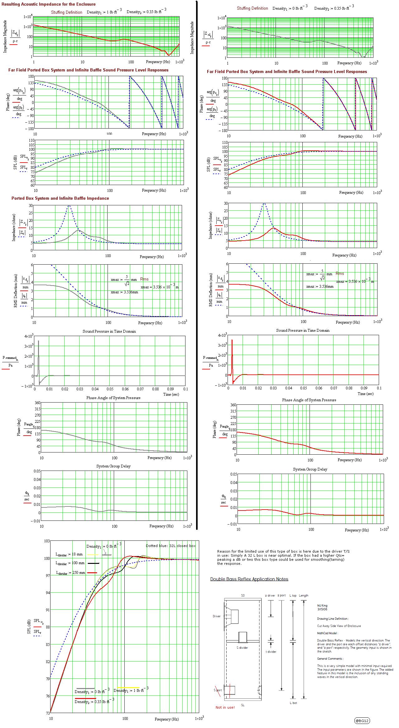

Hello
Thank you for your simulated data!
If I understand the graphs on your third attachment correctly, it wouldn't be of much use to place this woofer into a two-chamber enclosure of this size.
Nevertheless, it's interesting to notice that the figure 6-4 in your first attachment does show some increased low frequency extension. As the text says:
...The parallel mass and resistance not only reduces the peak by about the same magnitude, it significantly lowers the cutoff frequency. In this respect, it is a definitive improvement on the single-cavity system with acoustic damping of the driver...
I'm not very fluent with the technical terminology. Does "parallel mass and resistance" in this paper mean that the two cavities are connected with some kind of "lossy resonant device" (such as a slightly resistive bass reflex tube)? Or did I get totally off track?

..If I understand the graphs on your third attachment correctly, it wouldn't be of much use to place this woofer into a two-chamber enclosure of this size.
Right,...It depends on the observation of your driver data where Qts= 0.465 that in a 32 L box would return a Qtc of ~0.73 and if ported the optimal volume is about 80L + your earlier request that it should be a 2-chamber closed design:
I calculated a Qtc for a 16L chamber (Closed box/2) would be ~0.93.
The enclosure volume you favor is in conflict with the picture you posted : Planet10 remarks are good, the shown drawing depicts aperiodic Dynaco A50 & A35 designs and are totally different in operation compared to what you proposed as the enclosure volumes are terminated with an aperiodic port(s). My simulations didn't take this fact into consideration at all as this was not requested.
At any case your pick of volume would not work well in a Dynaco style unless you increase the internal enclosure volume.
Here,I guess you missed the last part of your quoted sentence: ' with acoustic damping of the driver' as this refers only to the * marked part of 'Small' :
Two-chamber sealed enclosure..JPG picture that is only supported by Small himself via a private mail conversation ,never officially published before but here.
No, The parallel mass and resistance Small mentioned is a superior method compared to any of the two camber methods, closed or ported: aperiodic or not, and is congruent with what Ive earlier have posted here:

In my simulation,in your thread, I placed with density # 1 two layers of damping material near the rear of the driver in order to load the cone similar to the "parallel mass and resistance" method.
This way was only IMO useful to a small degree as the 'MJK' 'yellow' plot color shows.
You can lower the Qtc=~0.732 down a bit,but paying with a resulting small rippled response.
Now it looks like I should go with a regular sealed enclosure with this woofer. But as MaVo suggested, I will consider adding a bass reflex tube into it.
Yes and Yes I would too choose MaVo's suggestion, i.e. If using an enclosure volume >= 40 L.
Then all the mentioned methods could be applied with a great success including a low cut-off FR : Planet 19's Mavo's and any of Smalls would work fine.
Otherwise, you have to fight with severe diminishing returns = a suboptimal sub(mid-bass) if when using your suggested too small enclosure volume.
