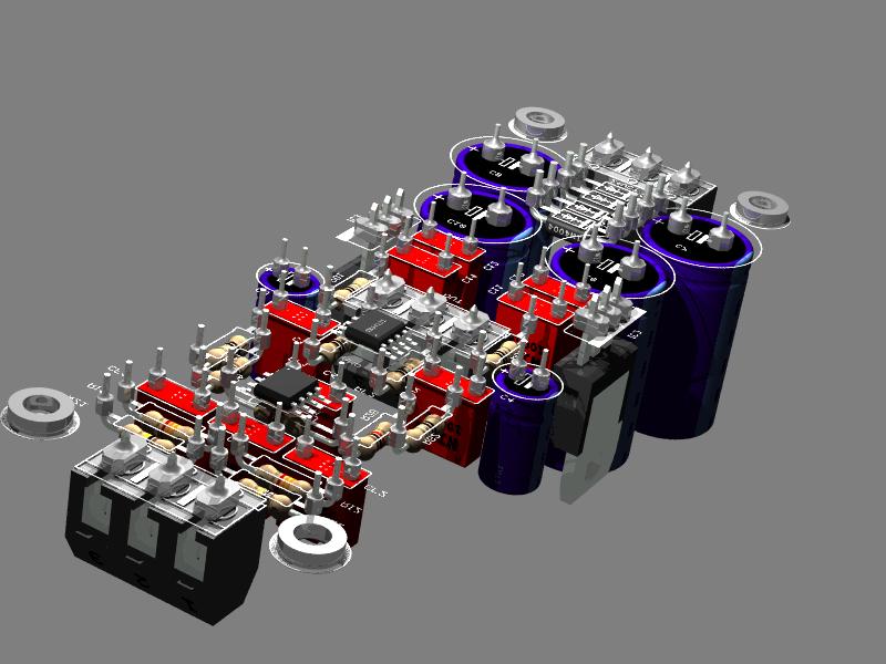

Basically I made a circuit that behaves very much like our (actually Terry Aben's) Twisted XBOSOZ, but in a very much smaller much more convenient package(1.5” x 4”). This project has been about two months in the making as has now been tested and found to be even more than I had ever hoped it would be.
The designed circuit is a mono amplifier/buffer which can be used with single ended or balanced input and single ended or balanced output. It can be used to directly feed something like a Super Symmetrical chipamp such as the one Terry Aben was so kind to share with us and I am now listening to. The circuit can also simply be used as an excellent compact SE to balanced converter.

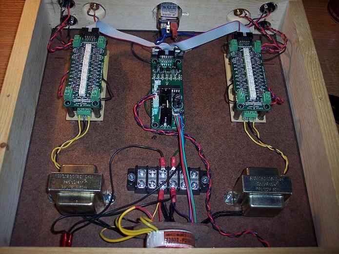

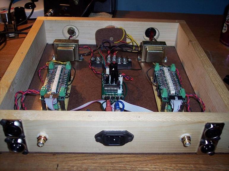

Here is the completed prototype which is driving a SuSy chipamp. It is setup for 2X gain. The front end is a AD8620 which is configured as a instrumentation amp along with the THS4131. You could use any unity gain stable dual op amp which is good for audio on the front end.

I will post single sided PCB PDFs which are free for DIY use.
I will post the schematic.
