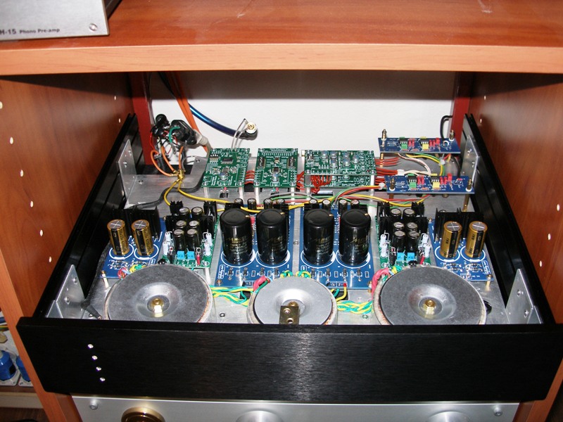

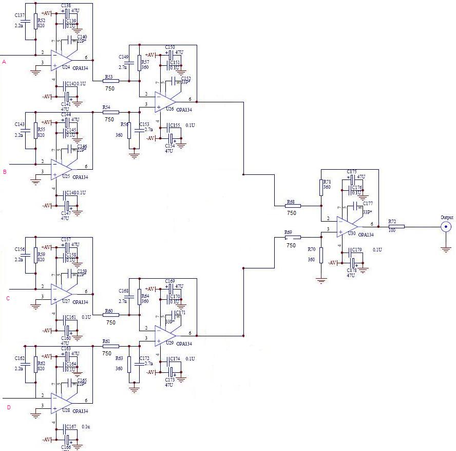

I’m building a dual mono dac with “Twisted Pear Audio cod pcm1794” for the “i/v plf” stage I will use the following schematic
Because I am a bit confused about the currents of “cod pcm1794” in mono mode could you inform me please , how to connect the points A B C D (wich I am noticing in the schematic) with the “cod pcm1794” in “left mono mode” and “cod pcm1794” in “right mono mode” respectively , in a way that both channels would be in phase between them.
