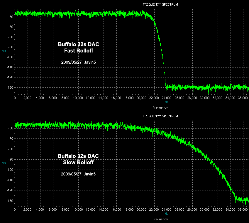

Re: Buffalo 32s Rolloff
Nice plots! Thanks.
Javin5 said:With switch S3, you can select between fast and slow rolloff. Here is a plot which shows how the two modes look in the frequency domain. Most will probably prefer the fast mode because of its superior aliasing rejection.
Nice plots! Thanks.

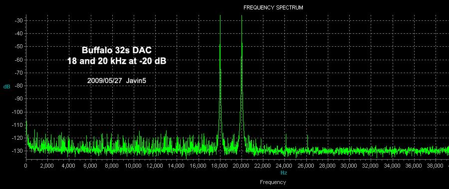

Buffalo 32s Aliasing and Intermodulation
For those who are interested, here is another FFT-plot of an input of two sinewaves at 18 and 20 kHz at -20 dB. The remaining aliasing components at 24.1 and 26.1 kHz are vanishingly small. Also important, there is not a trace of intermodulation distortion at 2 kHz; which shows excellent design of the IVY-circuitry!
High frequencies at such high amplitudes are practically never present in music signals, so you may look at this as sort of a stress test; but the results are certainly reassuring.
Kurt
Kurt

Re: Buffalo 32s Aliasing and Intermodulation
Indeed! Thanks Kurt.
Cheers!
Russ
Javin5 said:High frequencies at such high amplitudes are practically never present in music signals, so you may look at this as sort of a stress test; but the results are certainly reassuring.
Kurt
Cheers!
Russ
