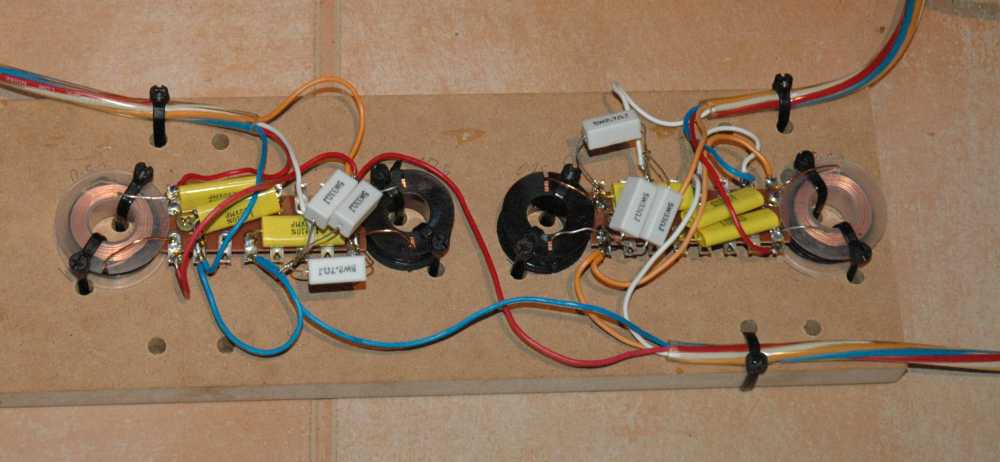

threw a couple of ugly crossovers together this afternoon. Soldered the bits where they touched. well almost, I used a couple of bits of tag strip, some cable ties and a plank of wood.
I have not allowed for Baffle step or driver VC inductance. It's just a dumb textbook ideal world crossover. Significant improvements could be made by someone with more experience with crossover design, it's a useable starting point for you if you are interested.
Fe207E is 16 ohms at 10kHz.
10kHz Low pass:
20AWG 0.5mH inductor in series
0.5uF metallized polypropylene capacitor across the driver. (I used two 1uf in series which is dodgy.)
My speaker cable is 20AWG so I figured the cheap inductor won't cause much harm. I've been told these drivers like thin speaker cable anyway, some people even use 24AWG. DC resistance of the inductor is less than 0.1 ohms.
FT17H is 8 ohms and pretty flat.
10kHz high pass:
1uF metallized polypropylene capacitor in series.
0.25mH inductor in parallel.
then 2.7 ohms in series
then 16.5 ohms in parallel (two 33 ohm)
the resistors drop it about 3dB, the FT17H is 3.5dB more efficient than the Fe207E at 10kHz. I first ran it without the attenuator but I didn't like it, the tweeter was too much.
I've only listened to this for about 10 minutes now. Vocals are unchanged from when I ran it full-range. There might be a little bit less bass but I'm not sure. rear mounted without the attenuator would probably work well.
Picture not for the faint hearted. Have a bucket handy.
edit: cable to amplifier in the bottom, cables out the top go to the speakers. white and orange to tweeters, red and blue to the full-rangers.

I borrowed a tube amp and the ugly mess I made earlier gave it a real headache at high levels. It was really quite awful around the crossover frequency - very garbled and hissy.
I came up with something simple that sounded pretty good.
series 8 ohms with series 0.57 uF
I used 4x 33 ohm in parallel for the resistor then a 0.47 and a 0.1 in parallel for the capacitor.
Works out at 17kHz first order.
