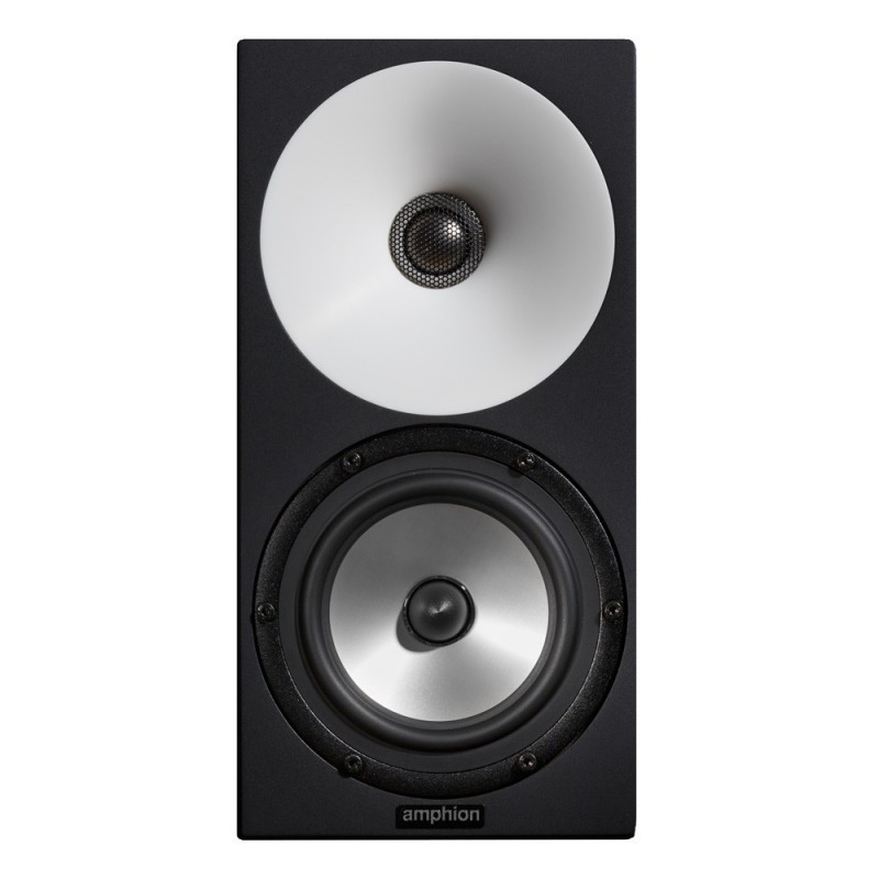

They can, as evidenced by many a finnish loudspeaker. Amphion I think at least used to cross over to the tweeter somewhere around 1,5kHz, though they did use a waveguide which does give some leeway. Aurelia is doing much the same. Still, they're nowhere near CD's when it comes to dynamic capability.

From frequenting pro audio sites it seems Amphions eat tweeters for breakfast, lunch and dinner.

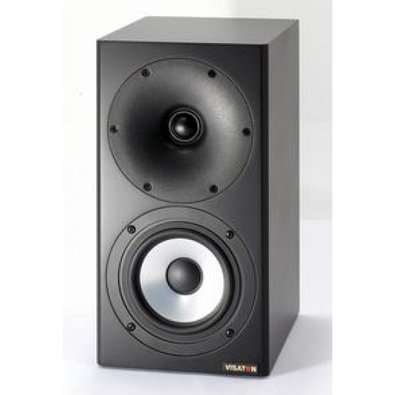

Certainly a weak point but I don't like the woofers they use either. On the whole they appear to be an expensive built copy of the Visaton Studio 2 kit using inferior drivers.
Might be that they're being used beyond what they're being intended to. Used in a home setup, where most of them are made to be used, they should last in my experience.
From what I know, though, they do use quite shallow filters for their tweeters, and they have a point in doing this. This might still be a reason why they have a hunger for tweets in pro use?
I'm not convinced that Amphion is the best that finnish loudspeaker manufacturing has to offer the world, but calling them copies of some Visaton kits is a bit harsh to my ear.

Same size, similar drivers, same crossover trickery.
One is older and cheaper but you have to build it yourself.
I dislike Amphion almost as much as I like Genelec.
I am just curious if the woofer on the right speaker is a Seas Alum unit?
