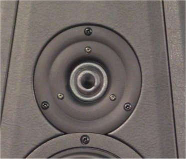

kingdaddy said:Try the link I provided, the pictures are huge. this is the best I could do, changing the DPI did not help.
Actually, I did use the link you provided. For some reason I thought it was the Sonus site. Color me stupid. Anyway, it was a 90K pic. So how did it grow to 270K?
The picture I was trying to scale down was 2.3M it's the forth picture on the thumb list in the link provided, it shows just the top portion of the speaker with the tweeter and mid and part of the baffle. You have to save the pic to your HD first to tell how big it is, cant right click.

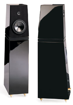

I posed a query to her and with her help found the Amphion website here: www.amphion.fi/
Their speakers include tweeter waveguides. The Krypton is an oustanding example of what I'd like to build. Karoliina says they use a proprietary version of the Seas 25TAC/GW.

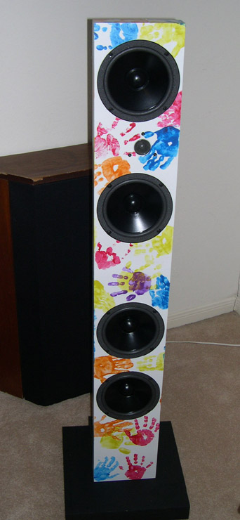

Probably not whatyour looking for but I removed the face of a Dayton silkie and "frenched" it into the baffle. Glue the faceplate in, fill with bondo, sand, fill sand, paint (or veneer). Worked like a charm for me.
This assumes that the faceplate is flat on the surface though.....
BTW, the speaks were built for my daughter . she loves 'em.
I've got to hand it to you - they're great!
