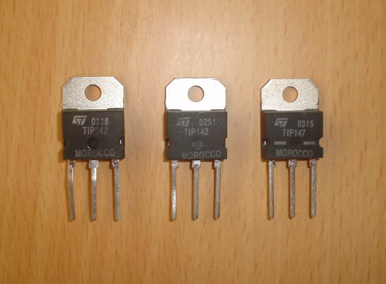

Luckly.. I find TIP142 & TIP147 complementary darlington pairs in the local market. These devices should perform better than those MJE13005/2N3055/HOTs ..right?
Then contacted a friend of mine (who have a digital camera) to took this pic. Because... The labels on 'ST' make MJE13005s from MOROCCO are LASER carved. The TIPs are also 'ST' make from MOROCCO but the figures are printed instead. Are these fakes...? the pictures shown in http://www.diyaudio.com/forums/showthread.php?s=&threadid=50163 makes more confusion. Do I need the Hammer test to reveal the truth...?
These look real to me. I am no expert on this but I have seen quite a few of these devices and they look like the ones you have here. I bought some TIP141/146 pairs from Mouser and I am not too happy about being gyped. The 146's are from Mospec and they are genuine. But the 141's are fakes. They are so fake that I knew they are fakes the moment I took them out of the pakage. I am not at home right now so I can't show a picture, but this was confirmed because 3 of them died under conditions where they most certainly shouldn't have. None of the 146's failed.

Those would work okay in a sub amp, but the collector-emitter breakdown is 60 VDC. That means you cannot exceed a bipolar supply of 30 VDC with zero safety margin. Whatever you build, I wouldn't exceed plus and minus 25 VDC for supplies. Real 2N3055 also have very low fT as they were designed for power supply pass transistors. The originals were 19 KHz (yes, you read that correctly). I had to service all kinds of DIY amps in the 1970's made with real 2N3055 transistors. There wasn't one that was high quality. Remember also, these were a commodity part designed to be inexpensive for the industrial market. No thought was ever given to audio service. Later the 2N2955 came out as a compliment to he 2N3055. Still not designed for audio, but many cheap amplifiers were commercially made with these.
Good way to learn how to build an amplifier though, and it will work.
NAD used 3055s in a number of their audio amplifiers with no trouble at all. Lower fT just means you need more current at high frequency; thankfully the average power is very small at the top of the band. The 3055 was improved over the years; the late ones being good usually for about 3MHz, some up to 6MHz (I've measured this myself) (RCA SC-15 manual from 1971 specifies fTMin of 800kHz and fhfeMin of 10kHz). Vceo is indeed low, but for a small amplifier or one meant for low impedance loads, this is no problem.
Obviously there are significantly better devices available all over the place, but the 3055 will function in an audio capacity pretty happily :)
