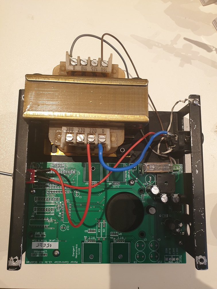

Slowly stuffed the smd parts and almost ready to test the psu section.. I found a step down 230V-110V transformer I reckon I could use as an isolating trafo for the startup tests (I will then be on 230V), but.. would it be ok to test the Controller with this trafo @ final voltage/freq of 110V-50Hz?

Hi Geoturbo,
glad you are making progress. Yes its OK to use 110v to test with - so to do that install C24 (instead of the wire link) and configure the input for 110v. One you are fully tested, remove C24, install wire link and configure input for 230v. I can't remember if your kit has a three or two position input terminal block but either install the two position in the 110v & live position or solder directly. No issues if its a three way input block. If I have not given you a C24 in your kit (as you live in a 240v region), then either temporarily use one of the output capacitors or fit anything around a 22-47uf > 250v capacitor.
Thank you Steve,
currently everything psu wise seems fine, I wire-linked C24 and used 110V on 230VAC input for first startup, readings were fine so then used the trafo's 160V secondary and getting 7,99VDC at P8 and around 230VDC at TP8 so it's good to go onto next steps and reckon there should be enough Voltage I could use it like this in the next test phases for my 110V Nottingham Analogue motor :up:
