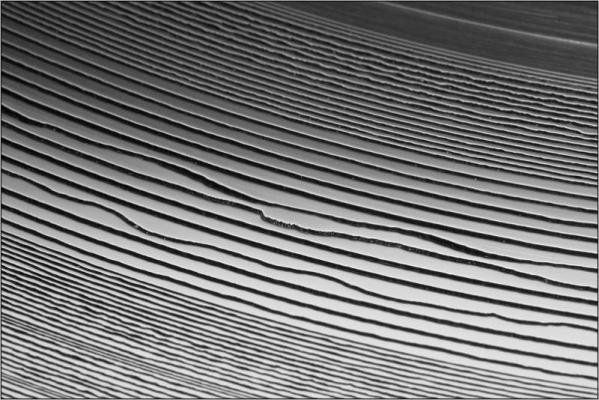

Hi Ralf, If the cutting head which is attached to the lathe would travel towards the spindle in a variable speed the distance between the grooves must be visible varying as well. But looking at grooves their distance stays the same apart from the in/out and quite passages between songs. Therefore I still assume and hope that a tangential tonearm travels at constant speed. Does that sound illogical?
There might be two different movements we are talking about - the one I refer to is the movement of the lathe towards the spindle while cutting the groove. As there is a constant distance between the spiraling groove I assume that the lathe travels at a constant speed while cutting the groove. If that is the case then a tangential tonearm ought travel at the same speed from outside in. Plausible?
Very early lathes used a constant pitch (and also constant basic groove depth) but that is not the way to cut long records at good level (And even these had a manual wheel used to put the spirals and marker bands in).
Classically the tape machine had two sets of replay heads, typically spaced to be exactly 1 revolution of the disk apart.
Signal processing then drove the lead screw at a speed just sufficient to maintain some minimal amount of land, and a the difference component was used to deliberately add low frequency modulation of the depth of cut to suit the amplitude of the difference component. This also sums into the leadscrew speed because the width or the cut is proportional to the depth (Yes, the lathe deliberately creates rumble!).
The lathe 'computer' on the early examples were wonders of analogue memories made from switched cap banks driven by photocells looking at the bottom of the platter, transformers doing the sum and difference and all sorts of funkyness.
By the time the VMS80 arrived this processing had gone digital and could actually allow two grooves where they both curved in the correct way to fit such that at some points during cutting the leadscrew would completely stop for a moment (I don't THINK anyone did a lathe computer that would drive the lead screw backwards to snuggle the grooves better, but all sorts of things were done).
Don't forget also that even without the vari pitch computer, the consoles had switches for adding a high pitch marker band to separate tracks, to temporarily increase pitch to reduce the echo you otherwise get on the cut when a silent groove precede or follows a loud bit, and that the lead out spiral was per RIAA standard cut at a VERY course pitch, then of course you get the lock groove which has no pitch at all....
Your assumption of constant groove pitch is NOT how records typically work.
Nice example.
Even after allowing for the IRIAA LF roll off, the bass still takes about 3 times the area for the same nominal level at 20Hz as is occupied at a kHz, in spite of the velocity being about 20dB higher at 1kHz.
Notice also that that LF section has got sufficient difference component to have forced an increase in groove depth, which in tern impacts pitch because the grooves are just wider (The grove has 45 degree walls).

Gentlemen, thank you for your truly in depth explanation! Highly appreciated and impressive to learn such details. There is however still one question you most likely could give me an answer to which is - does a tangential tonearm move in a linear speed or in an exponential speed from the rim of the record to the center?
But looking at grooves their distance stays the same apart from the in/out and quiet passages between songs.Hello flogybkk,
If you are looking at an LP containing easy listening music, you are probably not going to see any obvious variations in groove pitch even though it will be there. But if you look at an LP containing music by let's say Beethoven, you should be able to see obvious variations in groove pitch. There are exceptions to all of the above comments when a master disk is cut using the "direct to disk" cutting method, where there is no tape machine between the musicians and the cutting lathe, although I've heard of studio engineers who are so skilled that they can manually ride the lathe carriage speed control to achieve variable pitch during a "direct to disk" session. That requires that the engineer is intimately familiar with the music being recorded in order to anticipate upcoming variations in volume level.
Groove pitch by the way can vary from .002" .011".
