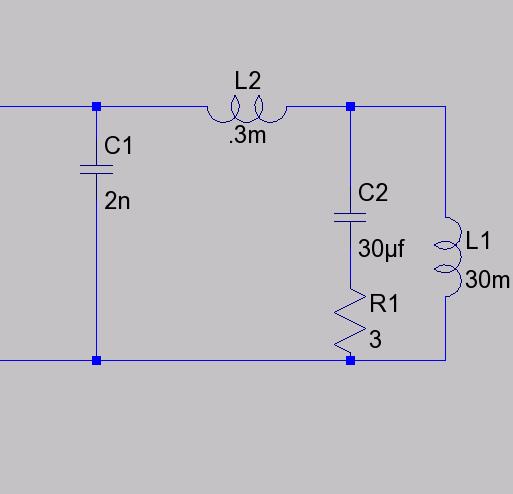

Charles, about NFB:
The response looks quite good experimentally. With resistive loads, there is no trace of inestability at any point of the signal. Sound is very good for my taste also. The only hint observed is some HF oscillation at certain high amplitudes with my test loads (JBL TR225 2x15"+tweeter), perhaps they are too complex.
Is that normal/acceptable?
Salut Pierre
Do you have any possibility to use a dummy load that shows about the same impedance as the speaker box above the audible range ? This would be convenient for testing of loop stability.

Very valuable suggestion, alfsch, Thanks!
From your experience, what is the typical situation for a typical box? all switches activated? (or all except one of the 8 ohm resistors for 8 ohm loads). I suppose that model doesn't include the typical crossover effects, right?
I will recalculate the simulations to see how phase margin is affected with these loads.
Best regards
Best regards
With the dummy load model proposed, 8 ohm resistance, the simulations show that phase margin is reduced to around 25º.
That's quite small, so I decided to change the feedback cap from 33pF to 56pF, and that seems to improve things a lot and produce a phase margin of around 42º.
I have to test that change in the real amplifier, and then I will tell you...
imho typical box impedance is not useful.
more difficult for amps is cap. or ind. load, as i wrote;
cap is about like using a el.static speaker,
ind. like a bass-chassis only .
so you see r..real load (never real for real speakers
cap / ind or both : load with +/- phase for current.
if a amp has no problem with any combination, you can assume, it will be stable with most or maybe all speakers.
the ind. load i use is more complex :
it simulates a bass-speaker with typical resonance...
