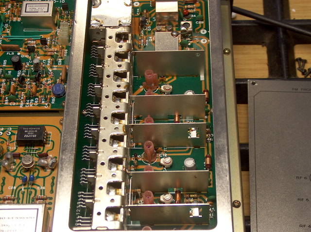

This Philips fm stereo tuner is a comfortable tuner with good reception, even for more far away fm radio stations.
If you want a high quality concerning the perception of high quality sound reproduction, you need a stereo tuner, where its IF amplifier don't use ceramic filters from murata as the FT930 like this:
http://www.reichelt.de/?ACTION=13;PIC=1;WIDTH=300;HEIGHT=300;ARTID=17485
and this
The FM Ceramic Filter Page
instead ceramic filter you need a tuner, where its IF amplifier section only use bandfilter (phase linear character) with inductors.
The Revox Tuner A76 and the Tuner from Klein+Hummel "FM2002" (FM-2002) are examples - go to
REVOX A76
http://h2.abload.de/img/kenwoodmodel600taus818ezwt.jpg
Tuner-Papst Reinhardt Wieschhoff gestorben: STEREO | Zeitschrift für HiFi, High End & Musik
friendsofaudio • Tipps • Vintage HiFi • Tuner
Klein + Hummel FM 2002
http://www.ebay.it/itm/Klein-Hummel-FM-2002-in-der-FM2002-MA-Version-/250836441918
http://www.vintage-tuner.com/tuner3/saba/saba_fm-2002-01.jpg
In the attachement more pics.
If you search for a low cost tuner, use only such with variable capacitors for the fm tuning and such produced before approximately 1973 - then you have in most cases IF amp variants without ceramic filters.

Might want to check out the Tuner Information Center here: Tuner Information Center - Vintage Stereo Tuners and the associated yahoo listserv/message board. Lots of real expertise in the group and TIC has lots of useful information as well. The Klein-Hummel is reputedly a very nice tuner.
I have a modified McIntosh MR-71 and a Kenwood KT-8005, I particularly like the 8005 despite its use of oddball ceramic filters..
