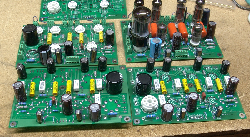

How have things been going with testing?
Not much testing going on. I have been building boards (4) and taking pictures at every opportunity. I have about 500 pictures so far. I have started the process of sorting through the pictures and processing the ones that will be used in the manual.
I have about 1 more week before I have to travel. I don't have any exact plans yet other than an apointment for my mother in law in Pittsburgh on OCT 19. I should have all of the pictures and other data necessary for compiling the construction manual during the trip.
There are thousands of components (many still in unopened boxes) piled up that need to be organized before the "bag of parts" kits will be ready. I am guessing that everything could be ready by early November, but I can't forsee all of the "stuff" that seems to happen.
There are 5 boards in this picture. The 2 in the front row are being assembled for the pictures. The two in the second row are both completed working boards. The one in the back row is being partially assembled to shoot detailed pictures of specific components. The assembly line:
