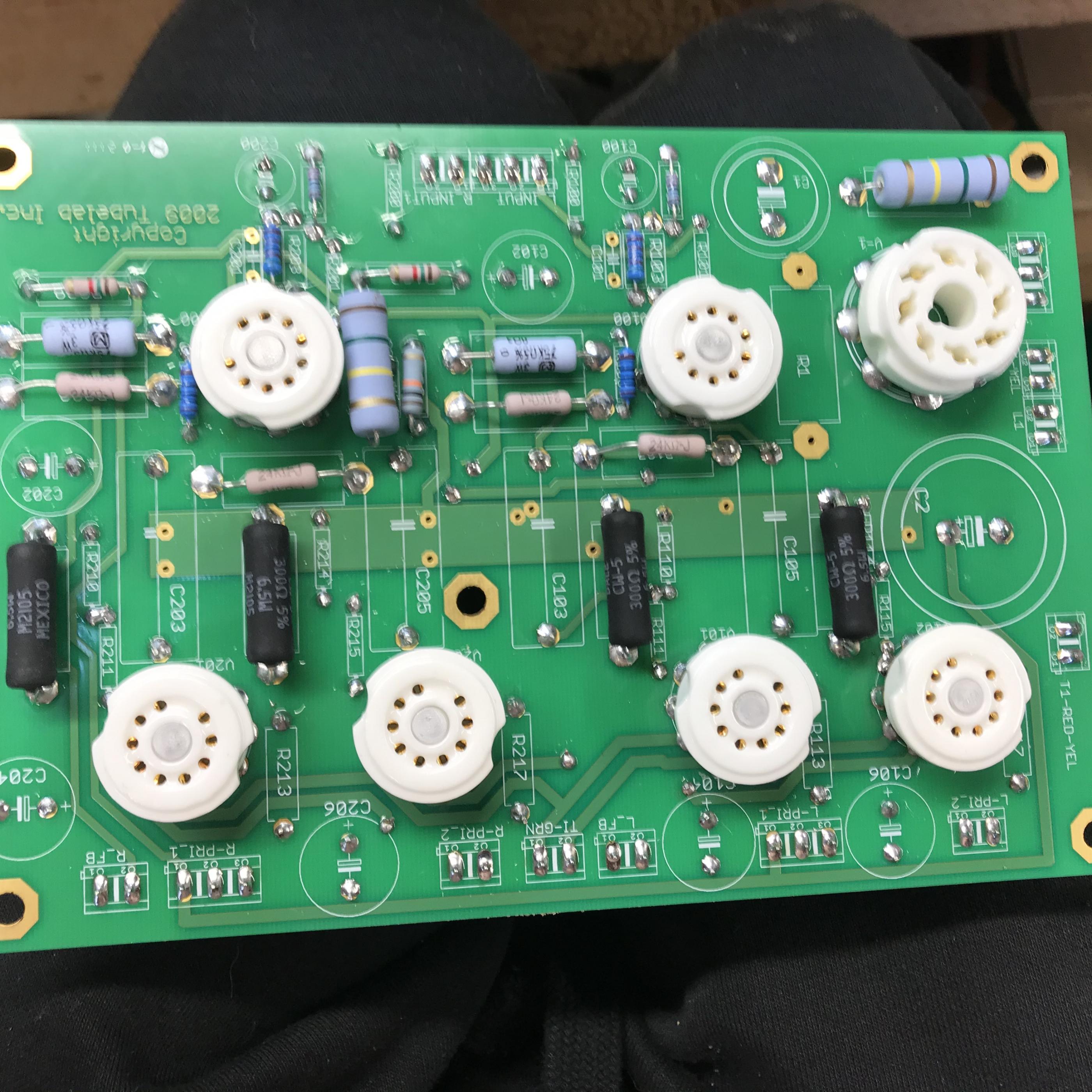

I read that build article a couple of years ago. I strongly suggest that you ignore the part about drilling holes in the board so that it can be used as a drilling template for the chassis.
Instead, its far easier and less risky to the PC board to simply download the PDF template found in post #48. Print it out, then use the board to verify that it is indeed 1:1 with the board (holes line up). Some computer / printer combinations are not exactly 1:1. Most printer or PDF viewer software offer a scaling feature to fix this.
Once you have a 1:1 print out, simply tape it to the chassis and center punch or drill right through the paper.
Thanks that’s a great suggestion, I was a bit leery of drilling holes in the pcb and thought there must be a better way. This is my first attempt building something like this and I intend to follow that series quite closely as he includes detailed instructions for the chassis, volume control etc so if you have any other suggestions or things that could be improved upon please let me know.

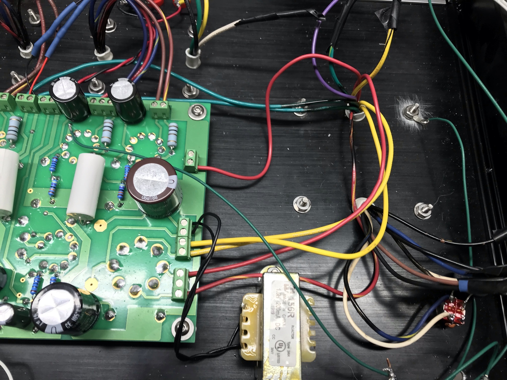

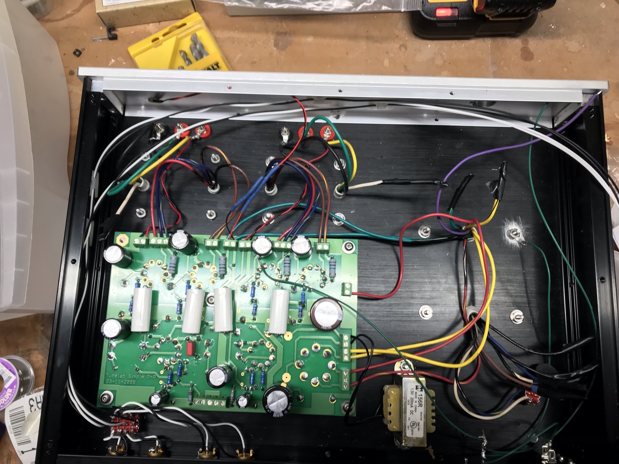

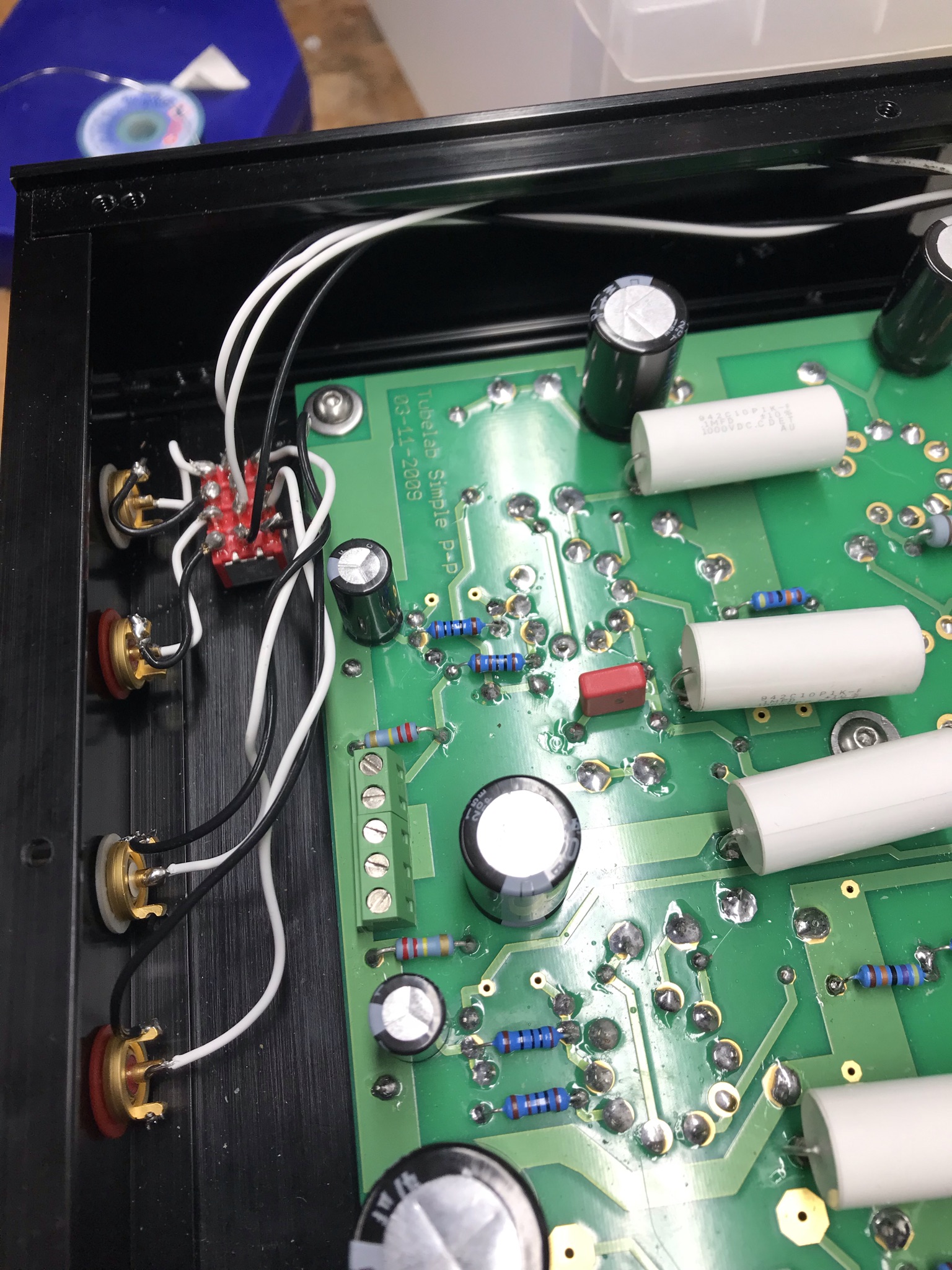

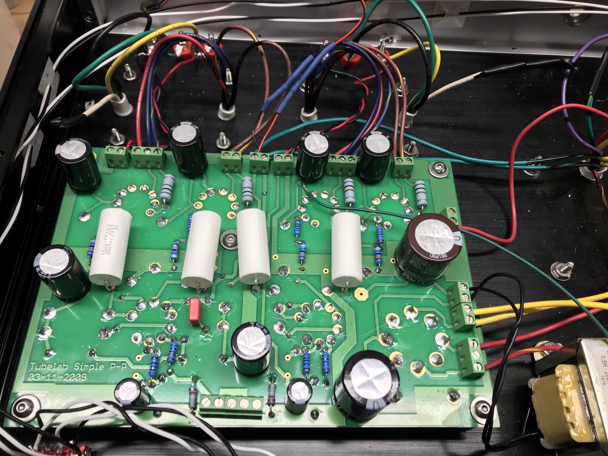

I'm nearing completion of the SPP amp kit. It's not been turned on yet and I'm debating whether to connect the volume pot or not.

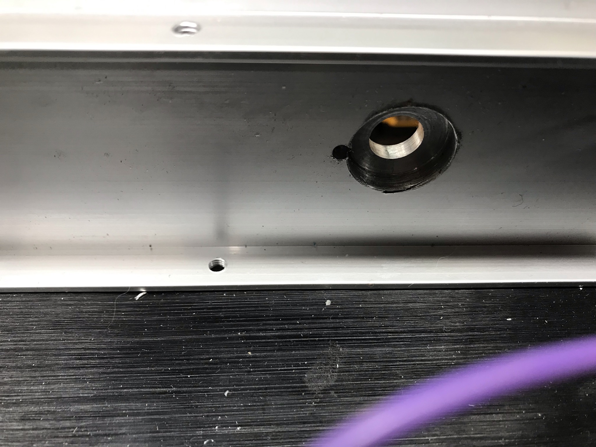

I've been following Steve Grahams excellent instructions and I'd highly recommend anyone who is planning to take this project on to do the same if like me this is your first attempt at something like this.
I made a lot of mistakes and ended up doing things a little bit differently as a result. I've written a few of them up here in case anyone in Europe is planning to make one of these.

I also drilled a counter sunk hole into the back of the front panel to mount an AudioNote 100K (from hifi collective) pot instead of mounting it on a separate piece as described in Steve's articles. I drilled this and the holes for the tubes in the chassis with a drill press, Steve seemed to do it with a hand drill but this must have been very difficult...
I printed out a picture of the schematic, and sized it to exactly the same size of the PCB instead of drilling holes in the PCB as suggested by Steve.
Mistakes I made :/

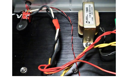

1) I thought the 159R chock would fit in the chassis in reality it was way to big so I got the 156R instead
2) I put the power amp in the wrong way (there are differences between the 272JX and 373HX I didn't take into account)
3) I bought several different capacitors as the ones I wanted were out of stock however some of these were over 25mm high and didn't fit in the case
4) Steve forgot to add 2m of red 18 or 20 guage wire to the order, so I didn't have this
5) I wasn't careful with the top panel and realised afterwards that the mounting holes aren't symmetrical, therefore in order to create the case I had to reverse the position of the circuit board, meaning that the connections to the front and rear panel are all opposite to Steve's. I also had to move the on/off switch as a result as it was next to the power input. However in some ways I prefer this layout as everything is closer to it's natural connection point with the board
6) I must have gotten sloppy with the placement as one of the 5 screws supporting the PCB doesn't line up correctly.

I'm debating using an external volume box, I mentioned this earlier in this thread. As it's more versatile and I don't like the long hookup cables to connect the pot. I plan to connect this to a raspberry pi running an Allo AC/DC so the need for a manual volume is limited. I haven't connected the volume pot so this is still an option.
I'd buy the bigger 372HX power transformer... because why not?
Any suggestions regarding the volume pot?

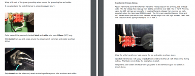

I have one issue that I'm a bit confused about. Originally the 272JX was used which has black (125V) and white (0V) leads from the primary. I've attached a screenshot showing how these were wired to the power switch.
However it appears that the neutral lead of the AC input (white wire) is connected to the black primary winding (125V) though the inrush limiter (large black thing, looks like a capacitor). Similarly the live lead of the AC Input (Black) is connected to the white (0V) lead of the primary.
Is this correct (in my mind it seems the live lead of the AC should be connected to the 125V primary) and can I simply replace the black lead of the 272JX with the blue/yellow lead of the 372HX, as shown?

In the instructions I flipped the black and white on the primary for no good reason that I can recall.
I assume you have 230 AC power. In this case it might be best connect the white to the neutral and the line lead to the BLUE wire (which is likely the 240 volt connection). Use the blue for first start-up and measure your filament voltages. If they are a bit low then switch over to the BLUE/YELLOW. Better to start a bit too low than too high. Be sure to securely (double?) insulate the unused transformer wires.

Thanks Steve, I really appreciate the reply and your excellent series of building instructions.
I’ll unsolder and switch the primary leads in that case.
Using the 240V primary tap seems like a good idea (you’re correct it’s the blue one)
Unfortunately I installed the 300 ohm resistors, damn I’m not sure why I did that. It’s a pain to take up the board and resolder them on the opposite side but I might be able to do it through the tube holes. I do have 360 ohm resistors, so I’m not sure why I decided to use the 300 ohm resistors but I remember thinking about it
