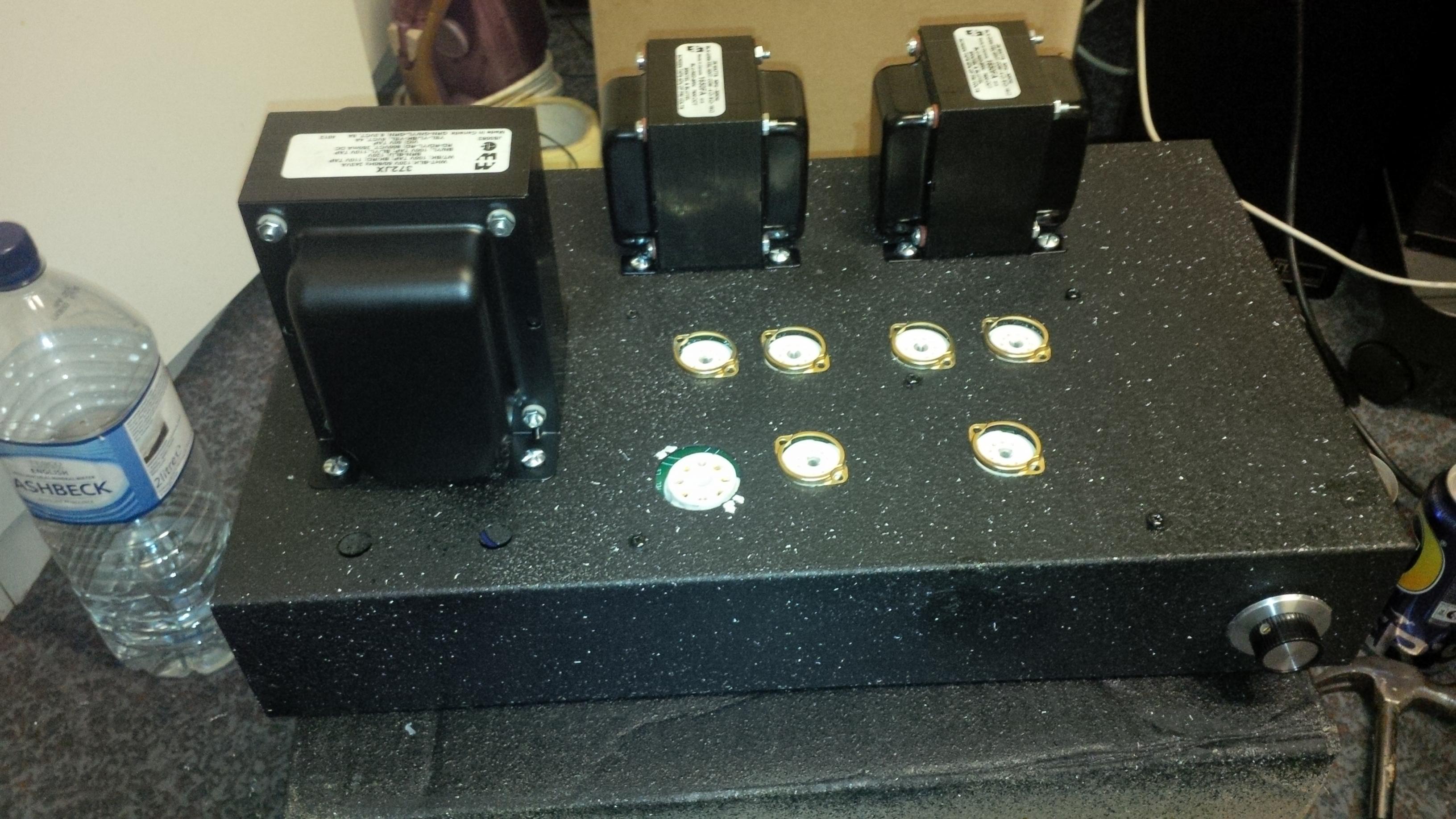

Have a constant hum in one channael. Swapped the tubes around and it's still in the same channel. Any ideas?
Ok so after some fidling I have a few conclusions. The left channel or channel closest to the PT hums more with the volume down low. I've swapped the tubes around and its definitely not the tubes. I've narrowed it down to the PT being too close to board or perhaps its the filament wire that partially runs over the output section? I'll keep tinkering.

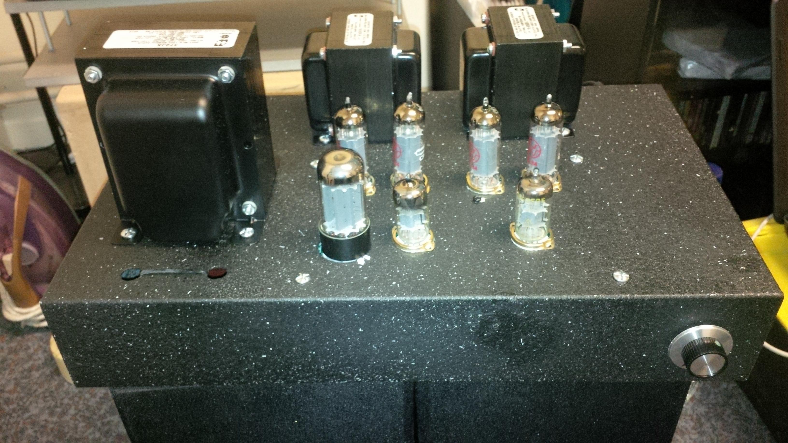

Russel thank you so much for your help with the wiring. I've been so busy with work that I haven't even checked my Facebook in ages. That aside I managed to put aside sometime to fix a few niggles with the amp it's not perfect but the sound is...dare I say charming.
I need to replace the volume pot as I'm getting some nice with the vol low down and One channel also plays abit lower than the next. One of my rft 12at7 valves fell on the ground so I need to get another matched pair.
Apart from what I mentioned the sound is very transparent, vivid and realistic. Guitar solos and sax singles sound just superb. The Diana Krall "Love Scenes" album is almost magical on it. However on bassier tracks the amp does fall short but that can be down to my OPTS which are Hammond. I wished I spent more on the Edcors like I was advised or the triode dynaco clones.
Overall it's a great midrange sounding amp. It was fun to build and I'm going to enjoy tweaking it.
Here are some pictures.
Kerontt, I found the rft 12AT7's to be stronger in midrange and treble, and weaker in bass, compared to my other branded 12AT7's. If your system needs stronger bass I suggest trying any other different brand. Using matched tubes isn't really necessary IMO, the cathodyne phase splitter does not make gain. If you really wanted matched preamp tubes, its the 2nd triode of each 12AT7 tube (pins 6, 7 and 8) that need to be matched to each other. It will only affect the balance between the left and right speaker, you could always buy 3 un-matched and swap them around if the L-R balance was noticeably out.

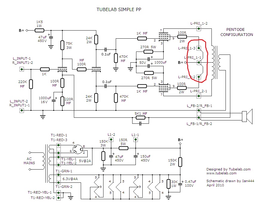

Well, this is the wiring diagram for the Hammond 1650FA OPT:
Each channel on the SPP has 3 sets of terminals for the OPTs. So for example, from left to right along the back of PCB:

Please note that L_FB and R_FB are mirrored! Also note that if you do decide to use feedback (by installing C101/201), you may need to swap the PRI_1 and PRI_2 secondary connections on each channel to get the right phasing (leave the red wire where it is). I can't remember if I had to or not. You'll know if it's wrong if you get loud squealing out of your speakers with feedback connected.

Russ,
For pentode connection, I would have to connect the following points to one another?
PRI_1-3, PRI_1-1, PRI_2-2
