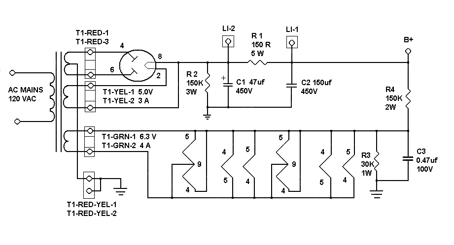

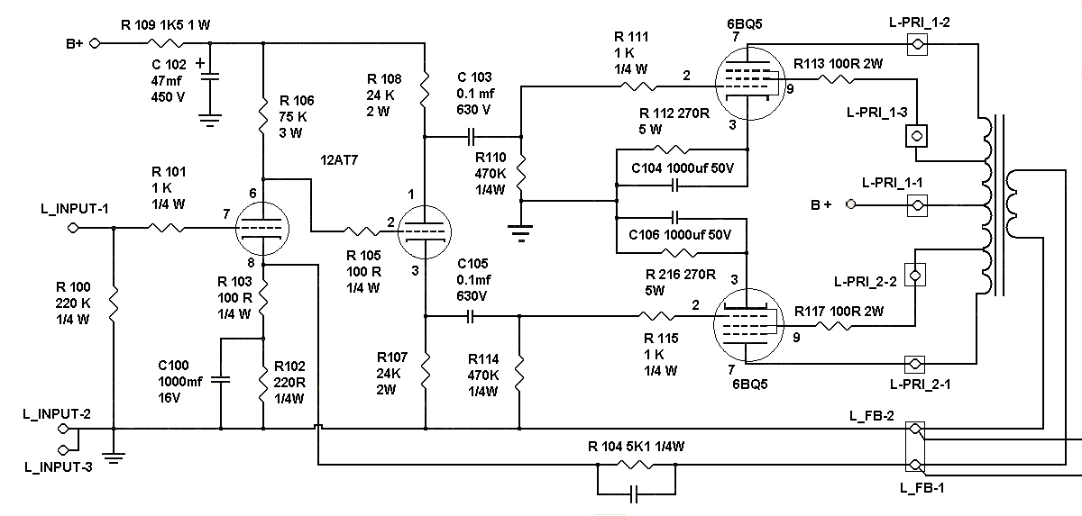

I took the time to re-draw the OFFICIAL schematic and will give you a
copy (GEORGE, IF THIS IS NOT OK WITH YOU, I WILL REMOVE IT). Because I
can make mistake, double check my schematic against the official one.
  • Simple_P-P[1].pdf

I don't know how I overlooked that link on the first page to "Tubes and Applications". I guess I couldn't see the forest for the...................
As for the schematic, Ian did a pretty good job on that thing. Its real easy to follow.
