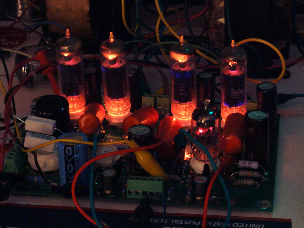

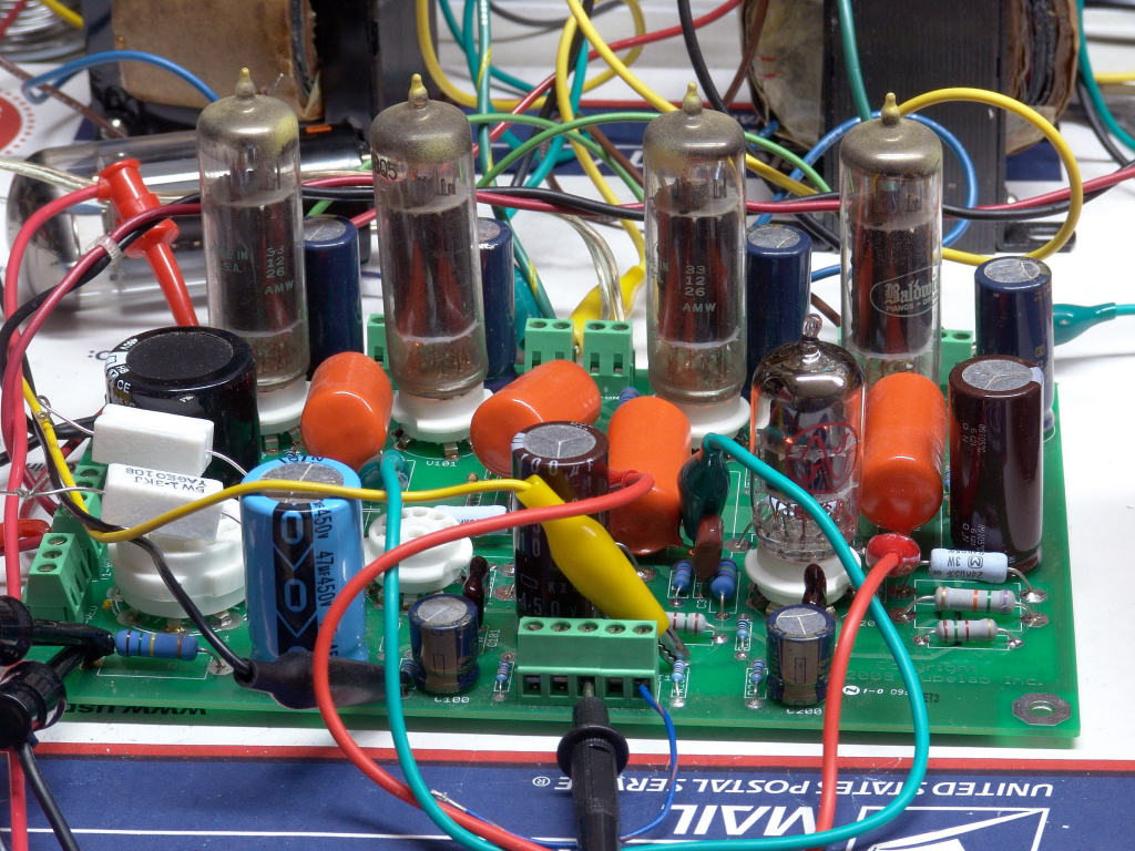

I parted out the amplifier from an old Baldwin organ last weekend. I saved the iron and the tubes. The organ was bought new by a church in 1962. It was used until it was deemed beyond economical repair. The amp was removed and used as a PA system. It was replaced by a solid state amp about 2 years ago and given to me. So this amp was used for at least 3 hours a week for 45 years. It contained 8 6BQ5 tubes and 7 were the original Baldwin branded Sylvanias.
Today I decided to see if there was any life left in those old tubes. I plugged them into a Simple P-P board and cranked up the juice. Does 30 WPC at 2% distortion running on 420 volts without exploding sound like there is any life left? I got this idea to run the amp as a single channel mono block using 4 6BQ5's. OK i got 62 watts out of it at 3.7% distortion. I don't have any new tubes that can do this. I guess that the old Sylvanias rock.
The first attempt ended badly for one of the 6CW5's. The screen grid lit up and then the lightning started jumping around inside the tube. The B+ was about 310 volts, too high for a 6CW5. I don't have time to figure it out tonight. It is 11PM here and I gotta be at work by 8.
