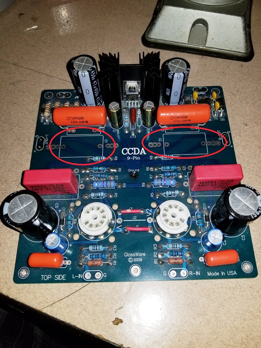

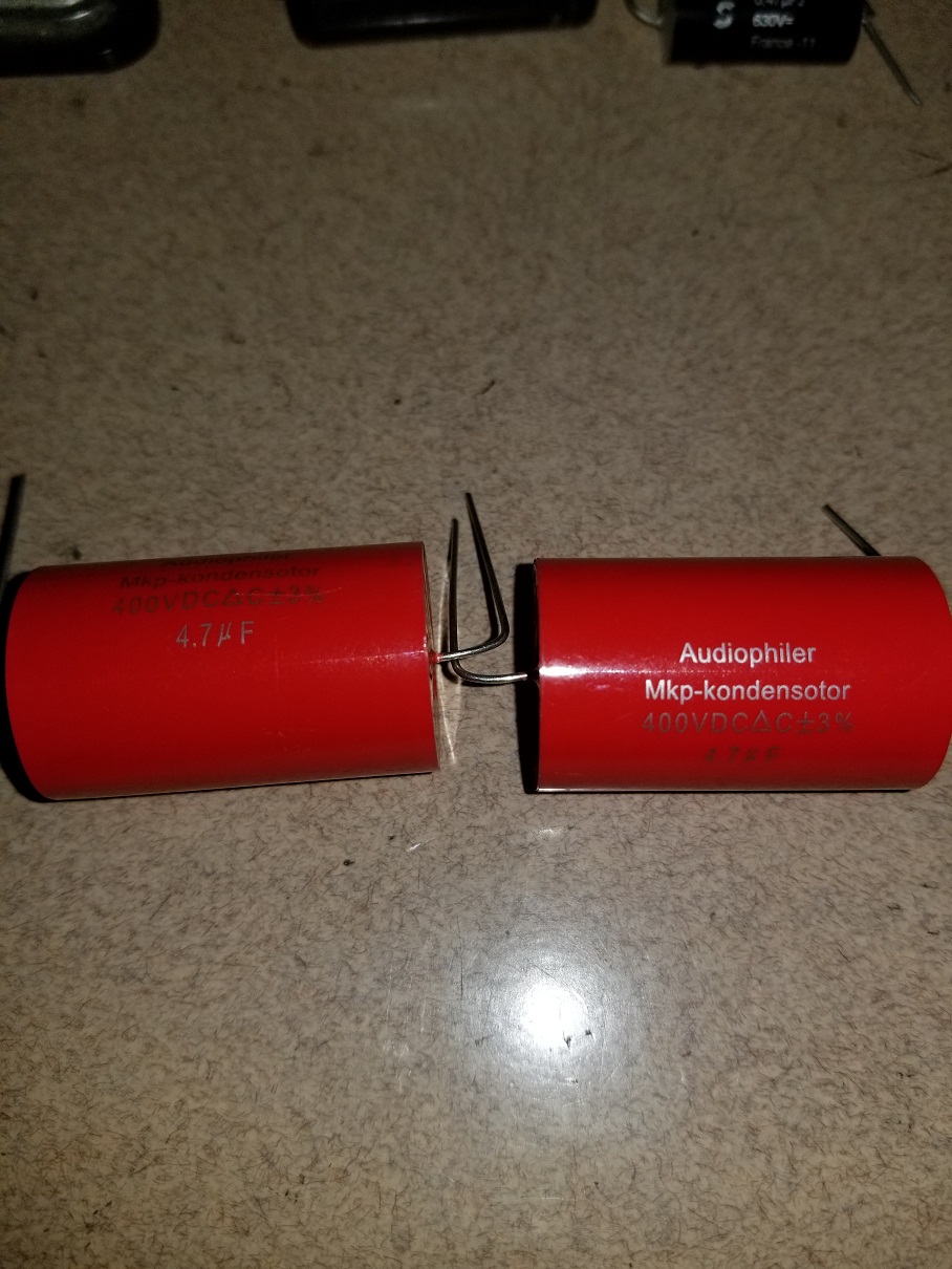

Finally broke out my Tubecad CCDA PCB, after a few years, to use for a project. Already had most of the parts soldered on except C1, the coupling caps. I have a few in the right size, (voltage and capacitance), but soldering and unsoldering various coupling caps could pull up a pad. Would it be a bad idea to solder two, stiff, upright leads to the C1 pads, circled in red, so I can solder on different caps? Or should I just pick a pair and move on.

Would it be a bad idea to solder two, stiff, upright leads to the C1 pads.
Yes, I would use the pieces of wire as tie points for testing. Use pads that you
won't end up using long term, and just cut off the test wires when finished.
I don't think you are going to like most of those capacitors, so you'll probably
want to remove most of them after a short time.
