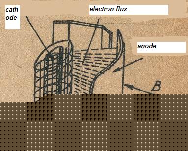

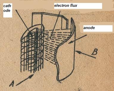

OK,her's the beam tetrode issue:
As you noticed,the geometry of an anode resembles an oval or rectangle.If you look at the attached picture,you'll consider the two axis,A and B.Well,the magnetic field shouldn't be along the A axis,or intersect them in any way,because in this case the hum increases.Alike,the best position of a tetrode is with the B axis and the trannsformer's flux paralleled.
EC8010 said:
The leakage field of a coil (transformer or choke) is strongest along its axis, so if you draw a line from the centre of the coil to your input valve, the coil should be aligned at right angles to this line.
OK,I knew that,but I thought it's some other "snake oil" solution...
We've both learned something here, because although I can instantly see the logic, I had not considered the relative alignment of beam tetrodes and power transformers.
As you noticed,the geometry of an anode resembles an oval or rectangle.If you look at the attached picture,you'll consider the two axis,A and B.Well,the magnetic field shouldn't be along the A axis,or intersect them in any way,because in this case the hum increases.Alike,the best position of a tetrode is with the B axis and the transformer's flux paralleled.
Sorry for the mess,something's wrong with IP!
