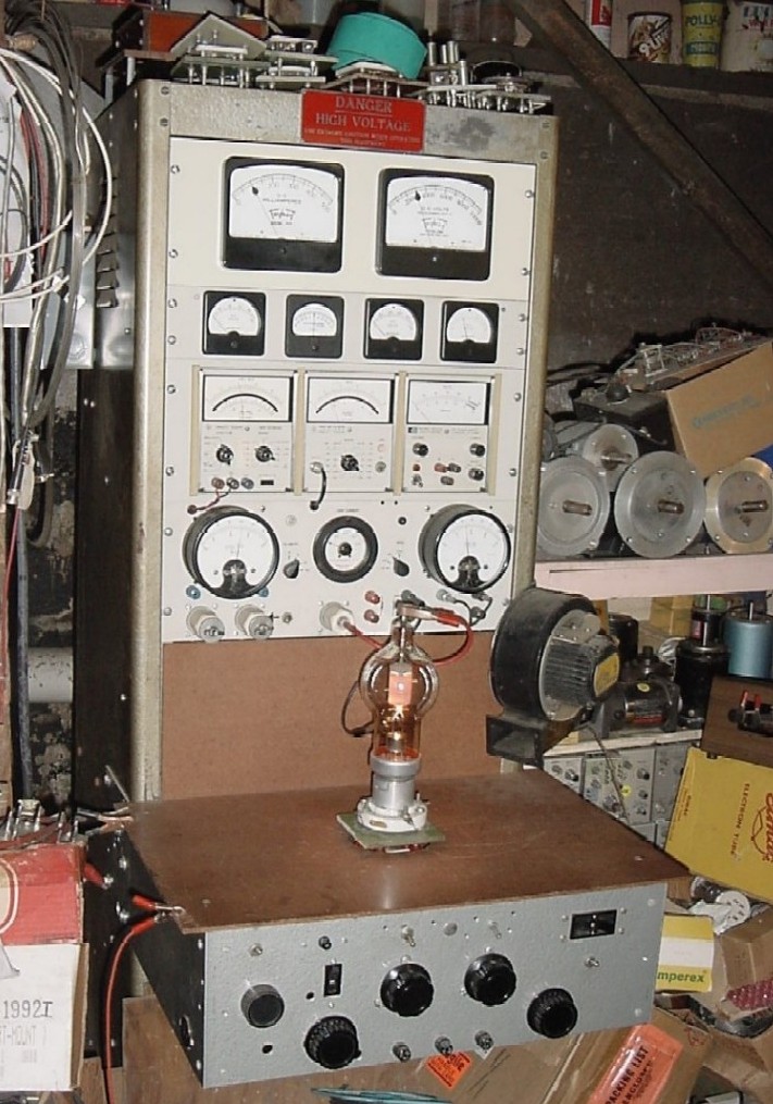

Assuming you mean an Eimac 250TL, filament current is a key factor in testing the quality of a thoriated tungsten filament tube. These types have fairly strict limits on current consumption. For the 250TL it's from 9.7 to 11.2 amps. As the tube ages the filament current rises due to it's chemical composition changing. The test I use for this tube is 2.5KV plate, -120V grid with 100mA plate current. Grid voltage can vary somewhat (10%) to draw 100mA. The acid test is to lower the filament voltage by 10% during test and watch plate current. A strong tube will will not sag, while a weak one will follow downward with the filament loss and act spongy. This is somewhat of a judgment call that requires experience as to how much sag is acceptable. But a true weak tube will be obvious.
Before I built my rack system I had a quick and dirty way to screen out weak tubes from most likely good ones. And this was only for directly heated filament types. I'd make a diode out of a tube by connecting all the elements together. Then, upon lighting the filament, I'd connect it across a 100 volt DC power supply and monitor tube current. A 250TL or TH would draw about 0.45 amps. Then lower the filament by 10% with a variac and watch for current sag (if any) and by how much. This was just a basic DC emission test, but it did follow a more complete class A test although it didn't test for gas or leakage in the tube.
