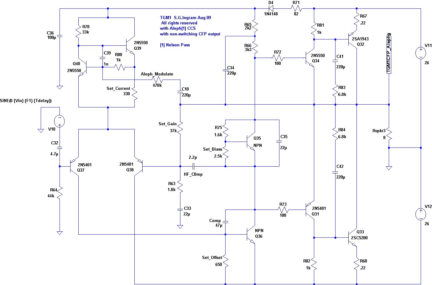

I took the Aleph CCS and put it into the TGM amplifier in the only spot that needs one. See attached schematic (the resolution of the image is bad, but you can see the TGM1 schematic and the Aleph CCS perched at the top of the LTP) .

:smash:Running simulations is easier than building so I took a look a the harmonics from the TGM-Aleph concept amplifier and compared them with the that of a similarly biassed TGM1 amplifier.

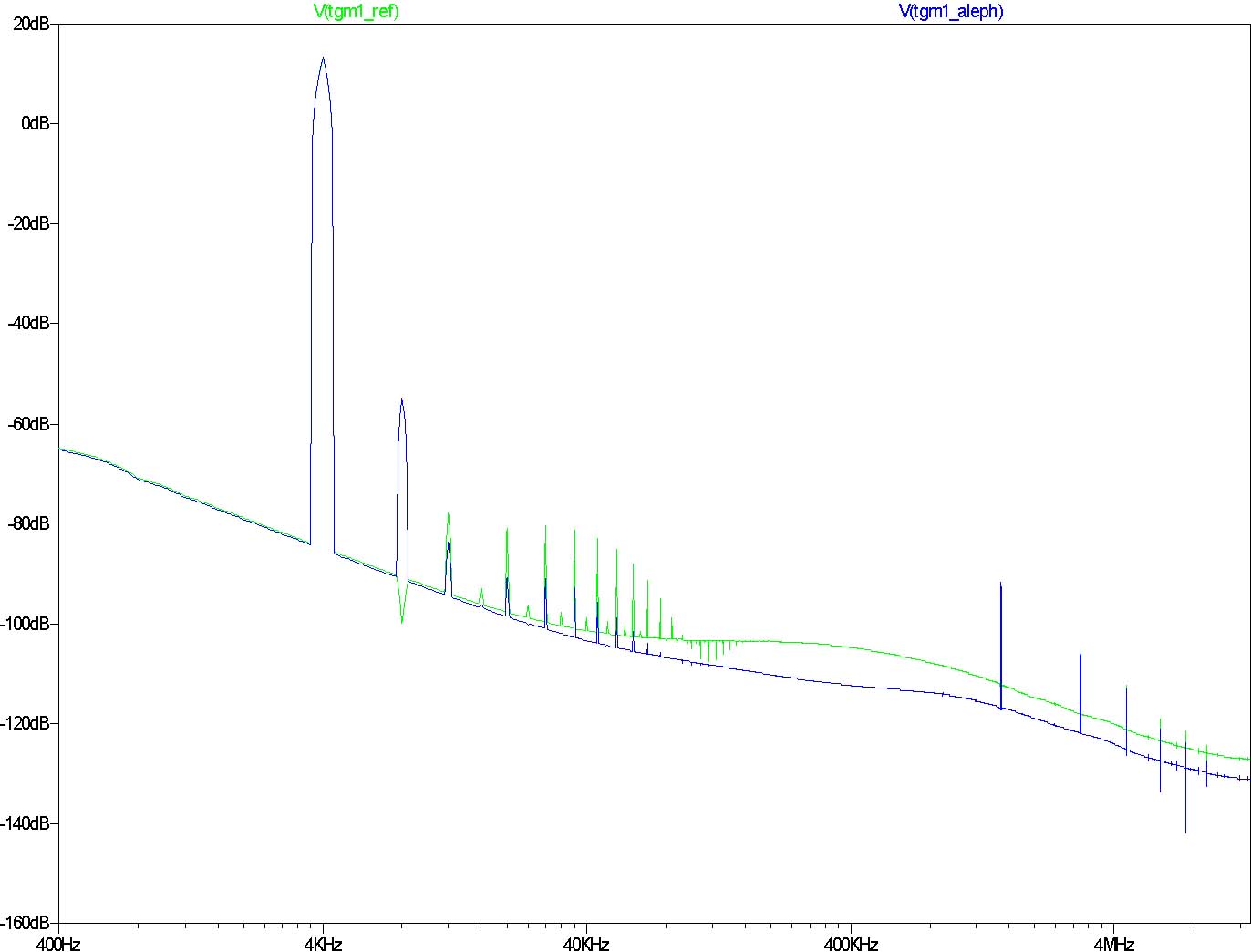

The first image (4kHz) is pretty revealing. The green trace shows the reference TGM amplifier (actually it might be a TGM2, but that's beside the point) with very little H2 since it's a symmetrical ClassAB output, then H3 and a number of higher order harmonics made up from a combination of output switching distortion, IM products and 'ghosts' from the simulation software. The blue trace is the new TGM-Aleph. There's a dominant H2 peak which can tuned in and out at will through a resistor value. Interestingly, the higher order harmonics are reduced in magnitude - this would be expected in the Zen amplifier but quite why I see it here I'm not sure, it may not be real.

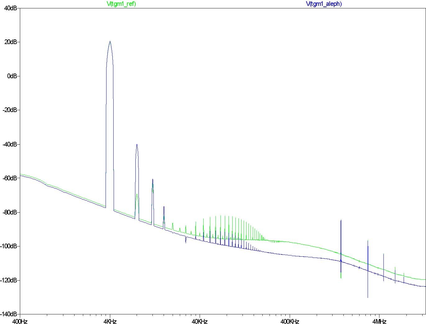

I've looked at higher power levels and it scales very nicely indeed, H2 grows, followed by H3 and H4 with very little else afterwards. This can be seen in the 2nd image. Also 4kHz.

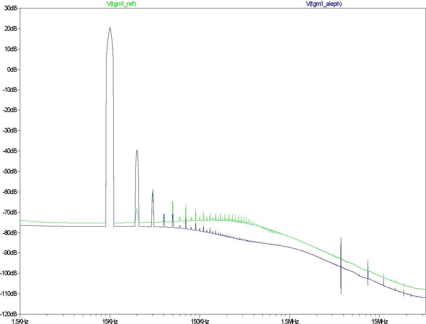

Taking it up to 15kHz the same behaviour is observed: third image.

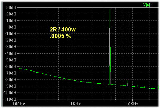

wow , you are trying to ADD distortion ?? I have been trying lately to do the opposite. A factor that many overlook with simulations is the load. I found this out by paralleling another set of speakers on my monster amps to hear the difference. As far as the "tube sound" , try to create that before the amp , like a DAC/tube preamp combo or something similar.
Looking at those FFT's ,(I don't mean to be critical) , but they are horrible.Look at this one (attached) at 4khz /2R - 400 watts.

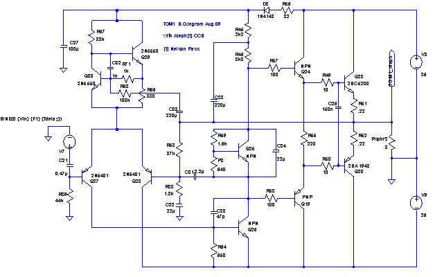

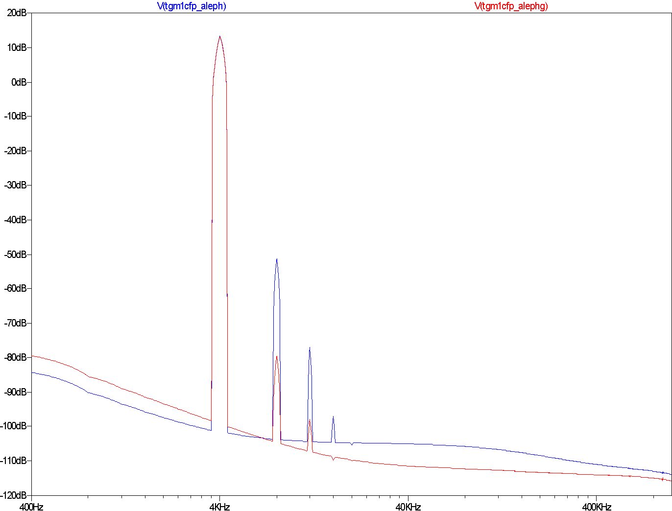

And if I limit myself to the same number of active devices and then reconfigure it with an Aleph CCS and non-switching CFP output I can get a clean distortion profile with 'dialled-in' H2/H3 if I want it.
For example, see attached showing two different levels of Aleph CCS modulation...which look cleaner than yours after the H2/3 :D

But the amp schematic I posted above is not that complex for a ClassAB amp is it. In fact, I think it's pretty economical with parts. It won't be a 'space heater' either.

By gordy - Ostripper, may I ask which amp provided that clean FFT result? Is it Diy-able or a commercial amp?
Yes you may :) , That FFT is just the combo of "symasym - the next generation" and "self type 3 EF (hybrid triple)". Even with a TGM type voltage stage the result is sweet.
The switching distortion (H5/7) of the double EF with suckout cap is frequency and load dependent and might negate any H2 "maniplations" .

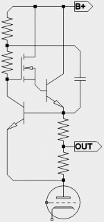

I don't mind the Aleph's gate bootstrap cap, its like a freebie CCS...
But I don't care for the coupling cap. Though Nelson sais his 220uF
is less a problem than non-linear gate capacitance, gate worries me
too...
Anyways, here I direct couple an Aleph through the emitter.
And the split sense resistor, compared to the fixed VBE drop
of one emitter computes all the active current sink magic...
The downside to this, is now your plate is driving the gate of the
mosfet (as if the emitter wasn't there). So you want this gate to
be small and easy to drive. I find a Darlington arrangement drives
friendlier than one huge mosfet.
