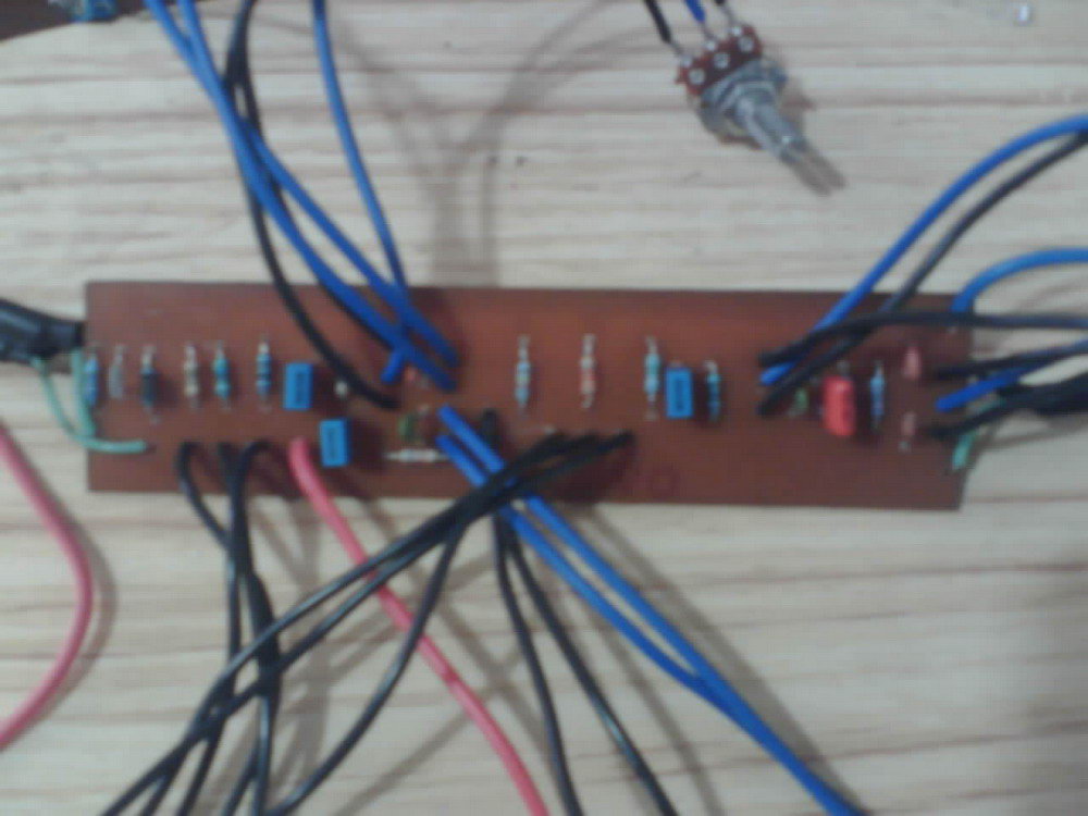

Hi Johan , thnx
yeah i checked wiring and components again and again , i used linear pots cuz there s no log pot here ,,, but still it s not working , in fact the the u-hi switch has a very very small change in output tone too , i donno where s the problem in treble section ...i used regular caps in whole circuit , should i use anything special ?
and yeah i have a signal generator , wat should i do ?
and if it helps here s a pic of my pre amp :
Hi Ahmad,
Now if you were a little bit closer and I could get to you.......
I have a feeling there is something basically the matter since you get little reaction from 2 different parts of your pre-amp.
But first: I presume that "Ultra High" switch is meant for some high treble accentuation (presence?), but it does not do that at all! I simulated your circuit on a computer programme. Firstly, the U-H circuit will be volume control dependent as you are probably aware of. But with the volume control set about half-ways, the treble is +3 dB already at a frequency of 650 Hz, and 8 dB up at 10 KHz. With the volume control further down (15% from 0), the +3 dB point is 400Hz and the response at 10 KHz up by 15 dB. That is not at all "ultra-high", and also quite a substantial treble increase! I would imagine you can do without it at all, but let us at least do things one at a time, and keep that switch off until the rest of the pre-amp is working.
Also then, with the substantial difference that switch should make but does not, may I suggest you first check whether the tubes are working at all, i.e. measure the voltages (with a digital meter if you can). I would place the ECC83 anode voltages at 90V - 150V, with the cathodes at a volt or two. Use the signal generator to determine that you have reasonable gain at all. Do you have a scope?
Further to that you can check the tone control circuit alone, by detaching it from the 2nd ECC83 anode and feeding it directly with your signal generator. (Now you will need a scope.) The treble should give a response between +/- 8 dB or so at 10 KHz.
Two final points, which I should maybe have asked first. You mention only the treble; does the bass control work adequately? Then I see the circuit you use (the first one quoted) feeds out into whatever load you have, without another isolating stage (the circuit giving the values has further stages which I understand you do not use). Be aware that for proper operation of the tone controls the "load" you feed them into must have an impedance of at least 500K or more. (The output impedance of your tone control alone is 140K, which must not be loaded appreciably otherwise the response will suffer.)
This is rather lengthy advice, which you should check first. Do not hesitate to report and come back here - we must get this thing to work!
Regards.

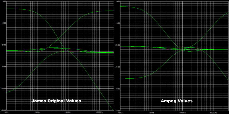

hi Johan and retailer , and thnx for replies ...
unfortunately i don have a scope but thnx for infos johan ,
i downloaded the Duncans tone stack simulator program ( wat a great software ! thnx ) and test a lot w that ..
but suddenly ,i mean i really donno how the treble knob start working ... WITHOUT any changes !!! ... lol , a miracle !
but the very very small changes in treble , in the simulator program , with the ampeg values , it shows more changes than what i here !...
may still have problem ,,,

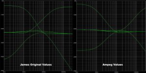

hi Johan ,
yeah , i found diffrent results too, retailer said that he tested the tone control in Duncans tone stack simulator and the treble control do almost nothing , and he said the james original values worked better , but i ran the simulator w ampeg values that i m using , and the results have not much diffrence for ampeg and james values ( i attached the ampeg and original james plot )
but in fact when i m using the the whole preamp , the changes are so small when i m turnin the treble control all the way up or down , unfortunately i couldn t test the circuit w tone generator yet , but i think the changes in treble is limited in very high freqs ( bout 12k or higher if i m not wrong )
i never saw a real ampeg amp to compare my preamp w it , maybe the original ampegs have this small changes in treble too , and the u-hi sw and treble pot are just for cabs w tweeter driver , but with comparin my pre amp w other amps i heared my treble knob is still dead ! , lol

Hi Ahmed,
I think I must first clear up that I have been thinking in terms of the usual hi-fi pre-amp. The Ampeg is obviously for a musical instrument (a guitar?) of which I must embarrassingly admit ignorance, although I once designed such a device for a friend. (I had to do some funny things hi-fi wise, but he was entirely pleased in the end so I presume I was successful.)
Firstly you would see that your second plot is just about the results I obtained. (I must apologise for not being able to present you here with a nice amplitude-frequency plot as you did; my simulator is on another PC.) Thus it would seem that any disagreement is more a question of taste than electronics. That plot is what one normally aims for in a hi-fi- pre-amp, and which I interpret as, well, an acceptable difference for a treble control. The usuall cross-over frequencies are 400 - 500 Hz for bass control and 2-3 KHz for treble, with about +/- 10 dB difference at 10 KHz and slightly more at 40 KHz on the bass side.
If you want more, this circuit will not give it - as said, what you plotted is what it will do. But this can be shifted any way you want by different values or circuits.
To go further, I have also simulated the network round the volume control. With the low-cut, roll-off begins at 106 Hz, and the other switch position provides for a rise below 20 Hz. (Of what use is that? - there is obviously something here I do not know.)
The total amplification superficially guessed will be about 50 - 60, which is not high as such circuits go. There should not be excessive noise, but you need to be careful of external influences. You do not describe the noise - hiss or hum? - but if you tested the built up unit "in the open" as your photo might suggest, you might very well pick up trouble, depending on the surroundings.
To get the same or a larger range of changes with 50K pots, you can scale everything by a factor of 20 - 25, but the required input impedance for the tone circuit then becomes about 5 - 7K, which will mean that you need to feed it with a cathode follower (and a lower rp tube than a 12AX7; 12AT7 or 12AU7), or a semiconductor circuit - if that is not too much of a swear-word!
I would like to help you more if this circuit is not satisfactory for you, but you will then have to mention in greater detail what it is you want. More "aggressive" responses re bass, treble and any form of filter is not difficult, but would then probably involve some sort of feedback circuit, a little more complex than this one.
Hope this helps.
Regards.

I reran the simulation in Multisim 8 using the ampeg circuit values and as I played with it I realised that the ampeg pots were not marked log or lin so I INCORRECTLY assumed that they were linear. Duncans tone stack calc shows log pots for the James tone stack. Running the sim at a treble pot setting of 0% and then 100% gave about a 7db range at 5khz and 16db at 10khz. There is no log option in Multisim for virtual pots (or if it has then I can't find it). Using linear pots gives no treble boost ( if I can call it that) from the 12 o'clock position If you are using log pots and your circuit is wired correctly you should get some treble boost and cut. My son 's first speaker cab was a no name 4x12 It had a response that fell off sharply after about 4 khz so that even though his treble control was working the effect appeared to be minimal.

Refering to Duncan's tone stack simulator
Increasing the value of R4 shifts the operating point of the treble control back towards the low frequency end. I have tried values up to 470k Increasing the value of C3 and decreasing the value of C4 gives a mid boost. I am going to experiment with a 6 position 2 pole rotary switch which will act like a switched mid control. I tried a C3=820p and C4= 1.2n, this give a useful mid boost. Going the opposite way (decreasing the value of C3 and increasing C4) gives a mid scoop. I'll arrange the values on the switch so that position 3 gives a flat response; 4,5, and 6 = mid boost with 1 and 2 = mid scoop. I may still go back to a Fender type tone stack, but since the James type tone stack has a much greater range of adjustment its worth a few dollars woth of componets to investigate.
