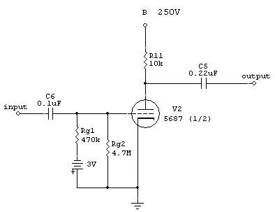

Kuei Yang Wang said:PS, to go on topic, my recommendation for a Line Preamplifier to go with a "Unitygainclone" would be one halve of a 5687, 10K anode load, -2.7V fixed grid bias (3V lithium Cell via 470k to grid, 4M7 to ground), 100nF input coupling capacitor, 220nF output coupling Cap to the 220k input resistor, +B 250V.
Could you post a schematic, please? Thanks.

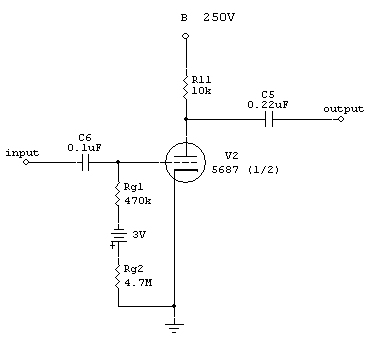

Koinichiwa,
Almost. Remove the 4M7 (4.7 Megaohm) resistor from the ground connection of the battery and place it from the Grid to ground.
The rest is fine. If you want to drive a load other than 220k from this circuit the output coupling capacitor needs to be increased in value.

JAZZ2250 said:Maybe like this?
Sayonara

Kombangwa,
I hope the following is correct.
BTW, how can I calculate the coupling capacitor value? In my case, I replaced 220k resistors with 47k's.

Koinichiwa,
Wrong on both accounts.
The 4M7 resistor makes sure that the grid voltage is -2.7V and not -3V (and yes, the difference is audible).
As for the Output impedance, the 5687 operated as shown here has around 2300 Ohm anode impedance. With the Anode Load resistor in parallel the effective output impedance will be around 1k8.
That is not terribly low but just fine to drive sensible loads (10k//1nF is just fine with a -3db point at around 80KHz) if the coupling capacitor is sufficiently sized.
For simplicity, Capacitance in uF = 50 / Load (Kohm), use nearest preferred value.

Kuei Yang Wang said:...The 4M7 resistor makes sure that the grid voltage is -2.7V and not -3V (and yes, the difference is audible).
If a .3V difference is audible to you, then where are you going to find a battery that delivers exactly 3V, and over its useful lifespan? Shouldn't there be a mechanism to adjust for drift?

Koinichiwa,
The Lithium Button Cells I have used in several circuits like this show in essence shelf life (being discharged through > 5MOhm. New they measured actually 3.12V and after two years they measured 3.12V. So no drift I could measure.
The 0.3V is audible btw. because the Valves transconductance as operated is around 8mA/V or a 20% shift in operating current and anode voltage, approximatly.
