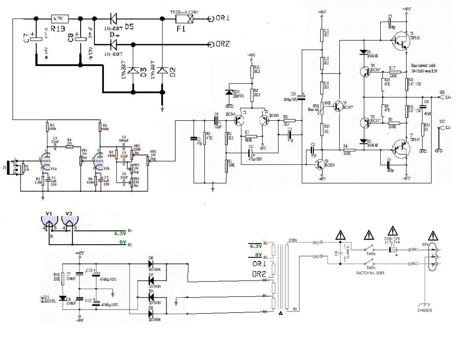

I've been considering this idea myself based on the Marshall VS100 that I have. The power amp stage of that failed and I managed to rig a Velleman K8060 power amp into the place of the failed Marshall unit. It works but is messy. Thinking I would like to make a cut-down version of the VS100, I have been pondering the building of my own tube pre/SS power Amp. I have just cut and pasted various parts of the circuits of the VS100, K8060 and Ampmaker SE5 that I built last year together and wonder if anyone with more experience than me (shouldn't be hard to find!) could pass an eye over it. I know it's not going to sound that good from the price of it and any suggestions for easy/V-cheap improvements would be gladly received. Mainly I just would like to know, Is it just going to go BANG and take me with it or does this look like it might work?

The reason for sticking with the components I have mentioned is that:
A, I have them all
B, The marshall transformer gives me 6 volts for the heaters, 35 volts + and - for the SS amp cicuit and 190 volts for the valve.
I am trying to produce a better circuit diagram with more/clearer value data on it. I don't need 200w of output and hope that by not overdriving the SS amp, I can avoid adding SS distortion just a little something from the valve. The SE5a I built sounds sweet but is not quite loud enough for the gigs I play. And I do like to tinker

So, are we saying that I should put 2 tubes in the pre-amp to get my tube amp sound? The SS amp circuit is 200w rms but I only want volume levels equivalent to about 30 to 40 watts SS (like my sons Marshall MG30DFX). So that fits with Printer2s suggestion that I need more SS power to equate to Tube power (My 5w tube amp has a similar volume output to my Vox supertwin 20w SS amp). As I said in my first post, I don't expect this to sound great, but maybe it can with a bit of thought? If anyone is interested in making this work rather than debating the merits/demerits of the principal, do come on board. below are links to the circuits I am using as a starting point and my first draught design.
1. Marshal VS100 tube HT circuit, top right corner. http://www.drtube.com/schematics/marshall/v100-60-02.pdf
2. Marshal VS100 power supply, lower right corner. http://www.drtube.com/schematics/marshall/v100-61-02.pdf
3. SE5a tube amp pre-amp circuit. http://www.ampmaker.com/images/ak01kit/ak01sc2.jpg
4. Velleman K8060 SS poweramp stage
http://www.sayalhobbies.com/images_d/K8060D.gif
5. My design. see thumb nail on thread item #6

No, actually I was saying you might only need a bit more power and to keep the amp out of clipping. Say you take your 5W tube amp and run it to its sweet spot. Take the signal off the output and feed it into a SS amp and you would get appreciatively more output coming off a higher rated SS amp given that the ratings are accurate and you are driving the same speaker.
I would get a transformer something like this and run one of the 120V windings as input power and the other as the high voltage winding and then use a voltage doubler on it. You could probably find a lower VA rating one to use that is cheaper.
229C12 - Hammond - datasheet
Or you could use a back to back transformer arrangement to step up the voltage from your amplifier power transformer.
I would consider something like this.
The Free Information Society - Marshall 2204 Preamp Electronic Circuit Schematic
OK, So, the marshall preamp schem looks like two valves in series? I'm up for that. The transformer part is giving me trouble, we have 240 volts in the UK for a start, or am I using the Valve HT feed like the output tran for the SE5a? then feed the SS amp instead of a speaker?
Sorry, forgot you already had a HV winding.. Just rectify it and use it as is. The reason I suggest the two valve circuit is that preamp distortion with a couple more gain stages is suppose to be more pleasing than getting it all in one stage.
Printer2, did you look at my schematic on post #6? with a 2 valve preamp, will I need to run the output through an output transformer before feeding the SS amp or can I feed it through a volume pot into the SS amp. this would let me reduce the input into the SS to reduce transistor clipping. I'm still lost as to what your plan was for the hammond bobbin.
