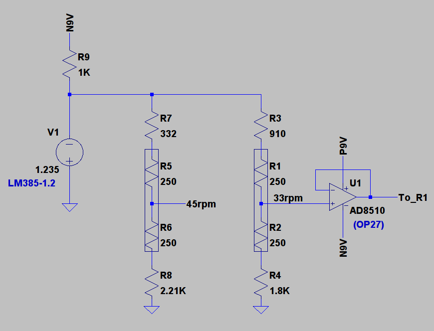

Reference suly
The voltages I quoted are for the supplies.. You will need a separate reference which could very easily be derived from one of the supplies, I'd recommend an LM385-1.2V reference, a 10T pot for each speed, and a switch to select speed. The LM385 is a shunt reference and can be run off of the 9V supply using a series resistor..
Hello! should the LM385-1.2v reference have a negative (-9v) supply. My controler works but have reversed polarity where the motor is connected.
Thanks, Kenneth
