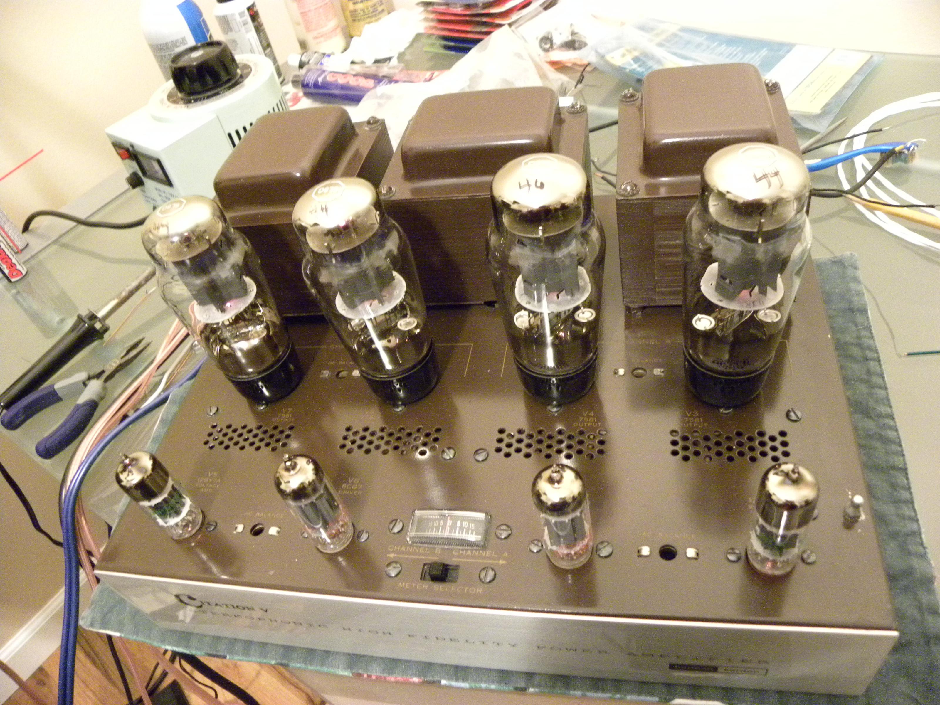

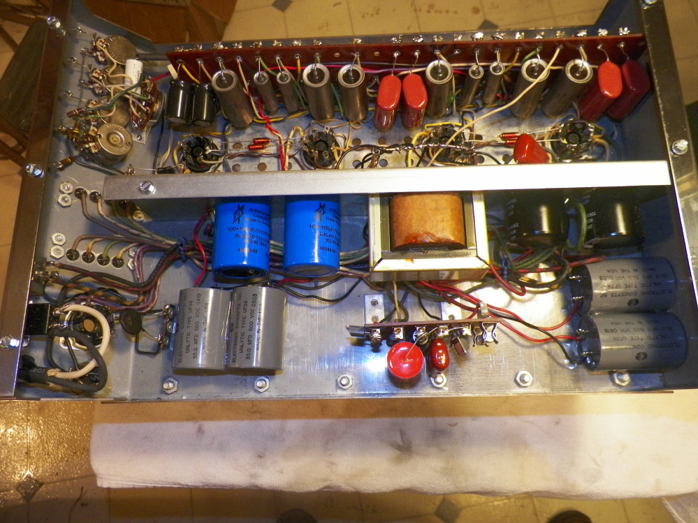

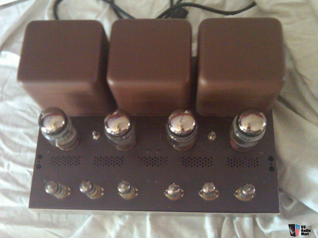

I have the CLXs which are the larger 2 panel ones and I am using a pair of McShaned Citation 2s in parallel to drive them from 55hz on up.The Martin Logan pair of Descent subs are handling everything down to 17hz. In your case,I'm not sure which logans you have but I redid a citation 2 for a guy 4 months ago and he is running it on a pair of Summits and loves it..I added some film caps for added decoupling as well..One amp can drive my big logans but being mine go lower I like to run two..Since your speaker panels are probably crossing over at 270hz or 370hz,a rebuilt Citation 2 would be marvelous on your speakers.
Now,the Mc240 or a Citation 5,both with the McShane type upgrades will be more than sufficient but more than that,the Citations and the Macs are ideal for ESLs because they are ultra wide bandwidth and low distortion,the two things ESLs really adore.
The Citation 2 was actually designed to drive speakers like the KLH9 and the quad ESL63s which many are doing as we speak.

I would use the 4 ohm tap because it it closer to the 1 ohm impedance
that the speaker can hit at certain frequencies..I parallel my 4 ohm taps to give me two ohms but I'm using a par..Now,you can also use 8 ohm taps and they will sound excellent on the Mac amps or a Cit 2 or Cit..The key to a tube amp doing well on ESLs is to have wide bandwidth,low distortion,and a stout power supply.. I also run my Mac Mc60s and my Mc275 on the Logans with no issues. I also have a couple pair of Altec 1570s done with the Tutay mods and running SV572s giving me 200 watts of triode power from 50hz on up.Without getting exotic,I would look for a Citation 2 or Citation 5 or an Mc240 and do the McShane power supply and signal upgrades and you will be happy as a pig in slop.You also get the bass signal from the tube amp to drive the solid state built in subwoofer amps.
