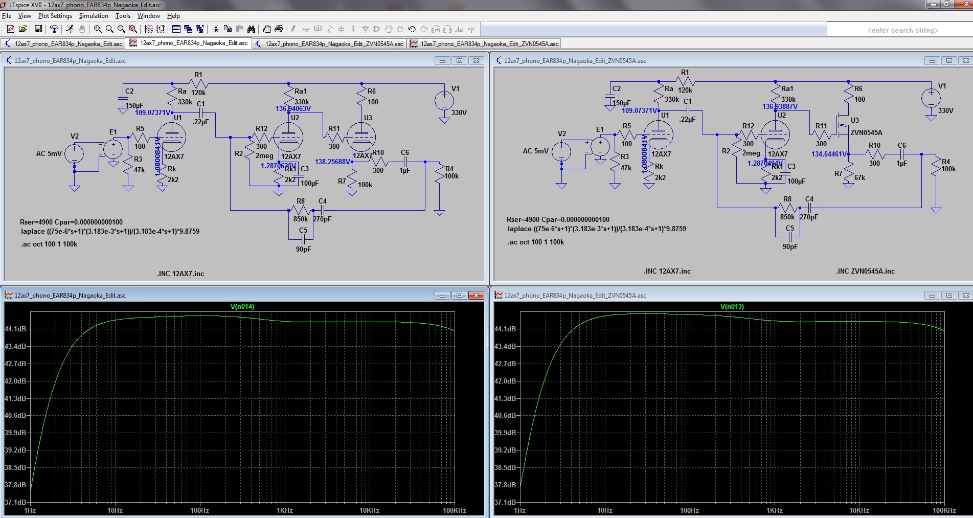

Here' s what I have been kinda working on...
Admittedly, its not as interesting as some of the other circuits posted, but it does the job for the time being and I am very happy with the sound stage. The RIAA appears to model much better than the original circuit, which of course was created in the days before spice. I have tested it using a test record, despite my inability to hear sounds at 15kHz and above.. the 50kHz pole probably makes no difference at all unless you happen to be the dog next door..
Its simulated for my Nagaoka MM cartridge, which has quite a significant internal resistance. Lower internal resistance is not a problem though.
I will probably replace the cathode follower with a ZVN0545A follower, which will likely change some component values... The RIAA caps are standard values Russian military silver mica and the coupling caps are polyprop film.

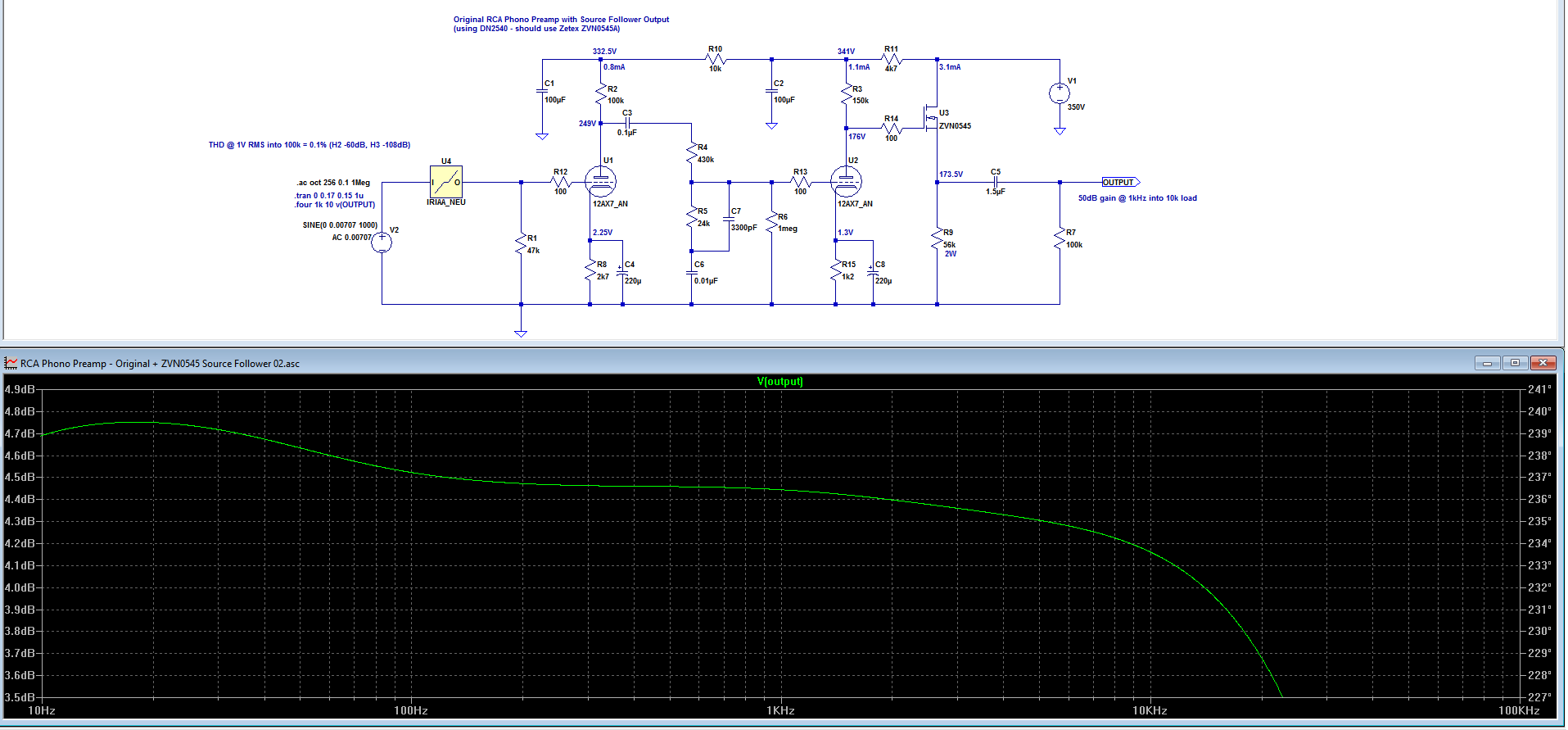

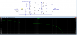

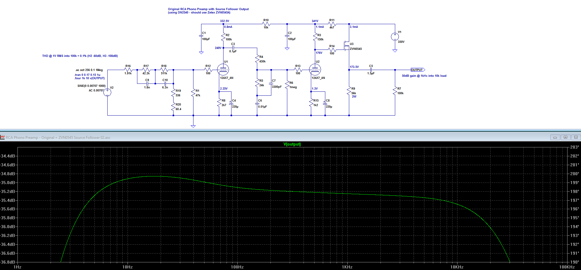

I got a chance to run a little comparison. I've attached two screenshots of a simple 12AX7 phono preamp circuit sim, one with a passive inverse RIAA network and the other with this cool new Laplace inverse RIAA. They don't totally agree on the bass response, but they're very close to each other. Is the Laplace version more accurate?
The accuracy of a passive RC RIAA network depends on the values given and the output impedance of your voltage source. A laplace on the other hand, is a mathematical source.I got a chance to run a little comparison. I've attached two screenshots of a simple 12AX7 phono preamp circuit sim, one with a passive inverse RIAA network and the other with this cool new Laplace inverse RIAA. They don't totally agree on the bass response, but they're very close to each other. Is the Laplace version more accurate?
Here's a passive RC network that takes a 600 ohm (parasitic series resistance) source impedance.
I detect very little difference from it and the laplace on a SE input preamp, except at the high end of the freq spectrum (using the passive) where input capacitance of the circuit under sim comes into play.
When using either passive or laplace set your AC Amplitude=1 for the small signal AC analysis. With AC Amplitude=1 using the laplace you will read your actual circuit gain. With the passive you will read actual circuit gain minus the signal loss of the RC network. Of course you probably knew that.

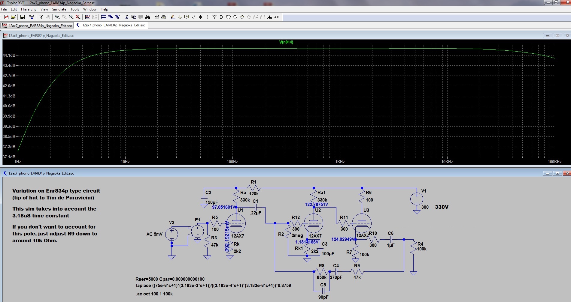

After re-reading section 10.1.2 of Merlin Blencowe's very good book, I have decided it best to do away with the 50kHz pole.
Here are my current iterations on the "ear834p" type circuit with the 3 RIAA cut-off frequencies. Frequency response is very similar with the ZVN0545A MOSFET follower.
Here are my current iterations on the "ear834p" type circuit with the 3 RIAA cut-off frequencies. .
