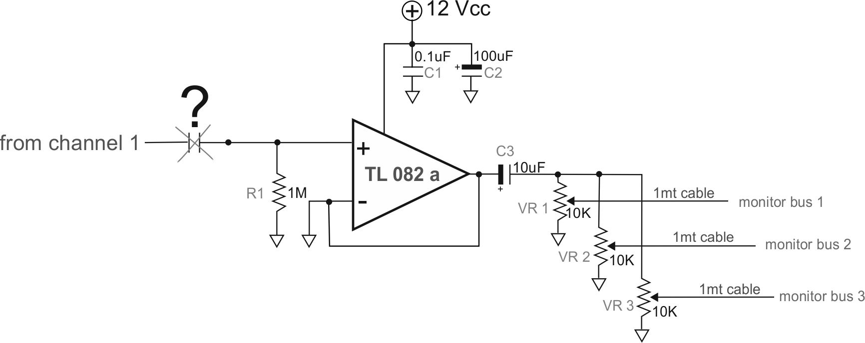

OK, I understand. However, my question was about the monitor (headphone) sends rather than the insert (send/return). On the 'general schematic these (orange lines) are taken after the fader. Is this correct?
You are right, it is wrong … effectively in the schematic you refer the orange lines are taken after the fader but that is not the “general schematic”. This is reported here Mixer - general scheatic | Agorà.

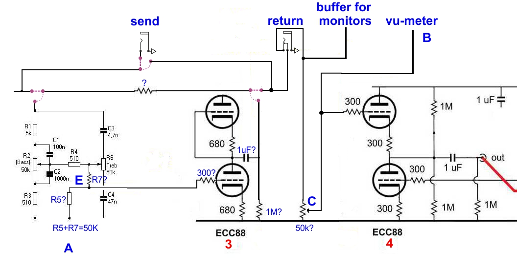

Ian,
we reflected about your suggested schematic and elaborated it. The main elaborated (and, consequently, modified) points were:
1) We substituted the first two Aikido stages (1 and 2 of your schematic … see figure 1) with two SRPP (practically, we simple eliminated the second section of the previous Aikido and added a capacitor of 1uF followed by a 1MR to ground).
2) Stage 3 and 4 of your schematic were substituted with a modified Aikido stage (see figure 1 and 2).
3) A, B, C, D, E in your schematic have been considered and included into our new schematic (see figure 2).
With this approach, we utilize only 4 tubes for channel (as in our previous schematic).
Please take a look at the new schematic and tell us what you think.
Specific questions are:
1) Do the first two stages (now SRPP) followed by the Aikido (at the 3rd-4rd stage) have the some PSRR of the primary two AIKIDO stages (in our previous schematic)?
2) Is it possible to directly connect buffer for monitors and vu-meter to the points reported into the schematic (…without a capacitor)?
3) Are the values proposed for some components (in blue characters followed by a question mark) correct?
4) Objectively … How do you consider our new approach (and in general the whole project)?
Ian,
Probably not. The Aikido PSRR mechanism relies on its two stages being directly coupled to each-other and fed from the identical power supply point.
However, the SRPP PSRR on its own should be at least 20dB and as I mentioned before, with proper power supply design, noise from the power supply should not be a problem.
The buffers-for-monitors point should be OK without a capacitor. However, some modern devices that you might insert here have dc coupled op-amp outputs which sometimes have a small dc offset at the output. This can upset tube biassing or, in this case, cause noise in the 50K pot so I would recommend including a capacitor to be safe.
As far as the vu-meter take off point is concerned there is first another problem that needs to be fixed. The buffer 4 is not properly dc biased. The Aikido second stage needs the top tube grid to sit at half the supply voltage. This is normally achieved by the first Aikido stage but in this case it is missing so you need to do it yourself. The most obvious way to do it would be with a pair of 1M resistors just like in the original Aikido so that this injects power half the power supply noise into the grid. Since the grid now sits at half the supply voltage you will need a capacitor between it and the slider of the pot. If the VU-buffer is also connected to the slider of the pot then it will not need its own coupling capacitor.
The first thing to point out is that the output of the SRPP should now be taken from the cathode of the top triode rather than the anode of the bottom triode in order to provide a low output impedance.
The 1uF capacitor feeding the insert point may be a little low. If the inserted device has an input resistance of 10K then with 1uF the lower -3dB point will be at 16Hz. I would recommend increasing this capacitor to at least 2.2uF or preferably 4.7uF (you can get metal film 4.7uF capacitors without spending a fortune). The same considerations apply to the preceding SRPP when it drives the insert.
The 1Meg from the capacitor to ground is fine. it serves only to allow the capacitor to charge up at power one - its time constant is 1 second which is fine but if you change the capacitor to 4.7uF you should reduce the 1Meg to 220K.
I would make R5 22K and R7 a 33K linear preset potentiometer(with its wiper connected to the 300 ohm resistor to the grid) so you can adjust the filter insertion loss plus ECC88 gain to be exactly unity.
The 300 ohm resistor is just a grid stopper. i would keep it. it needs to be placed as close as possible to the grid pin.
The ? resistor I think should be zero ohms.
What you are proposing is pretty close to what I suggested and you can still use the op amps for the monitor mix as you originally intended and that does save on tubes too. Overall I think you have a firm foundation on which to build.
Cheers
Ian

Provided the output impedance is low relative to the impedances of the tone control network, the exact value of the output impedance should not matter (but see below).
Some questions are:
1) Which is the output impedance of the second (V2) SRPP (with 6DJ8)?
First I have just noticed that the SRPP is being run at half the idle current of the unity gain followers (680 ohm cathode resistor vs. 300 ohms) To maintain the drive capability at the insert point I would recommend increasing the idle current in V2 by changing its cathode resistors to 300 ohms. The output impedance to a first approximation is the same as a cathode follower under the same conditions which, for a 6DJ8 running at 10mA and a 250V supply is theoretically around 100 ohms.
2) Is it appropriate to insert a R-C for each Vcc (in order to decoupling individual power supply? Which values for R and C?
Yes. Aim for a 10V dc drop in the resistor (1k for A 10mA stage) and a capacitor of 100uF should be sufficient.
3) Is it opportune to parallel Vr1 and Vr5 with a little C
(...to compensate for highs loss)?
This should not be necessary.
4) Can the R12 and R13 influence the tone control ? Have R12 and R13 to be eliminated ? If so, which should be value of C4 and C3 ?
They will not influence the tone control.
5) Which value for C3 in order to obtain a 75 Hz low cut?
This is not a good place to put a low cut filter because its operation depends on the load impedance and this is not fixed. A better place to put it would be in series with input to VR1 (50K). For -3dB at 75Hz the capacitor value would be 42.44uF. Note that the potentiometer probably has a 10% tolerance.
6) Is the value of C1, C3, C4, C10, C12, C14 ...correct?
Yes, they all look OK to me but see above about C3 (low cut)
7) Is it correct the modified version of Aikido of V3 and V4?
Yes, the changes look OK to me.
Cheers
Ian
Ian,
thank you again for your support. You are teaching a lot of things. We have also noted that you have a very clinical eye. What do you do in real life?
As to the specific points...
1)
I have never used these transformers but I see from the data sheet that the series connected primary inductance is only 0.5 Henries. With a typical 150 ohm source impedance microphone this means the -3dB point of this transformer will be about 50Hz.
We are worried now about that transformer. We chose the A262A3 because of its low price (17 Euros) and relatively good performance on the data sheet (30Hz-25KHz). Do you have a possible solution for it? ... some suggestions or alternatives ...?
In any case, we have not understood the solution for the 20dB PAD.
2)
Can we put the 1KR and 100uF capacitors on the power supply board ? ... or have we to put them on the preamplifier board, near the tubes?
3)
You are right (always ...:)). We tested the tone control section with 100 ohm output impedance ...and it has the same behaviour.
4)
42.44uF in series to VR1...? ...too big (as dimensions)...and too invasive (on the signal):warped:. What about a second capacitor (e.i., 2.2nF) ... at the end of the circuit (after V4), in alternative (by a shitch) to C14 (1uF)? ... or in alternative to C12 (1uF), after the 50K fader?
5) Where do you suggest to put Vr3? ... on the panel (and so accessible) or into the cabinet (on the preamplifier board ... and so not accessible). In the first case... which name we should utilize to indicate its function?
6) As to all the other points ... Ok.
Ciao
Antonio and Francesco
Ian,
I am an electronic engineer by training but I was lucky enough to retire 10 years ago at the age of 50. I have always been interested in music and recording and made my first professional recording at the age of 14, I also designed custom mixers at Neve in the mid 70s. Since retiring I have spent a lot of time recording my friend and neighbour Bob and we have released 6 albums www.thesongfactory.co.uk
About three years ago I started researching tube mic preamps and now have started designing custom tube consoles Custom Tube Consoles
1) We are worried now about that transformer. We chose that because of its low price (17 Euros) and relatively good performance on the data sheet (30Hz-25KHz). Do you have a possible solution for it? ... some suggestions or alternatives ...?
In Europe the two most popular manufacturers of high quality audio transformer are Sowter and Lundahl
Both make a range of high quality microphone transformers for tube circuits but they are in the 50 to 100 Euro price range.
In any case, we have not understood which solution utilize to add a 20 dB PAD.
This is basically an attenuator that can be switched in. I will draw a sketch and post it later.
2) Can we put the 1KR and 100uF capacitors on the power supply board ? ... or have we to put them near the tubes?
They should be close to the tubes.
4) 42.44uF in series to VR1...? ...too big (as dimensions)...and too invasive (on the signal). What about a second capacitor (e.i., 2.2nF) ... at the end of the circuit (after V4), in alternative (by a shitch) to C14 (1uF)?
Whoops! That was a typing error. It should of course be 42.44nF (nanoFarads). The nearest standard values are 39nF or 47nF.
Cheers
Ian

1)
What about its collocation after the fader (as a switchable alterantive to the actual 1uF)? In this way we can avoid a further capacitor on the signal path (beacuse a capacitor, that of 1 uF, already exists).
2) You forgot to reply to our point 5.
3) As to the vumeter (one for channel), we chose one of the following circuits:
- ELEKTRO LUKIS - Indikátor vybuzení
- VU Meter 3
... because cheap, simple, and occupying a small space on the preamplifier board (... both require only few components).
4) As to the buffer stage for monitors (where we do not think to mantein a very high audio quality) ... what do you think about the attached proposal (it seems simple, few components on the board, and a single supply (12V) ?
Is the input capacitor necessary?
5) When we'll have to bring the line-signals from the preamplifier board to the panel (e.i. potentiometers, switches, etc) which hints do you suggest to avoid signal interference ? We tought to utilize coaxial cables with the copper shield connected only on one side (to the ground star of the preamplifier board) for +ve signal line ... and (obviously) on both sides with +-ve/-ve signals.
