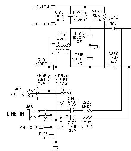

Do you mean 6 to 8k..., or... 6k?
In every application I have ever seen, Phantom power is supplied through precision matched 6.8K resistors. (6.81K is the value I've seen in catalogs -- the important thing is that they are matched to each other so that there is no DC imbalance between + and -)
I believe the caps moamps is referring to are the .1µ caps shown in the balanced XLR part of the schematic, which block the DC from entering the preamp. Depending on the input circuitry of your preamp, they may or may not be needed. Some input transformers can handle the DC -- as Per Lundahl pointed out to me once, "What is important is the NET voltage at the transformer primaries. With perfectly matched phantom resistors, the net voltage will be zero."
Then there's the old Telefunken trick: Use a DPDT switch for the phantom. One pole energizes the phantom resistors, while the other pole inserts a 10µ cap in between the primaries of the input transformer. (Only works if the input transformer has two sets of primaries connected in series.) When the phantom power of off, a wire shorts out the 10µ cap, taking it completely out of circuit.
If the input circuitry isn't exactly known or easily traceable, I'd say stick with the blocking caps to be safe. I do agree with moamps that they should be a higher value, though, and they should be good quality! (They're right at the beginning of the signal path!)
Hope this helps,
-E.
In attached picture is one example of input circuitry in one PA mixer's mono module. Maybe helps too.
Electronaut, thanks for assistance.:)
Milan
