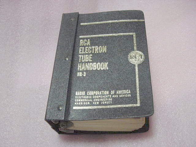

Much more information is available in the RCA HB-3 handbook series. This is a multi volume (5) small loose leaf, but very thick, set that provides more curves and covers receiving, industrial, transmitting, cathode ray and other special types. One such volume is shown below. These have become rare and difficult to find.
