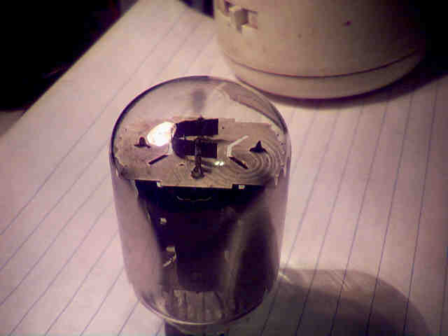

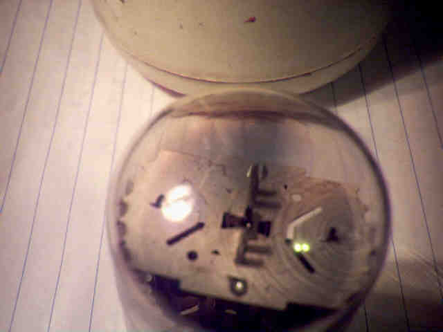

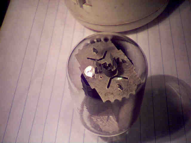

From purchasing a lot of "sale" TV tubes over the years, the WOOS ones have a discoloration/darkeneing on the top of the bulb directly above the filament, if you can see it (getter flash often in the way). I've had pretty good luck with sale tubes though, usually not more than 10% are WOOS. Some places test the tubes, or at least claim to. Some of the obviously WOOS ones do seem to work OK. The second and 3rd picture is of a less abused one, with just a narrow spot, the shape of the filament/cathode end.
