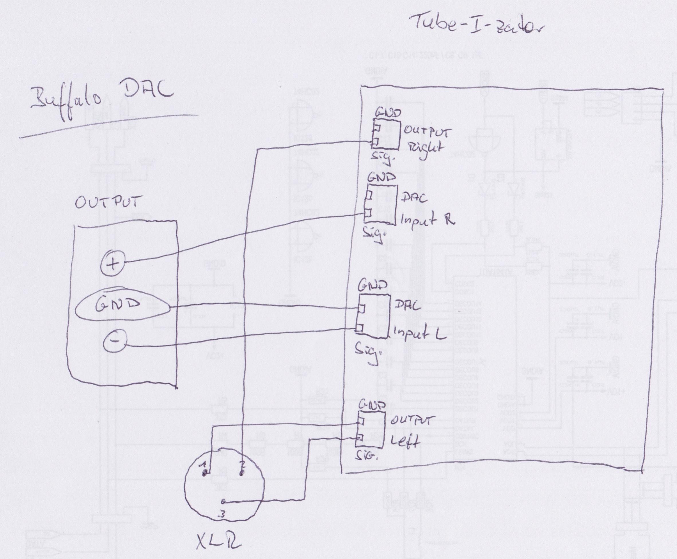

I was hoping somebody might be able to confirm I have the wiring right.
Do I need to connect the central ground point to the case or even to the AC earth point?

Oliver has kindly sold me a couple of the tube-i-zator boards and I've got them working individually just using a single ended output from the dac (basically, for L and R channels connecting the negative line of the balanced output to the gnd and then using negative/ground and positive to connect to the Tube-i-zator input. This sounds great!
Then I tried to connect the one dac board to the two tube-i-zator boards. My idea was that each board would do one channel. On one board, the positive part of the balanced output from the DAC would be connected to the input marked left and the negative part of the balanced circuit would be connected to the right input. The other tube-i-zator board would be used for the other channel.
I wasn't entirely blown away by the sounds quality so I thought I must have connected things up incorrectly. I saw Headrott's dual mono set up here: http://www.polkaudio.com/forums/showthread.php?119264-Fully-balanced-Buffalo-II-DAC-with-Tube-I-zator-tube-output.
It looks like he's taking the different sides of the balanced outputs from different tube-i-zator boards - in other words he's splitting the L and R +/- across the two boards. I'm sure it's not going to do any harm but I'm not sure why. Can anyone explain why? And also tell me if I'm doing it wrong ;-)
My second problem is that I'm having difficulty matching the gain across the two tube-i-zator boards - even when using a matched quad of valves. The mismatch isn't huge but noticeable. I'm wondering whether this might be why Headrott wired it up as he had.
Any help would be most appreciated. I want to stop fiddling (at least for a bit) and listen to some music ;-)))

you could see the balanced connection scheme attached for one channel.
If you are using a matched quad of tubes, identical B+ voltages and 1% tol. (or better) Rk and R i/v resistors, there should be no gain differences!

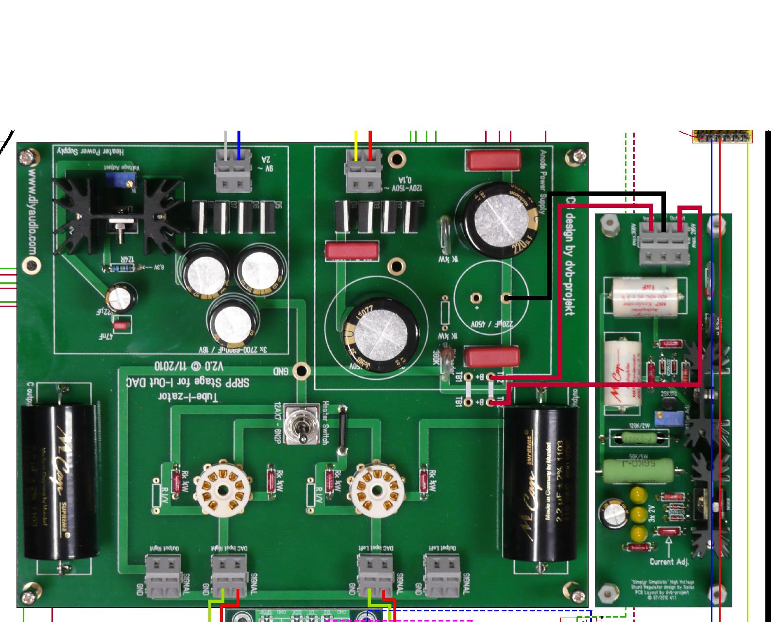

Anyway I have the tubes glowing as you will see, but I have a couple of questions.

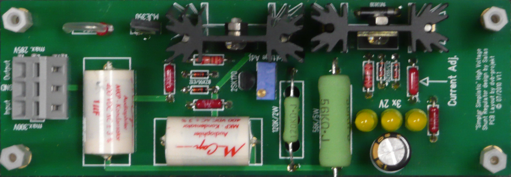

When I adjust the output voltage from the SSHV to 150V as advised the input voltage is 160V, I read somewhere that there was suppose to be a larger difference between the two. The A/C coming from the 150V secondary is actually 154V.
On the SSHV the heat sink closes to the input/output is too hot to touch where the other heat sink is just warm, is this normal?
And lastly is it normal for the heater elements to glow brightly for about a second when you first turn it on?

What is your DC after the rectifier and without the SSHV in place?
Did you have a wire (the yellow one) joining tb1 and tb2 like here?
Otherwise only one tube gets the B+!
I had miss this on your picture here... :eek:
326015d1359016650-tube-i-zator-professional-pcb-13-01-24-dq-dac-2-control-setup-4-part.jpg
No I seem to have forgotten the yellow wire:eek:
I will make changes tonight & report back.
