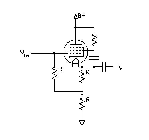

Interesting that it's run as a triode.
It's run as a pentode with equal voltages on plate and screen grid, wired as a cathode follower. Well, suppressor grid tied there too.

No, it's a triode. The screen does not swing with the cathode.
Does screen swing with cathode in cathode biased stage? When I apply a global negative feedback to cathode of the 1'st pentode in my amp, is it triode connected?

In most amps with a pentode input stage (e.g., Dynaco, Mullard 5-20...), the screen is bypassed to the cathode, not to ground.

So in my amps they are what? They are bypassed to ground.
Neither to anode, nor to cathode.
How would you call them?
I think if the g2-cathode voltage swing is approximately equal to the plate-cathode or output signal swing, it's going to follow the triode characteristic.
By contrast, a pentode follower would swing g2 with the cathode, much like a cascode or triode ACF would swing the plate with the cathode. I have a sketch of one of these I'd like to try...

Think of UL, where the screen swing lies between plate and cathode. Is it pentode or triode?
Still the same Steerode, of course!

Screens bypassed to ground with unbypassed cathodes will produce UL behavior. As plate falls, cathode rises, so G2-K voltage falls, but not as much as A-K.
It doesn't matter if the cathode is driven by something else (like NFB) or itself, cathode voltage is cathode voltage.

You know Tim; Steerode sounds better for me than UL. UL is associated with taps in output transformer, while Steerode may be used as a common name that includes UL.
