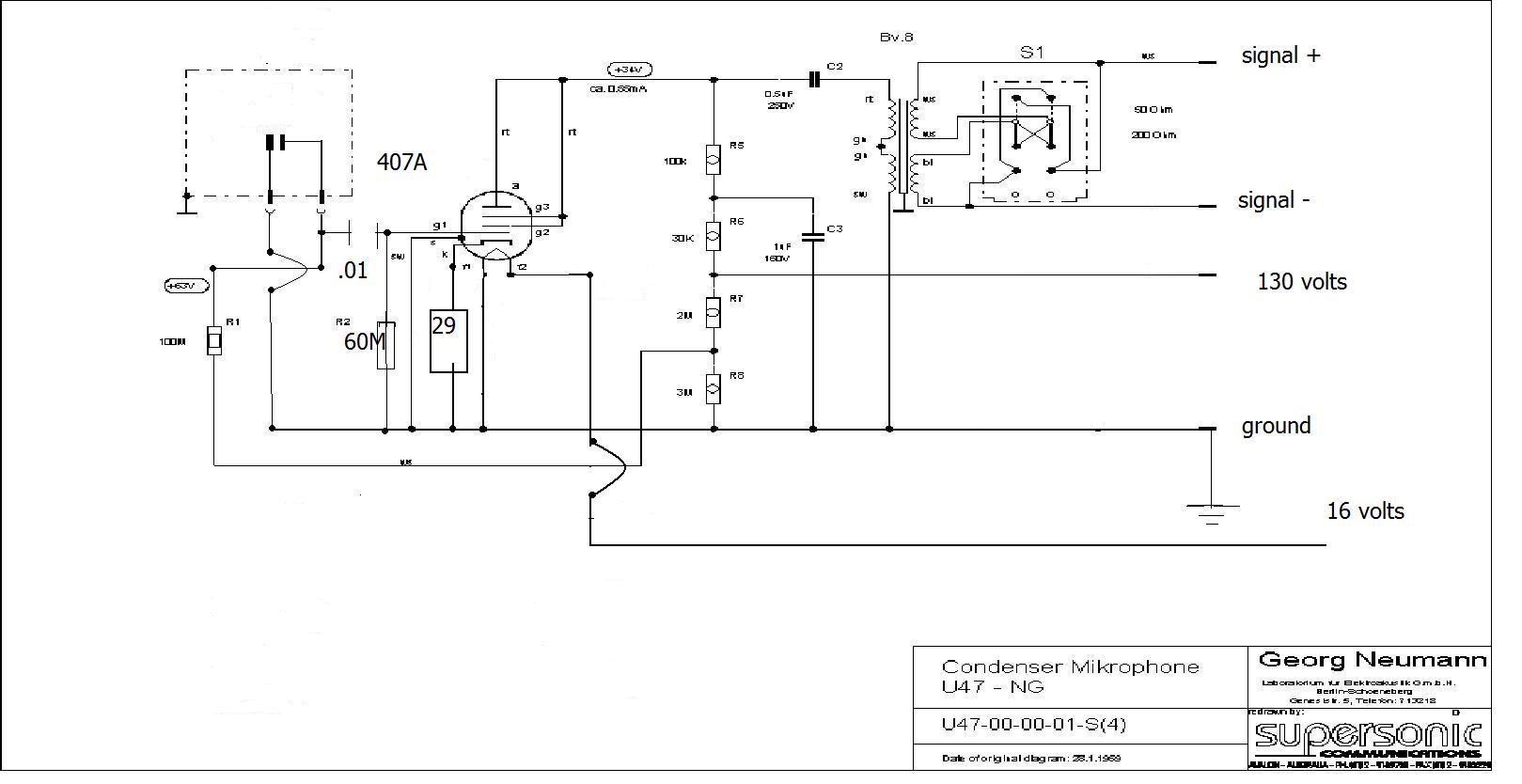

U47 moded

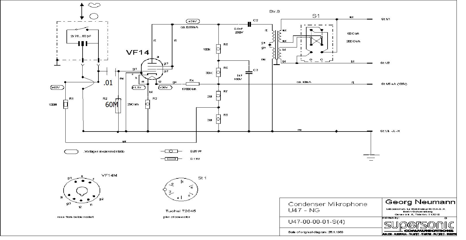

My last question on the subject of 407A is the vf14 looks like it uses 34 volts plate, will the 407 be ok with that?
So its a drop in replacement then?

Chris: I need to look at my notes on the U47 mod. The 407A heater is 40 volts (sections in series using pins 1 and 9) with 50 ma heater current, but the heater is being operated at 36 volts for noise purposes...need to check other values and comments from my notes...The NG supply was a "brute force" supply with the heater and HT drawn off the 105 volt dc. If you are using 130 volts d.c. HT, you will need a 1880 ohm 10 watt (wirewound) resistor for the heater. You will burn open the heater using a 1K resistor!
This mod is not a direct "drop in"...there are some components involved. More later.
Ok will make sure i use that bigger resistor then, I am not sure ive got one in that value however, so i'll see what i can do. Also it should be noted that I have the input in the microphone for a heater already, i could easily up it to 20 volts.
I am not understanding the 34 volts on the plate however, please check out the redrawn schematic for feeding the capsule polarization voltage.
