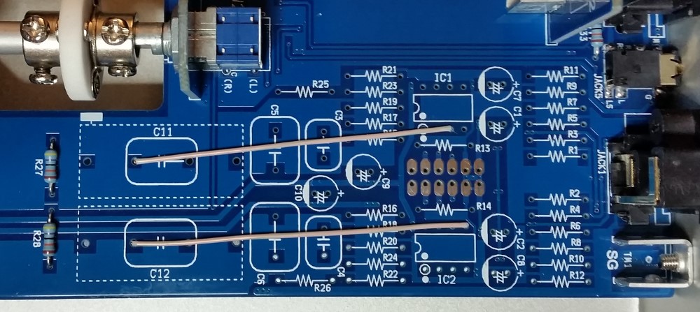

TU-8500 Mod - Convert the Phono In Position to Line4 In
I held off buying the TU-8500 because while I wanted a
preamp I had no use for the phono section of the TU-8500.
Upon studying the circuit I realized I could easily convert
the Phono IN to a standard Input to act as a Line4 IN.
This is not an approved mod so proceed at your own risk.

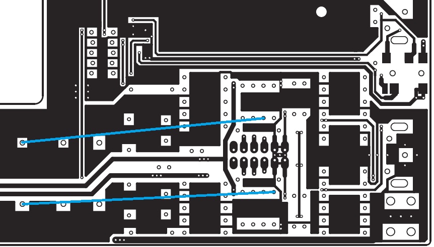

To convert the Phono In Position to a Line4 In
simply Omit the following components during the build:
C1 - C12, R1 - R26, SW1, IC1 & IC2 Including sockets.
Then Insert two jumpers to bypass the omitted section.
Left Channel - From Pin 3 of IC1 to R27 side of C11
Right Chanel - From Pin 5 of IC2 to R28 side of C12
If in the future you desire the phono section then simply
Remove the two jumpers and install the omitted components
See attached Photos for details
