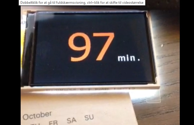

We have made an user interface for an customer with an TFT display. More or less all the software and hardware can be reused for a user interface for an preamp.
I have set Kristian my colleague on the Job changing it to something usefull for an preamp.
The display is 240 x 160 x 24bit.
Let me know if this has any interrest?

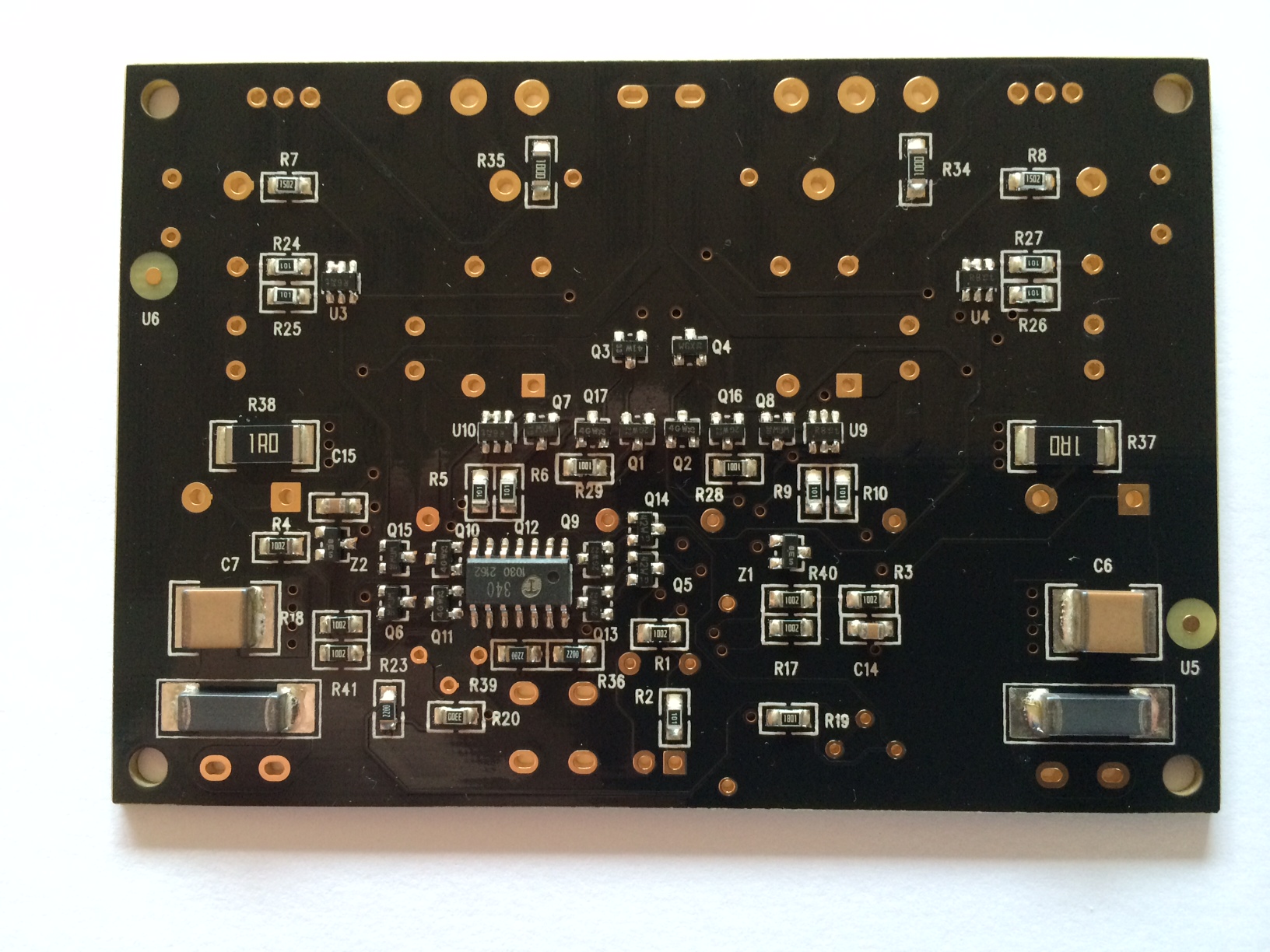

"TSSA V1.7 boards finished, however, we made the mistake with soldermask color, we made them as green soldermask, however, you ordered them as black, if green soldermask acceptable? Or we will arrange remaking and it takes about 6-8 days for remaking."
So we need to add 6 - 8 days. As i want them to be black. They look the best this way.

P.S. What spec SMD resistors you used?
I use standard SMD resistors with 1% tolerance. Even though it performs better than the previous version with metal foil SMD resistors.

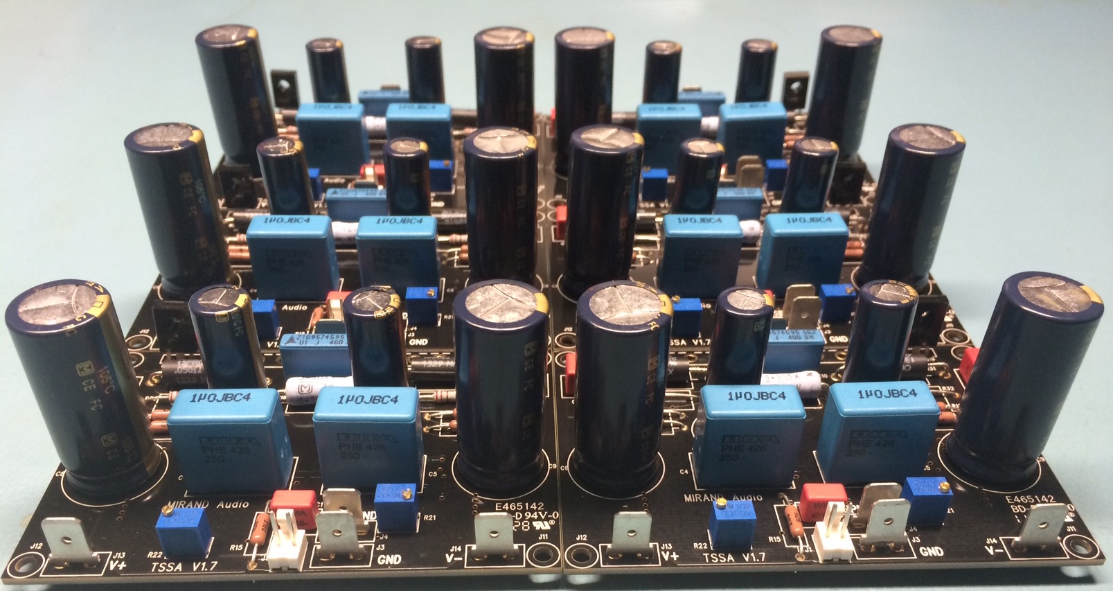

Adjustment procedure can be done under 5 minutes per channel using the 8 steps below.
Armed with an DMM with alligator probes it is fast and straight forward to adjust the amps.
Before adjustment we need to calculate the desired bias current. Formula is U-R30 = Ibias * 0.05 => Ibias = 0.4A => U-R30 = 0.4 * 0.05 = 20mV.
1) Check that the power is connected correctly. V+ to V+, GND to GND, V- to V-, SPEAKER to SPK OUT and SPK GND.
2) Measure across R30.
3) adjust R30 to 10mV using R22 (CW is more bias voltage)
4) Measure across speaker terminals
5) adjust DC offset using R21 on speaker terminals to 0V (Or +/-10mV is okay, but it is pretty much static as it does not fluctuate at all.. )
6) Finally measure across R30 again (The voltage changes with the bias adjustment. But bias adjustment does not move the DC offset more than a few millivolt)
7) Adjust R30 to 20mV (0.4A bias) using R22.
8) recheck DC offset on speaker terminals. If it is within +/10mV then it is fine!
Done!!
As said the bias the very static so there should be no need to recheck it.
