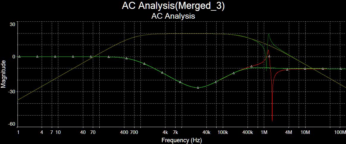

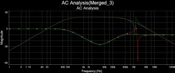

here are results:
the lower lines green & red show the voltage on the caps
the upper lines green & green ! show the current in the nominal 0.1R resistor
You can see how the snubber smooths out the resonanes in the voltage on the caps.
But more significantly the upper plots show how much the current in the rails is also disturbed when unsnubbed & clean when snubbed

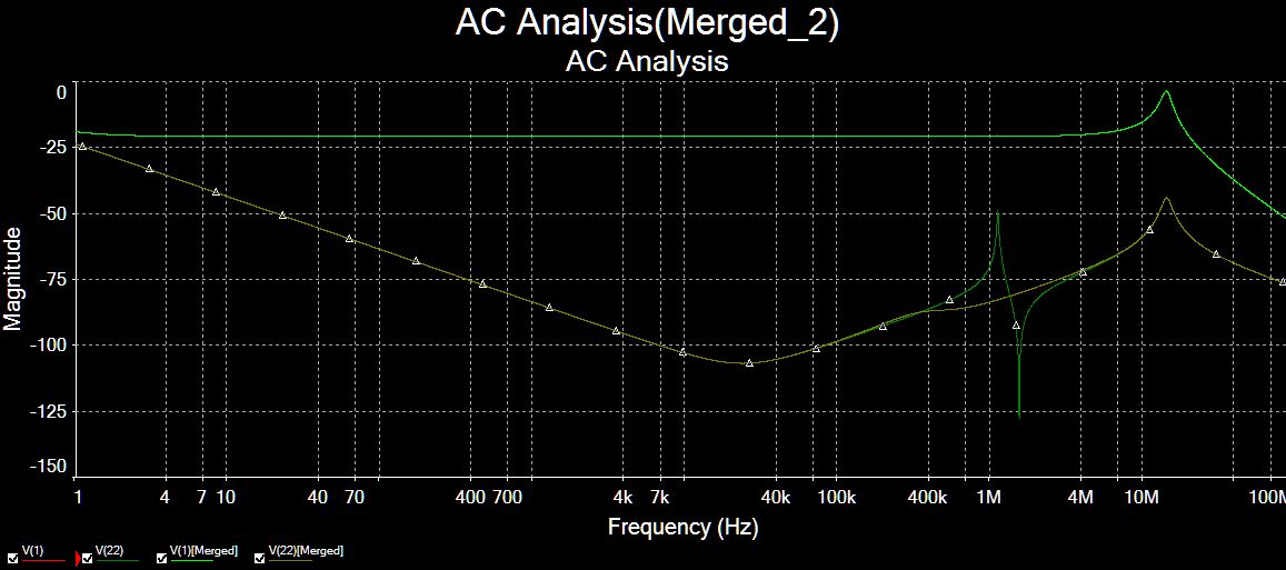

Here are the results from the similar test when I modelled the FB cct with caps.
You can see that the voltages ( below ) are disturbed and cured just as before.
But perhaps significantly the current in this much higher impedance circuit is disturbed very little. Tiny little red blib around 1Mhz - honest it is there but has got lost in the upload
So I think the bypass cap here in the FB circuit will not have anything like kind of an impact on the sound when compared with the bypass power rails.
Technically it will still be a good idea to include a snubber cct ( 0.1R worked well with 4.7uF ) but it might be hard to hear any difference

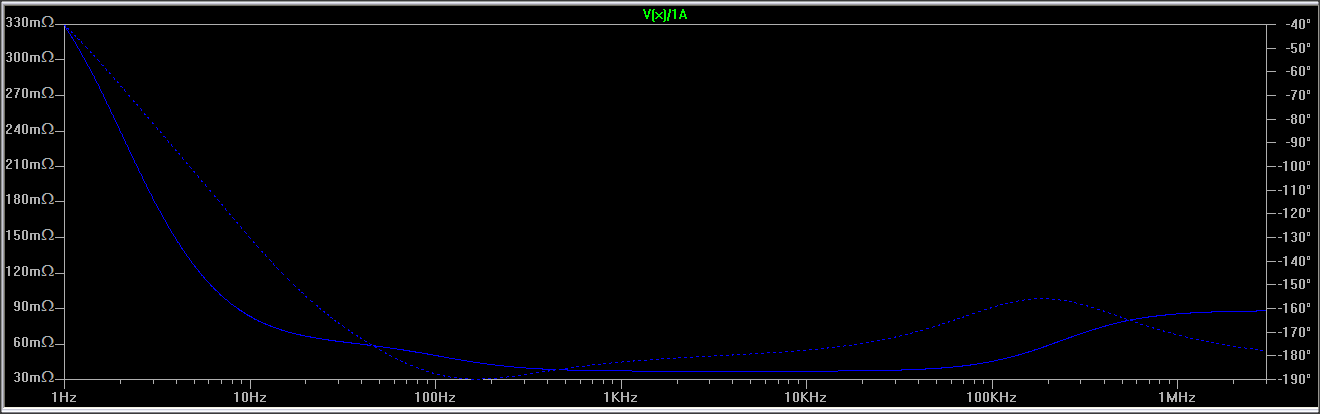

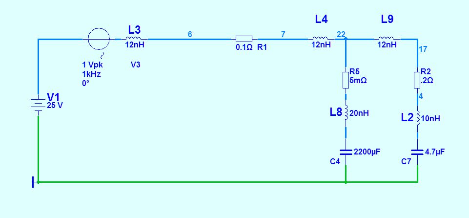

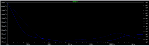

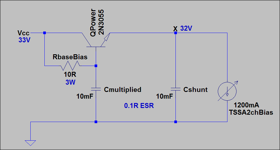

Mikelm thanks for the analytical presentation. Now what happens on the rails decoupling if the power source (PSU) shows the output impedance of a capacitor multiplier that has been proposed as a positive add on? Any adapted recommendation in this case?
I just spent about 4 hours trying to find, calculate, estimate, guess real world values.
It's surprising how few capacitor impedance graphs there are out there.
my presented results were using "guestimates" Now after my excertions my conclusions remain pretty much the same but I think some of the cap inductances guesses were a bit on the optimistic side.
Well, if you use snubbers as suggested on by pass film caps your cap bank should be stable.
If your regulators are also stable - which hopefully should not be difficult with no FB and 10,000uF in parallel then I think it should be OK.
