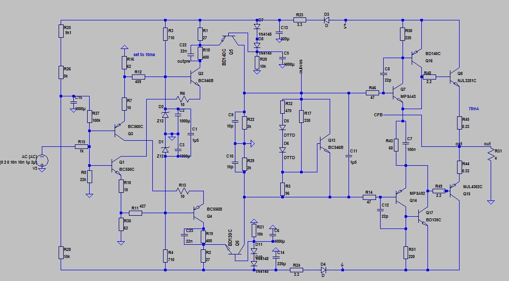

Ok, i have some news.
I will refer to the TSSA V1.5 schematic.
My sim schematic was a bit optimistic with R7 and R8 of value 10K. 2.2K - 3K is a more realistic value.
CCS Q8,Q9 and CCS Q5,Q7 runs at ~7mA.
R23 is 220R.
Q3 and Q4 is shorted. R28 and R29 is 1K.
R32,R33 is 220R to allow less gain reduction through U3 and U4.
R13 and R14 is 100R.
a standard current mirror with BC546B and BC556B (with 100R emitter resistors) was added to the CCS Q12, Q15 and Q13, Q14.
All in all. It is not easy to trim right now, but it works. The amp will produce crossover distortion when driven into clip. but a 1/2 second or so after we get away from clip crossover is gone.
I am satisfied with this. You will hear when the amp is driven to high!! But as soon as you turn the amp down, this will disappear.
Tomorrow i will make the mod for the other channel and listen to them.

Hi Sonny
So now you have four CCS-s sourcing/sinking the inputs to provide current stability against small leakage to/from the output.
The same effect but much, much simpler way is to put Vbe multiplier to mid bridge and set optimal current to ensure DC stability at least to just below clipping conditions, like you did. I think the mid bridge current would be app. the same value as extra current you're sending through inputs. Can you please check also this option? Only three parts to add to feedback bridge, simple as that.
Regards Andrej

I am concerned about the fact that the current in this circuit will rise linear to the -2.3mV/K.
As you can remember I tried NTC in SSA and with serial resistor it could be set to under/over compensation or just to be optimal.
Mid-bridge Vbe multiplier would have quite oposite tempco to the input gain BJT-s so it should compensate them optimally.
I thought as you have TSSA amp functional to be possible to test such trivial circuit. Currently I'm not in a position to test it cause I'm waiting for CSA PCB-s (cannot test without making the whole TSSA basic amp) and it is not thermal compensation which interests me, that will be solved, but rather the sufficient level of mid-bridge current to resist crossover distortions up to the clipping output level.

I can see what you mean about the opposite temp-co.

By the way.: have you tried your SSA with an diamond buffer as frontend? It would be easy to modify. Just to hear what the difference would be in a listening test.
Not manage in a time of R&D, now SSA is working here

How's the sound of TSSA?
With the the current mirrors and 1K gate resistors for the renesas mosfet installed and a idle of 0.7A (Hot but not untouchable).
The sound is now seasoned with salt. It is a bit more detailed.
It does go deep, very deep. There is a lot of detail through the sound stage from bottom to the top. The sound is generally warm. It is not correct but i think most listeners would prefer it that way.
All in all it is an amp you just sits down and listen to. You don't think of trying to find mistakes in the interpretation of the music that is played.
You could find errors no doubt about that. On the weak side is the warmth it adds to the highs but you somehow forgets it as it goes very deep without the loss of precision.
It is a good amp to simple music. if you push the amp pass medium high listening level it starts to get less detailed. My speakers are 87dB so i think it is not bad at all.
