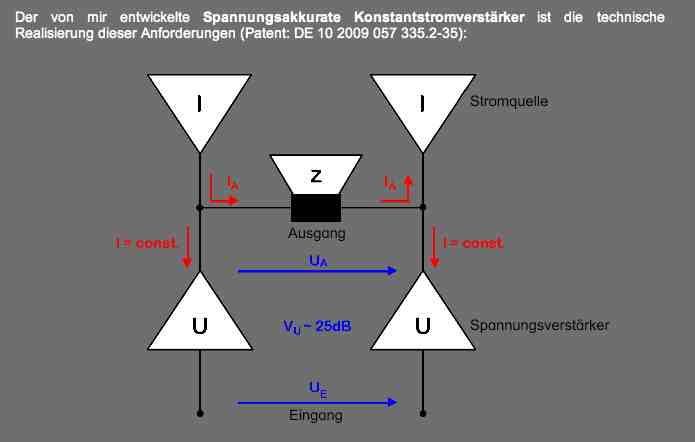

I Can only agree with you Gerhard. It is true that there is infinite number of harmonics in a perfect square wave, but then to draw a line to third harmonics in a sine signal is completely wrong. An amp that reproduce an perfect squarewave does not necessarely only produce third harmonics when reproducing a sine.
Here is the patent number and block diagram.
