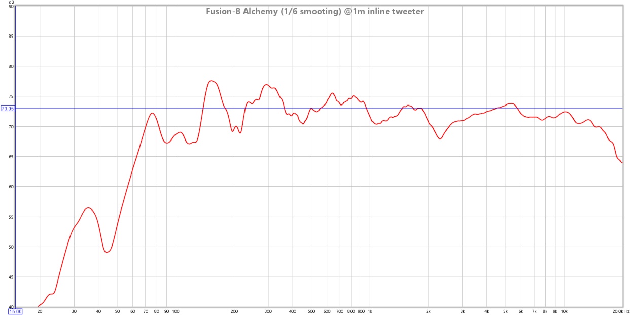

I was looking at Jeff Bagby's Fusion-8 Alchemy. It's a bit more sophisticated than Eminence crossovers, being third order bass around 2.5mH/8uF/1mH, and crossing at about 2.5kHz, well below the Beta 8A's breakup. Second order tweeter with attenuator. It must help to get well away from breakup. I suppose the only way to find out, is to build something.
Funny you should mention that speaker. I've been looking at that as well, because it's affordable. The folks at diysoundgroup told me that they absolutely would need to be used with a subwoofer (or two), since they don't employ much in the way of baffle-step correction, and have a claimed F3 of 65Hz. Here are measurements from one builder:
bsmt-fusion8-1m-on-tweeter-axis-jpg.273
That doesn't look like it would go low enough to be used as a standalone stereo pair.

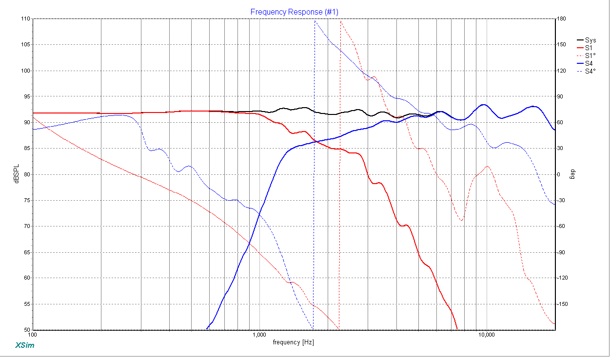

1.8mH and 12uF looks useful to me as a bass filter on a Eminence Legend B102 10":
500057d1440342286-classic-monitor-designs-schematic-png
500058d1440342286-classic-monitor-designs-fr-phase-png
That's what it does with a Mivoc 92dB PA driver used by marco_gea, who is a top man.

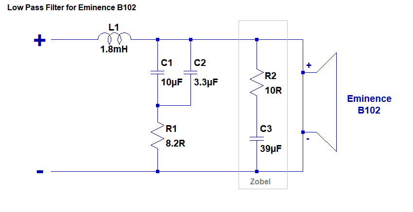

Because I know my way round Zobels, I would guess 60 ohms at 10kHz needs 39uF. I usually sim these things for a flat impedance.
So 10R plus 39uF would be close enough IMO. You'd use that with 1mH for about 2kHz crossover or -6dB point.
But this is not the only way to do this. 1.8mH and a shunt of 8.2 and 12uF would get you to much the same place with a regular less flat impedance and some 2dB of bafflestep and slightly steeper slope on the bass rolloff.

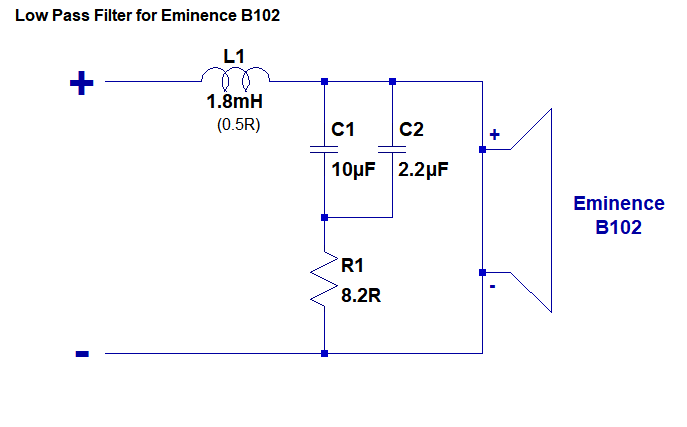

I've got the soldering iron warmed up. Starting in on the LPF for the B102. Just wanted to make sure I'm doing this right. Attached schematic is of the LPF I'm aiming for, correct?
I will have to build up the 13uF caps from a 10uF 100V Panasonic metallized film, a Wima MKT 2.2uF 250V, and some kind of 1uF metallized film something or other.
What happens if C3 is 33uF instead of 39uF? Or would it be better to make it 47uF? I have to see what kind of non-polarized electrolytics I have in my drawers.
Oh, and the 1.8mH inductors' DCR is 0.5 ohm. Does that change anything?

That won't work at all:
697128d1534206142-trying-mellow-klipsch-kg-4-5-tractrix-horn-lpf_eminenceb102_00-png
You don't need a Zobel with the regular 1.8mH series and shunt of 8.2R and 12uF for approx. 2kHz -6dB point. I would call that first order with a bit of impedance correction.
Using a full Zobel is an entirely different ballgame. It works with textbook values from those online calculators: 2-Way Crossover Calculator / Designer
What the Zobel style doesn't do is take care of bafflestep. Resulting in a bass light sound. For that you must add an RL parallel network: Seas ER18RNX with 27TDFC
So I would start here with 1.8mH series, 8.2R and 12uF shunt. It's a good sounding circuit for tidy woofers in the AllenB tune by ear style. None of these values are very critical.
Simple is good -- and certainly for me! I think, though, that I'm not seeing the subtleties. Does this juggling of L vs. C values in what looks like a straightforward 2nd order filter add a bit of baffle-step compensation? Or is that what the 8.2 ohm resistor is doing, in series with the shunt capacitor?
OK, no Zobel. I can build up the 12uF with the 10uF and 2.2uF caps I have.
For the record, the attached schematic is the target now.

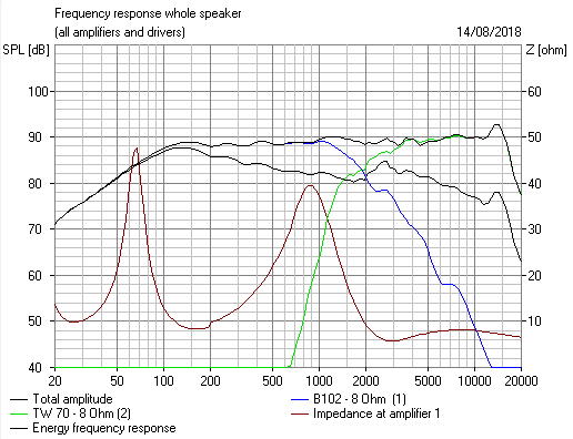

I have amazed myself and got some sort of sim of the B102 working! :cool:
Speaker Detail | Eminence Speaker

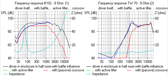

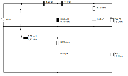

I have really no idea what I am doing with an SPL trace and importing it into Boxsim, but what I am getting is not unreasonable after much fudging. The FR and impedance does look like the Eminence measurement which must be infinite baffle.
The 1.8mH/8.2R+12uF comes out a bit bass light on 2kHz crossover.
I think we need a bigger coil here. Here's what I get for 60L tuned to 25Hz on a 25cm. baffle width, which is a wild guess in itself. I am, of course, waiting for the horn expert to tell us how to do that part.
